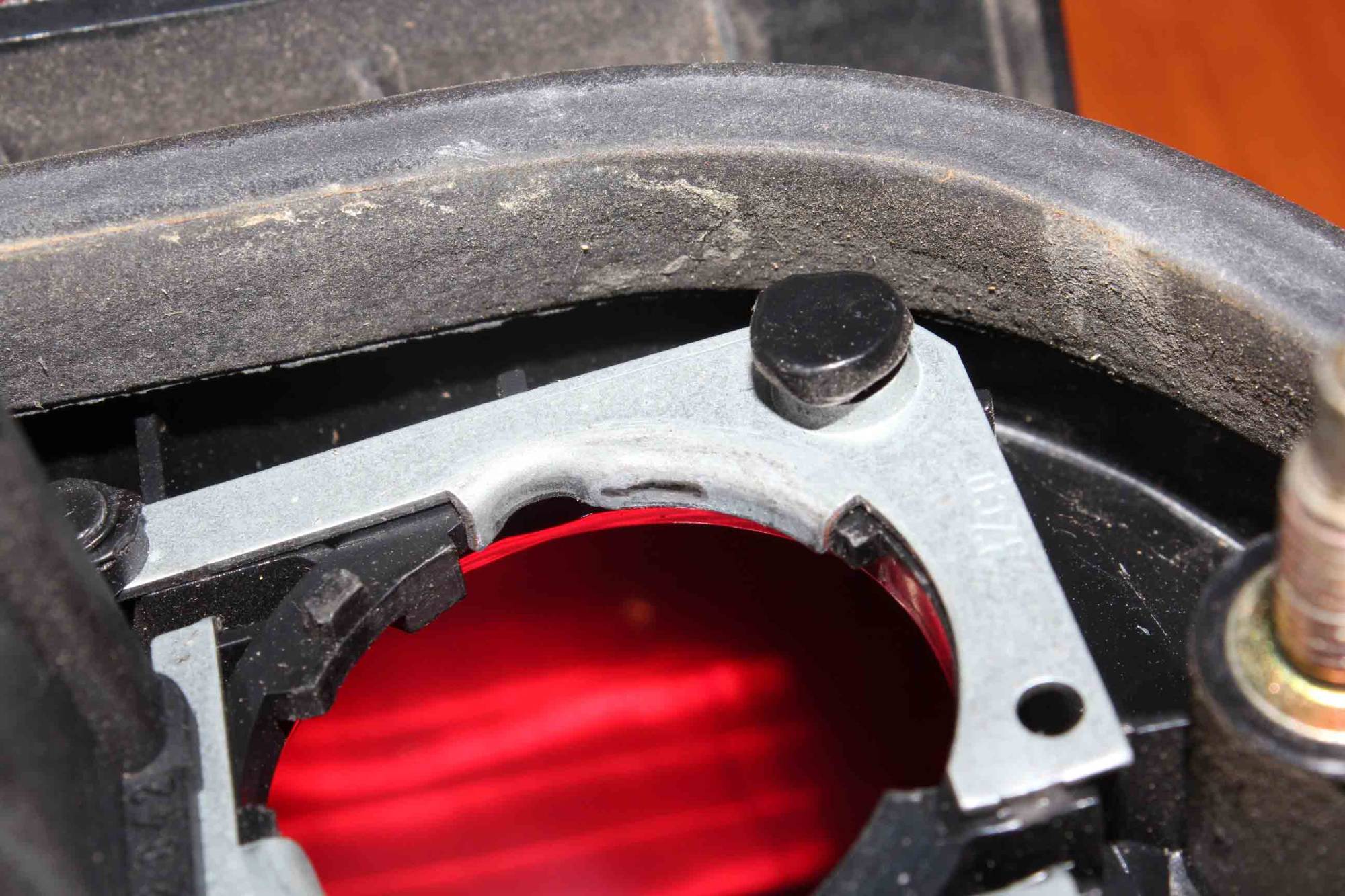

These connectors can actually melt or fail. I have one bulb holder that for some reason will not work. I cleaned it and checked the bulb and it was fine. I had spare connectors from another light unit and swapped it in.
The contact point for the bulb holder can melt through. Hard to see without removing the light unit.
To get full access is a pain, but the only real issue is the plastic U-clips that break when you have to remove the lower trim around the tailgate opening.
Otherwise it is fairly quick to access and remove the light units, but then I have done this many times pulling spare units from the junkyards for others.

The plastic in this rear upper light assembly is in good shape and you can see the metal contact plate and the bulb contact rub area when the light is twisted in place. The plastic holds the metal contact plate in place but what happens is the plastic melts and or breaks from the bulb heat then the metal plate pushes outwards and a poor contact is the result, intermittent light or no light at all. Check the condition of the plastic carefully and push on the metal contact plate or watch it as you twist in the bulb in to see if moves outward from the plastic being damaged.everythingsbroken wrote: ↑31 Dec 2024, 14:54I've pulled it all apart before to replace the gas piston springs in the tailgate, but I think you're right and I'll have to get back in there to see what's up with the connectors. I didn't know they could melt through. One worked beforehand and one was burnt out. But I'll try swapping the shunts around.scot850 wrote: ↑26 Dec 2024, 11:10 These connectors can actually melt or fail. I have one bulb holder that for some reason will not work. I cleaned it and checked the bulb and it was fine. I had spare connectors from another light unit and swapped it in.
