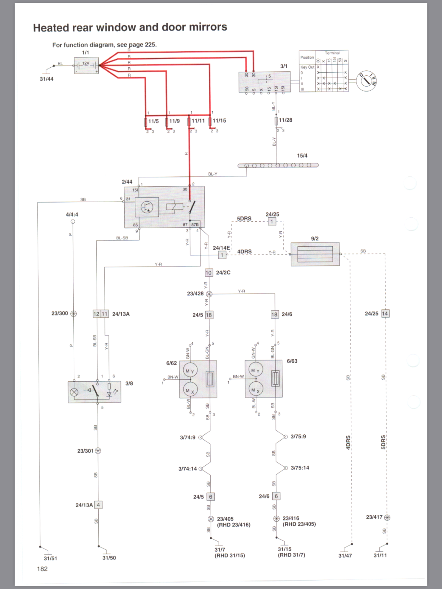

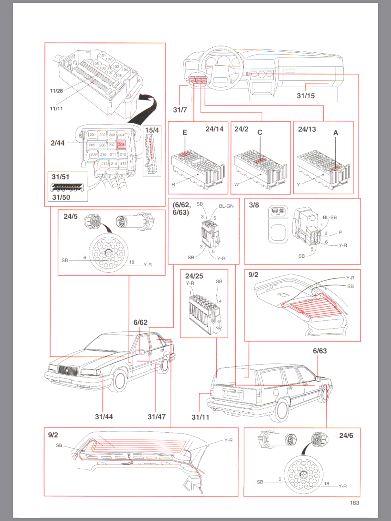

I think that you have several different issues.
The heated seats are on their own circuits
and not a part of the mirror heaters at all.
The mirror heaters and the rear glass heater
both get power from the timed relay 208,
shown as 2/44 in the attached diagram.
It looks like the rear glass is fed from contact 87
of the 208 relay, and the mirror heaters and the
indicator light in the dash switch get their power
from terminal 87B.
When you push the dash button, 3/8, does
the indicator light in that button come one?
from terminal 87B.
