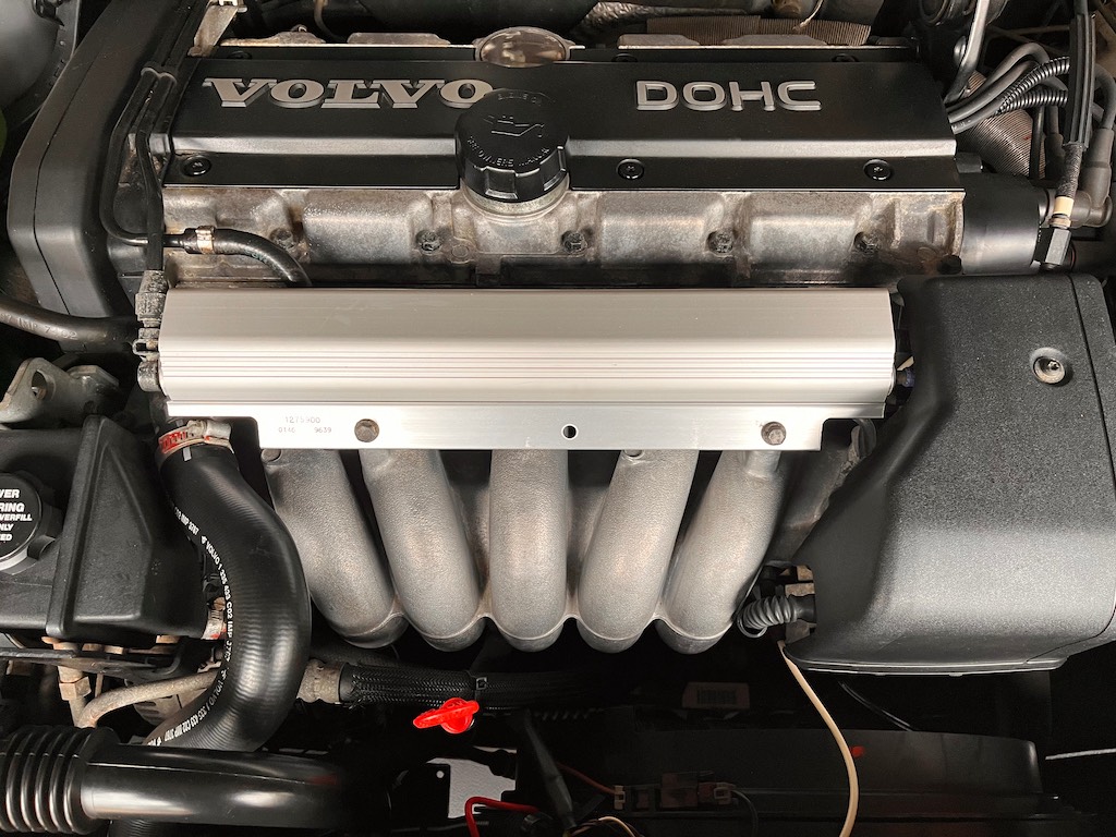

Vapour blasting is the best method to restore to factory finish but it has to be removed from the car to be done.
Mine was covered in a thick layer of white powder when I bought the car, every time I touched it the powder went everywhere. I tried several different brushes, nylon, rubber, wire, Scotchbrite pad but I found a brass wire brush gave the best results.
Before
After

When I did the PCV a few years ago, I cleaned the intake manifold and other aluminum parts with a brass brush and alcohol. It was pretty fast and easy and still looks good.
