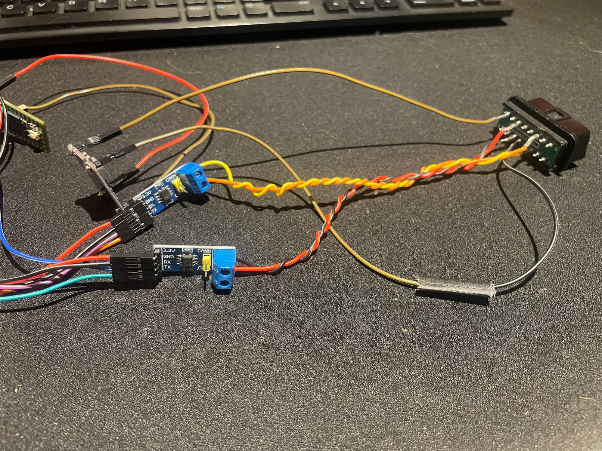

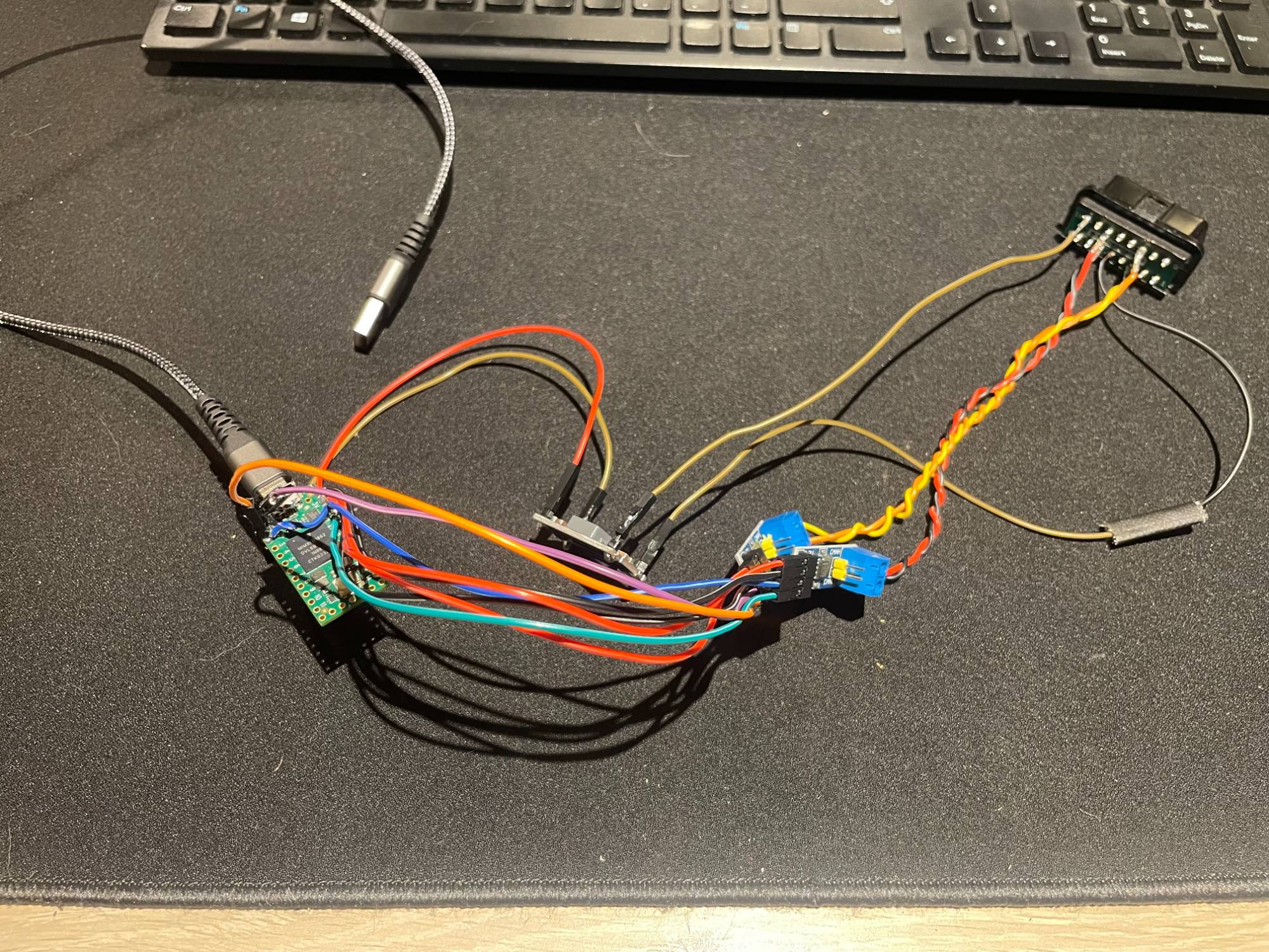

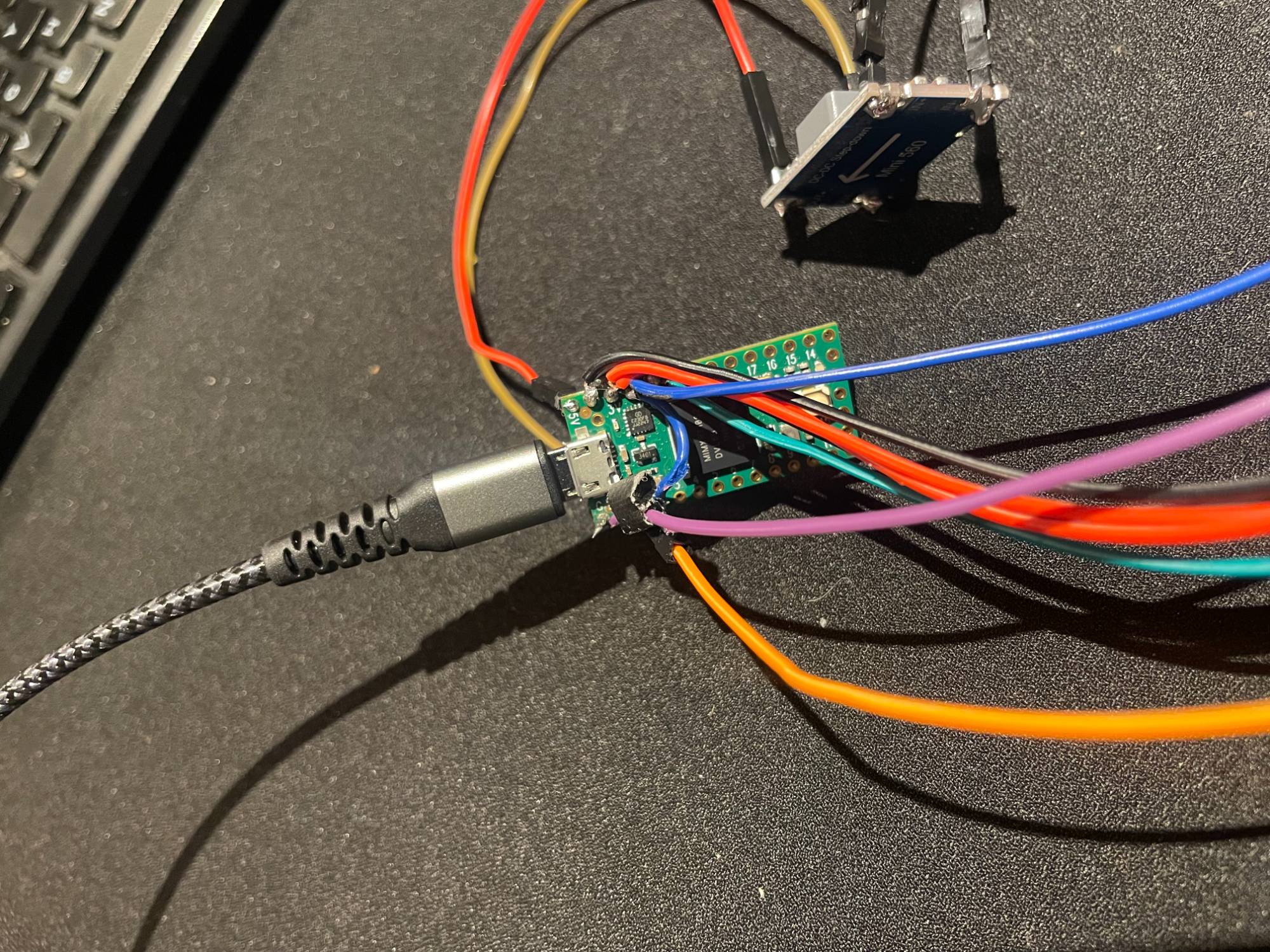

Something is already starting to form...
We built this miracle with CKaev
I would like to make j2534 out of it. It is already starting to process USB commands, but I need to figure out how to write an API.
It looks ugly, i know, but wires are not touching each other, everything is soldered, copper wires are used, CAN wires to OBD are twisted, quality 12V->5V step-down converter is used for sufficient power, nothing is ordered from Ali and are bought from local electronic shop.
Still only the [0] byte is found with 100% consistency, [1] and [2] are always different.

Transceivers still can be fake.regula wrote: ↑18 Feb 2025, 13:17 It looks ugly, i know, but wires are not touching each other, everything is soldered, copper wires are used, CAN wires to OBD are twisted, quality 12V->5V step-down converter is used for sufficient power, nothing is ordered from Ali and are bought from local electronic shop.
Things to try:
- set clock rate to 180 MHz
- sirloin's one_pass branch: https://github.com/cmolson/volvo-cem-cr ... e/one_pass
- cem_freq_align branch: https://github.com/vtl/volvo-cem-cracke ... freq_align

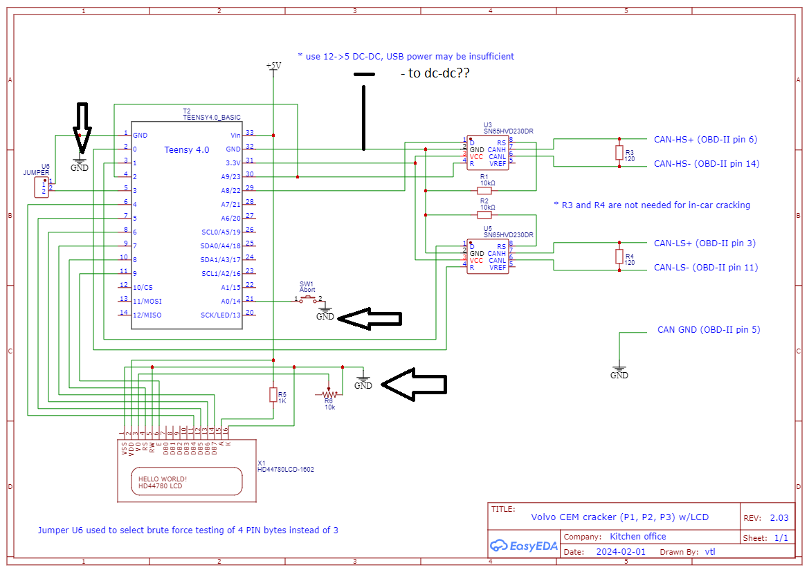

But have questions about ground on schematics.
Where connection ground?
And can i have switch to change between master and p3 script without pc?
- schematic_LCD.png (93.74 KiB) Viewed 4142 times

You only need to connect all ground together with your power ground.
Regarding the switch you cannot switch between branch without refactoring the code to merge both branch in one.
