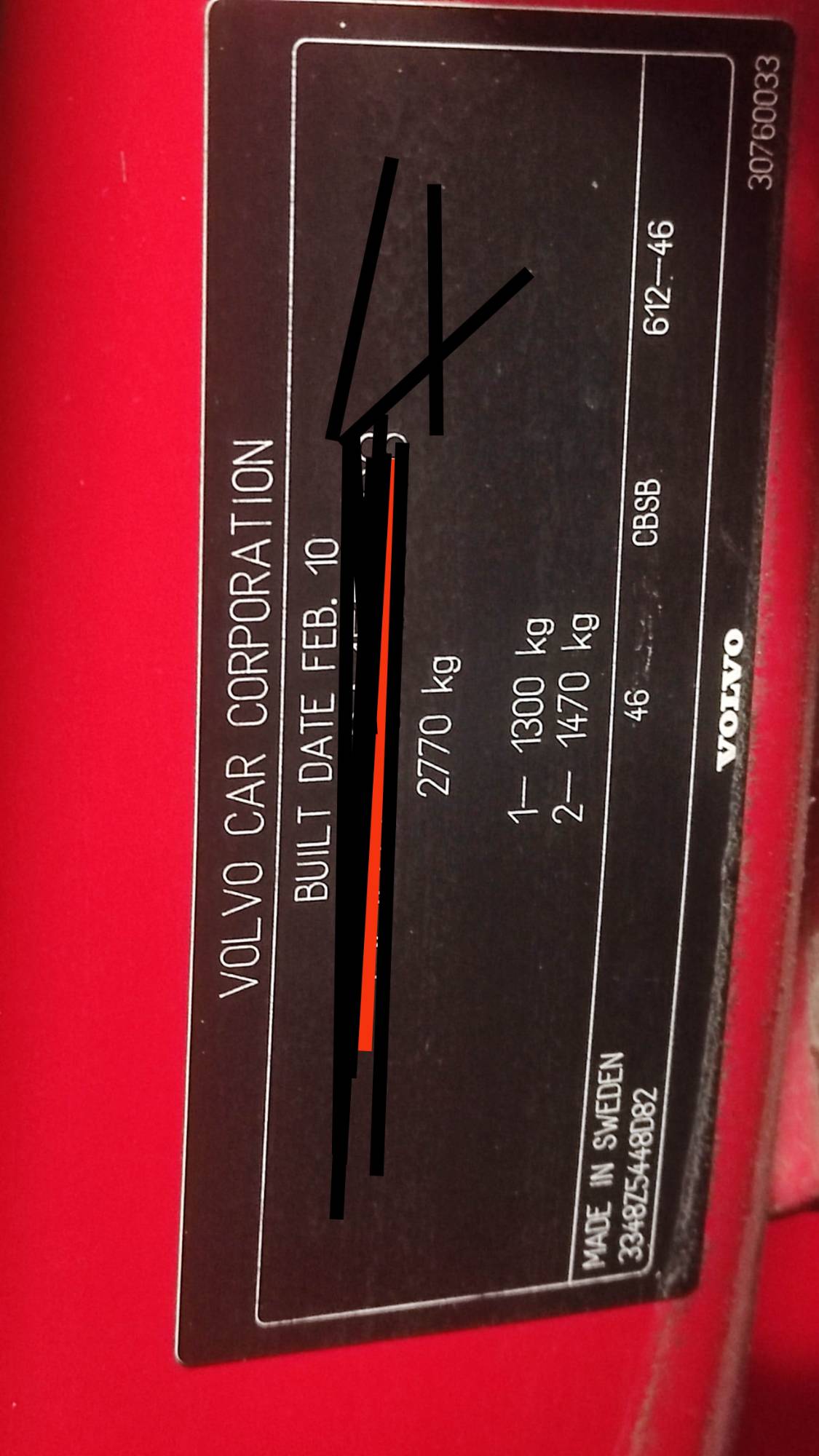

ggleavitt wrote: ↑07 Sep 2024, 08:50 Very cool !
Out of pure curiosity, could you get the alphanumeric number set in the lower left corner of the label on the back of the (probably) right side B-pillar? It's the big label that has your VIN on top. The lower left will look something like this (my V8 Sport): 33AEZ5448D52, if you could post your string, I'm interested in seeing how the vehicle was set up. Bottom of the label also includes your interior code plus the paint/shade number.
The R-Design (aka Sport) is a slightly modified vehicle with different suspension components, higher bolster seats, and a "sport" tuned speed sensitive steering module amongst other more cosmetic changes.

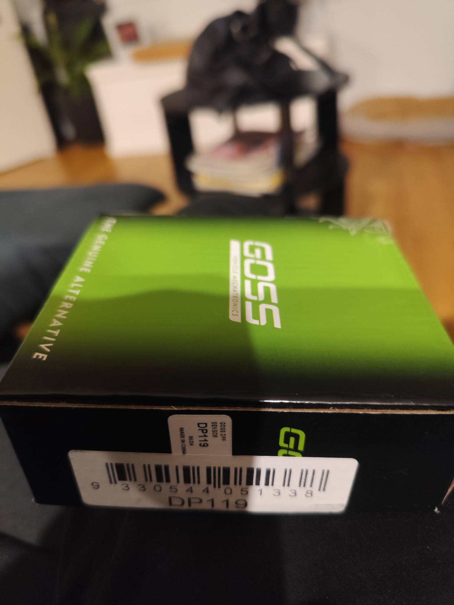

The eBay sensor was a dud. It made the car go into limp mode and it couldn't maintain more than 60kph unless it was on a flat surface. The car stayed off the road for a week until a decent one ordered through our local Repco dealer found a Goss part DP119 finally sorted it out.
