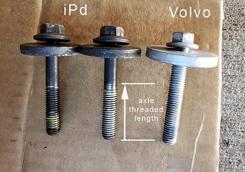

I found this pic on the web, you can see length of axle threads info here.
So, in theory you can use Vise-Grip and squeeze further up, such as threads #9-10-11-12 etc.
