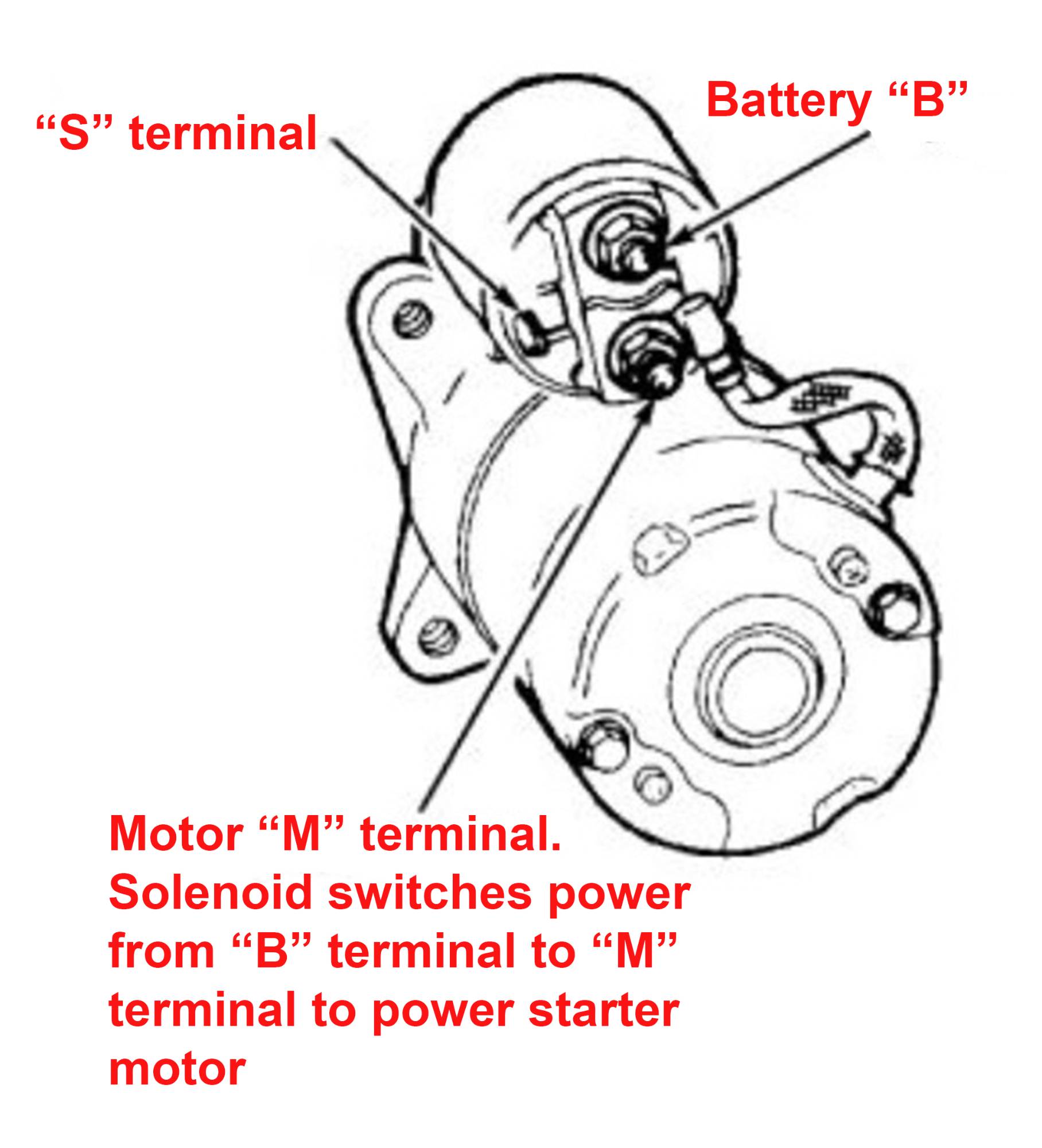

Including Pic of the starter terminals.

- Posts: 36145
The “ S “ terminal does two things, activates the Bendix which pushes the starter gear into the flywheel, and electrically connects the battery to starter lugs inside the solenoid
When you jump the two big terminals with a screwdriver or the like, you don’t activated the Bendix, it just spins the starter ( fairly fast, as it isn’t loaded)
