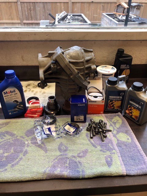

It was a full day of wrenching on the XC70 today! Used angle gear from a 2002 resealed and installed, I was waiting on a output flange seal to come (2002 has a different flange and seal ID) Had to put my 2003 flange on after the seal was changed. Did a final level check on the Haldex, reinstalled the propshaft, changed the oil and filter, and put the summer tires on. I made a special press to seat the collar sleeve on the transmission, I'll add a picture of it tomorrow.
