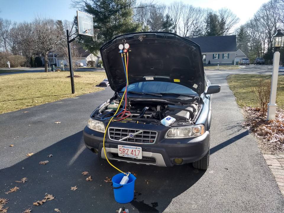

Post by vtl »
In the donor I bought for drivetrain and interior transplantation there was a hole in the condenser. Didn't have to evacuate anything, nothing left. Zero pressure. Just vacuum and fill.

Post by br0dy519 »
vtl wrote: 02 Apr 2025, 05:09 In the donor I bought for drivetrain and interior transplantation there was a hole in the condenser. Didn't have to evacuate anything, nothing left. Zero pressure. Just vacuum and fill.
Need to evacuate as open to atmosphere means moisture and contaminants got in there which will kill a compressor. Vacuum should hold 500 micron or under after shutting pump off.
Always best to purge with nitrogen first.

Post by vtl »
br0dy519 wrote: 02 Apr 2025, 07:11
It was empty already, nothing I could do. If by evacuating you mean vacuuming, then yes, I did vacuum it well. Took quite a bit of time, since all that moisture was evaporating and evaporating...
