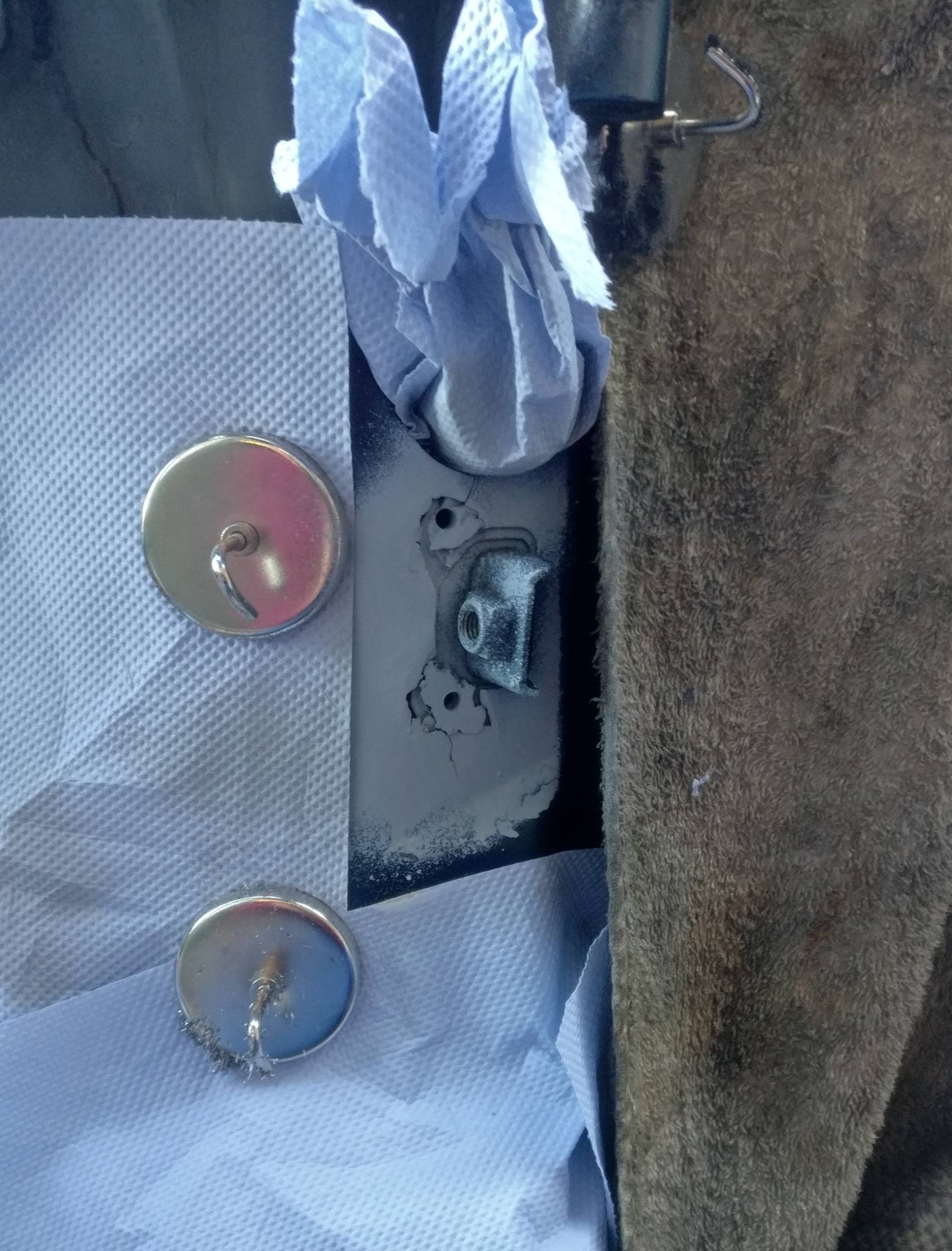

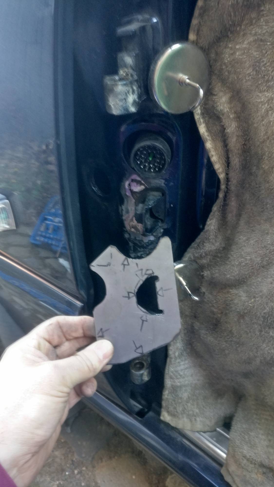

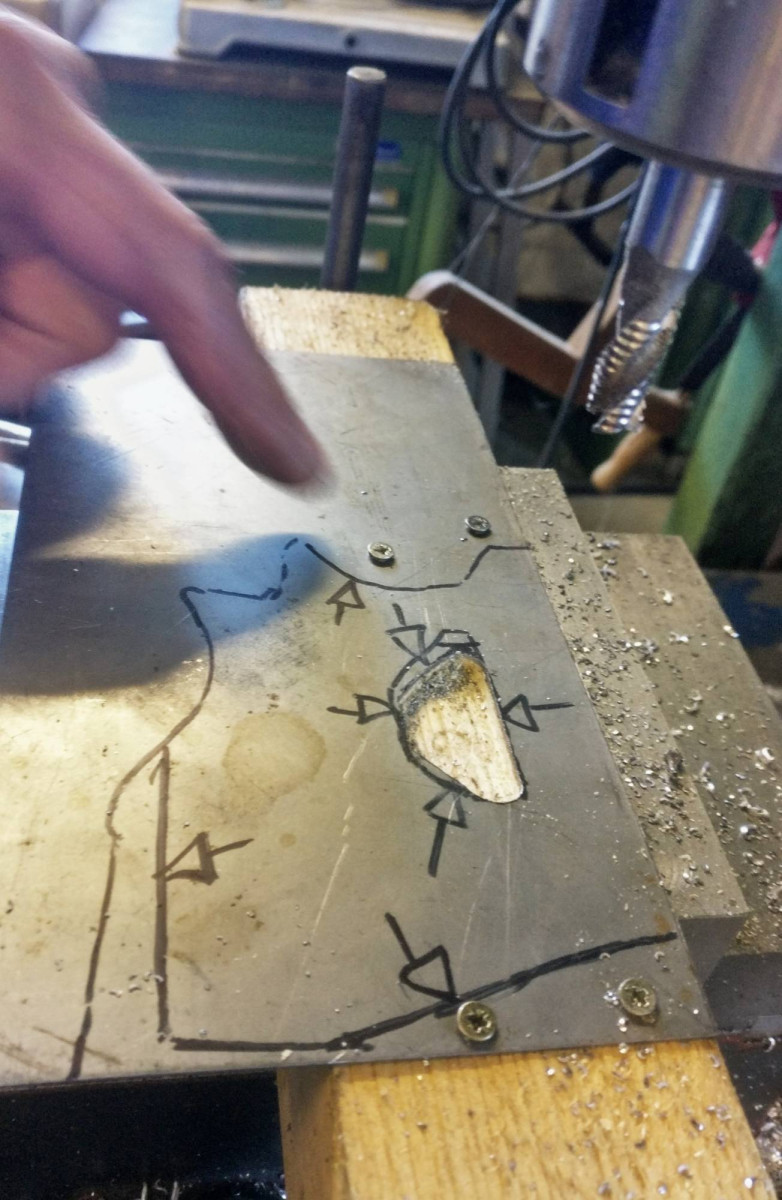

Recap of my Sunday project:

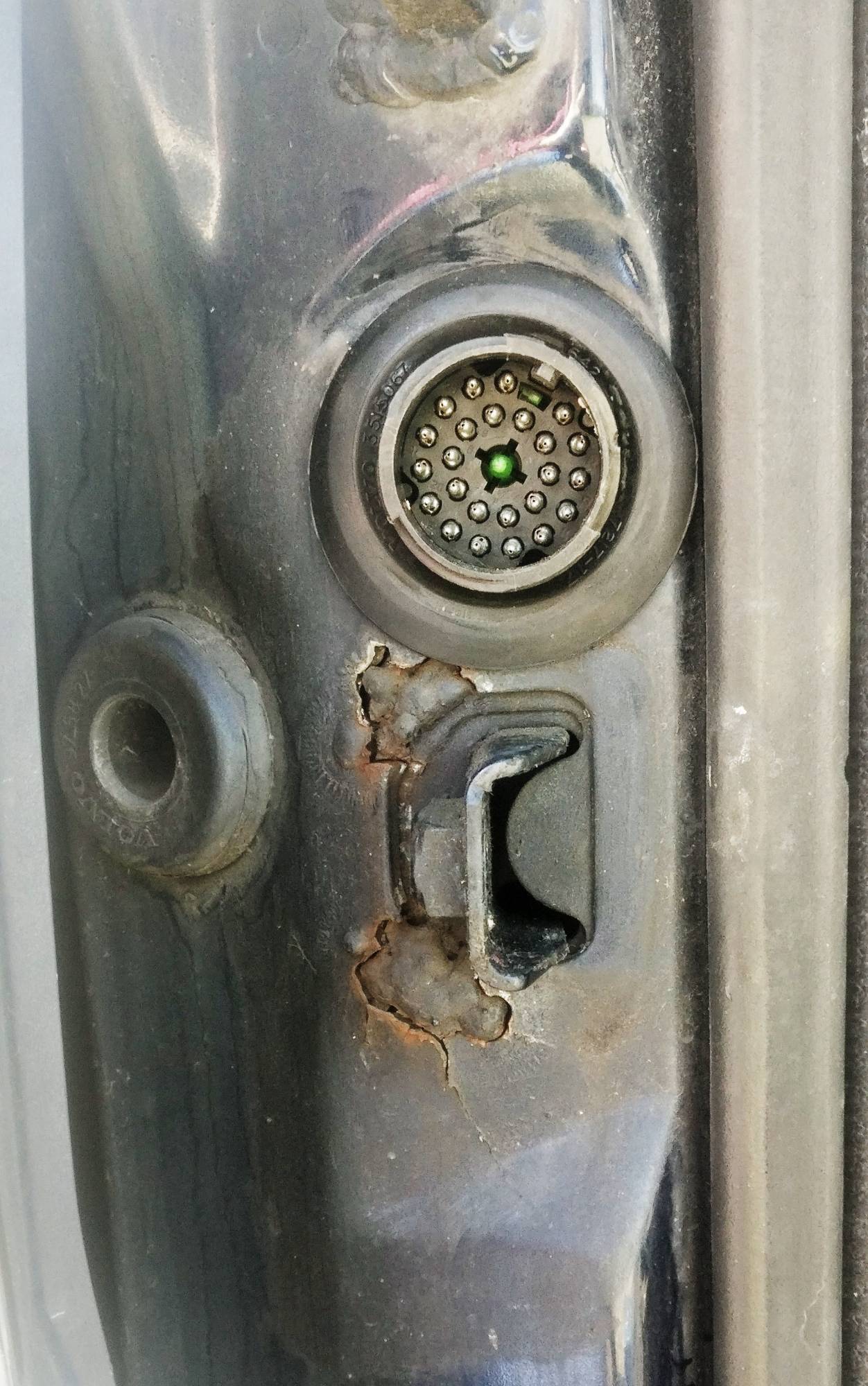

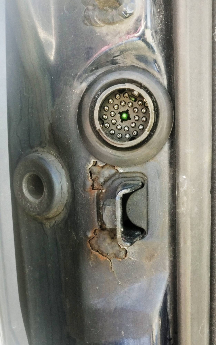

My V70 has the dreaded driver side door catch damage.
Weld spots in A Pillar failed and pre owner apparently tried to weld it before. It was time to do something about it.
You can see the cracks in the area around the catch hinge and the repair welds.
Cleaned that up as good as it gets with a belt grinder.

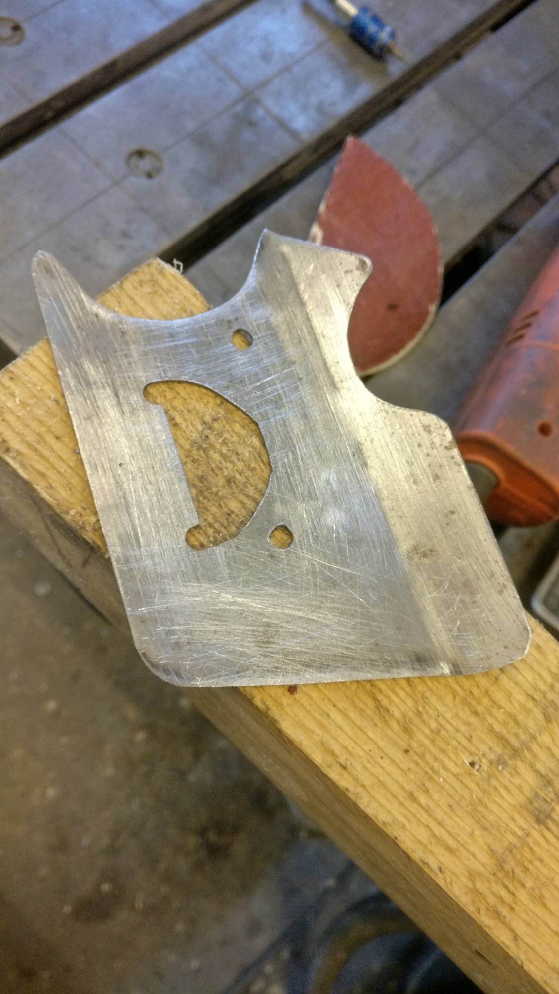

I decided to go with a bolt-on support bracket where the hinge attaches to. Since the weld spots were reasonably rigid they got drilled to hold the bolts.
I went with a 1mm gauge piece of ST37. Cut and ground to fit plus gave it a bend around the A-pillar for stability. Idea was to leave room for the Door connector rubber seal too.

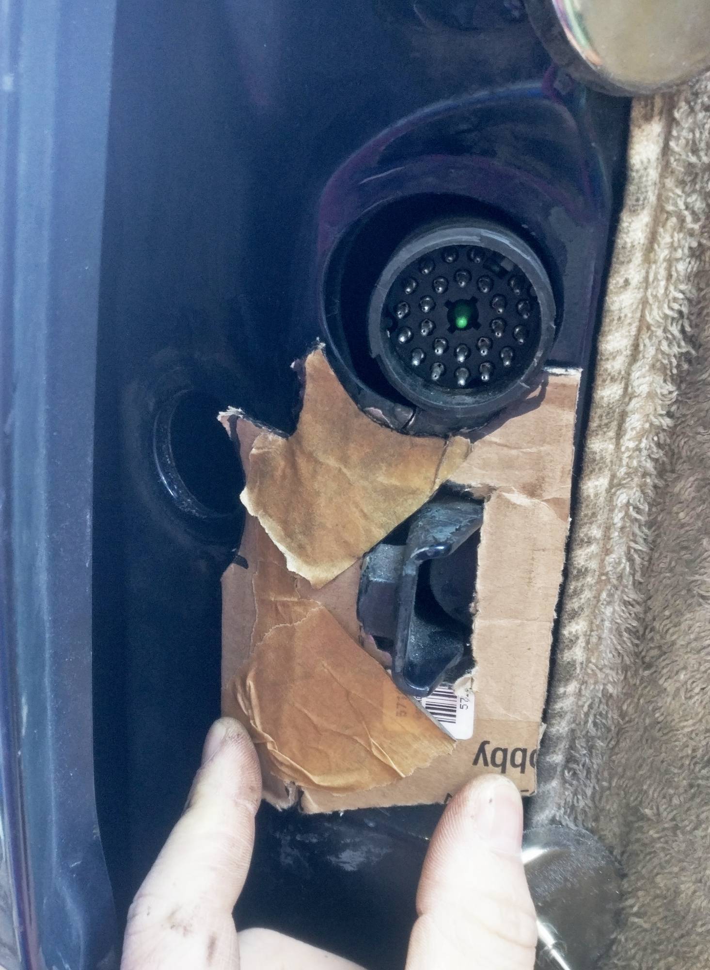

Started-off with some cardboard template tinkering.

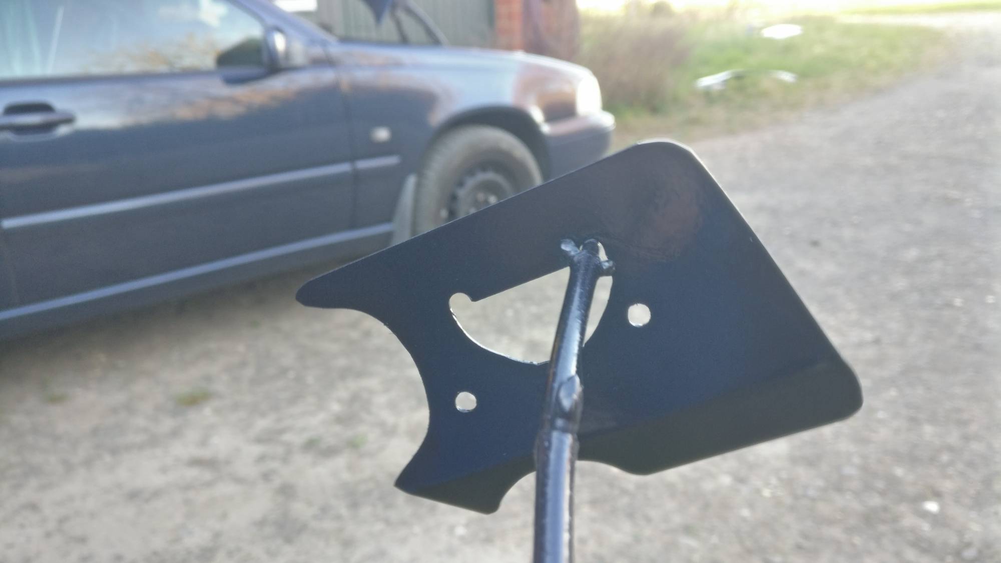

Milling out the center pattern

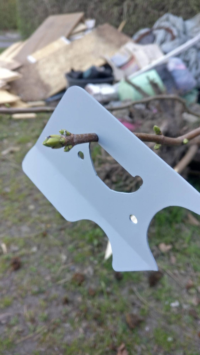

Ready for primer and paint

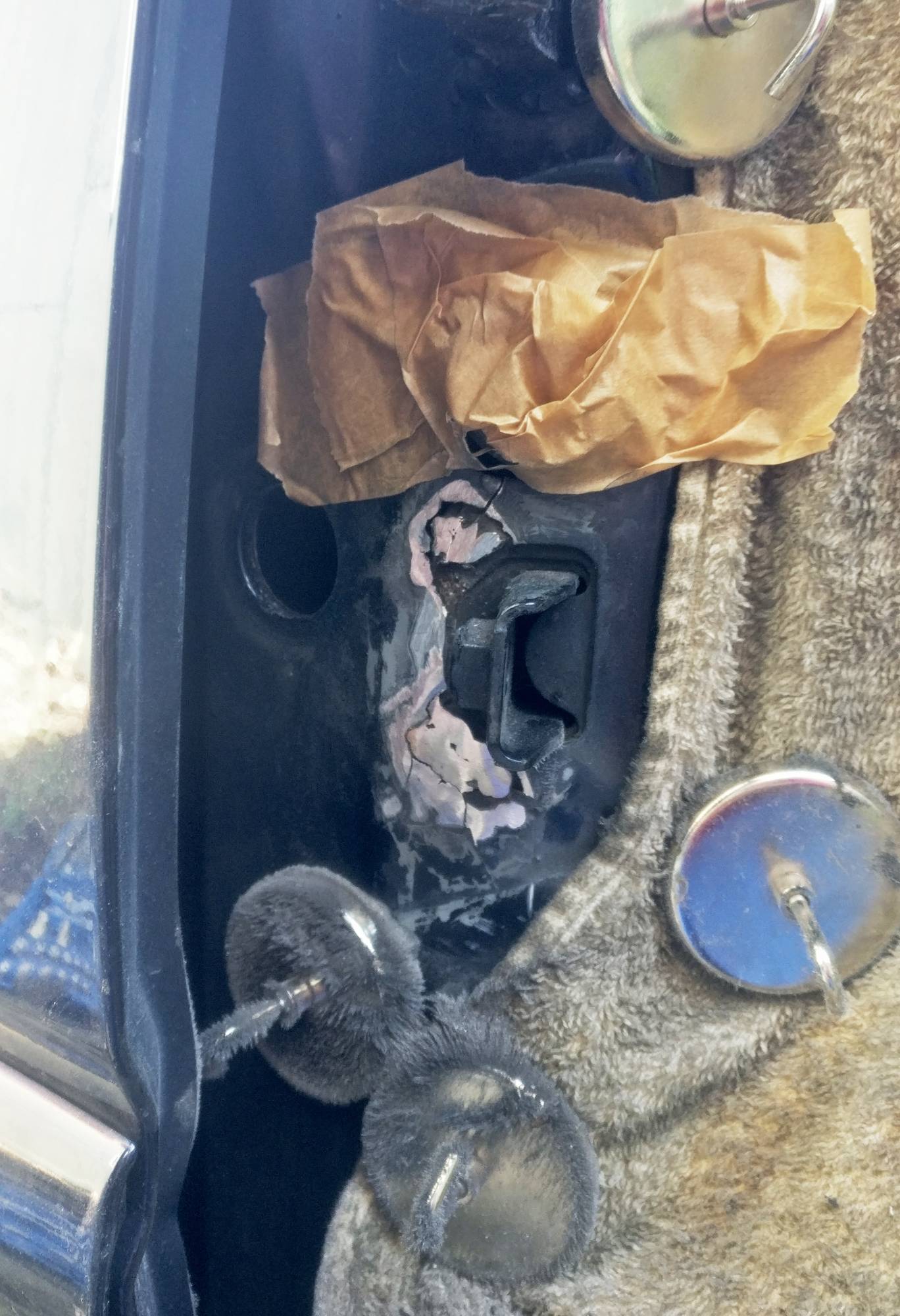

Cracked area was sealed with urethane sealant to keep moisture away before bracket went on (not shown)
If you know you know

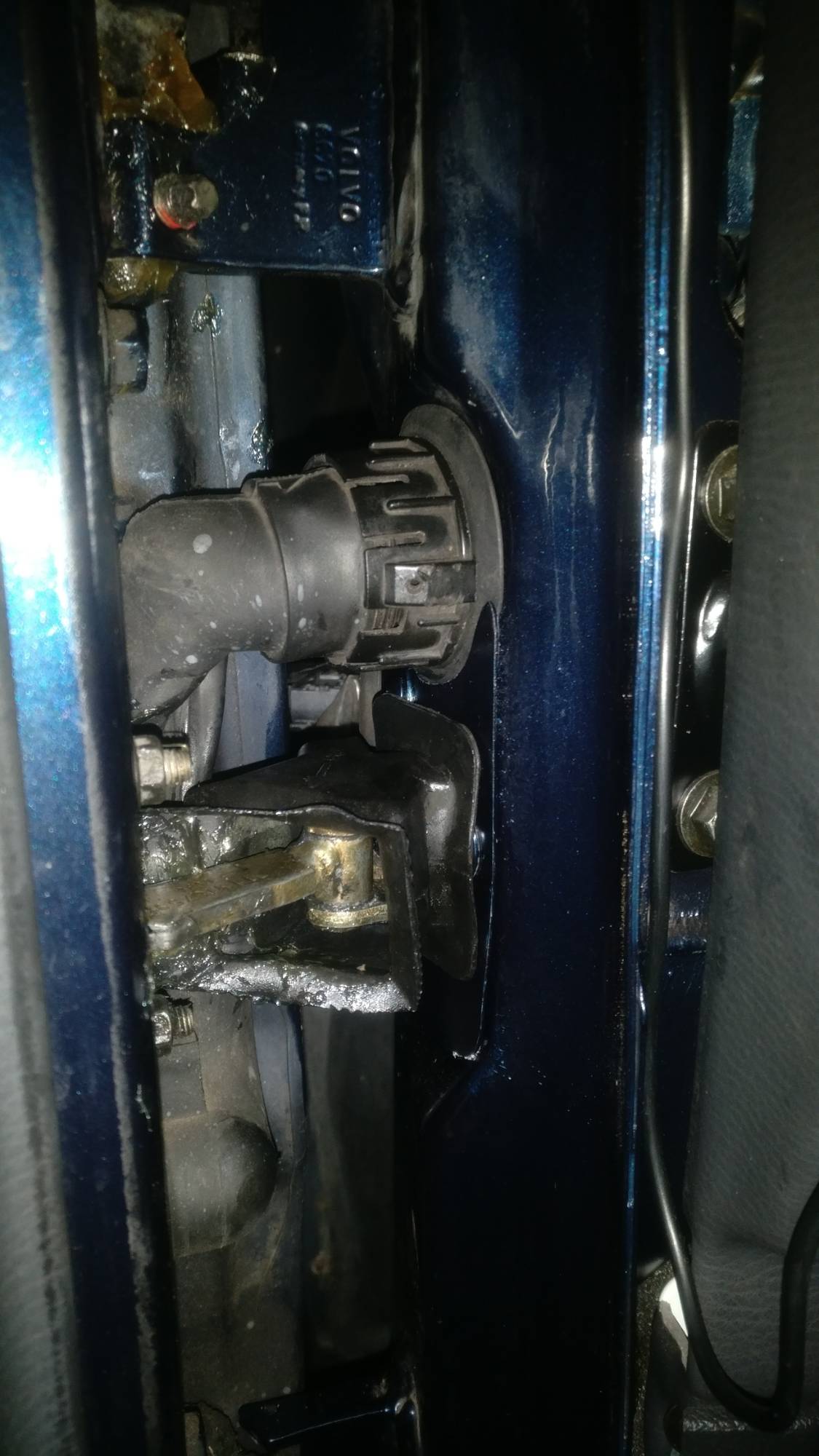

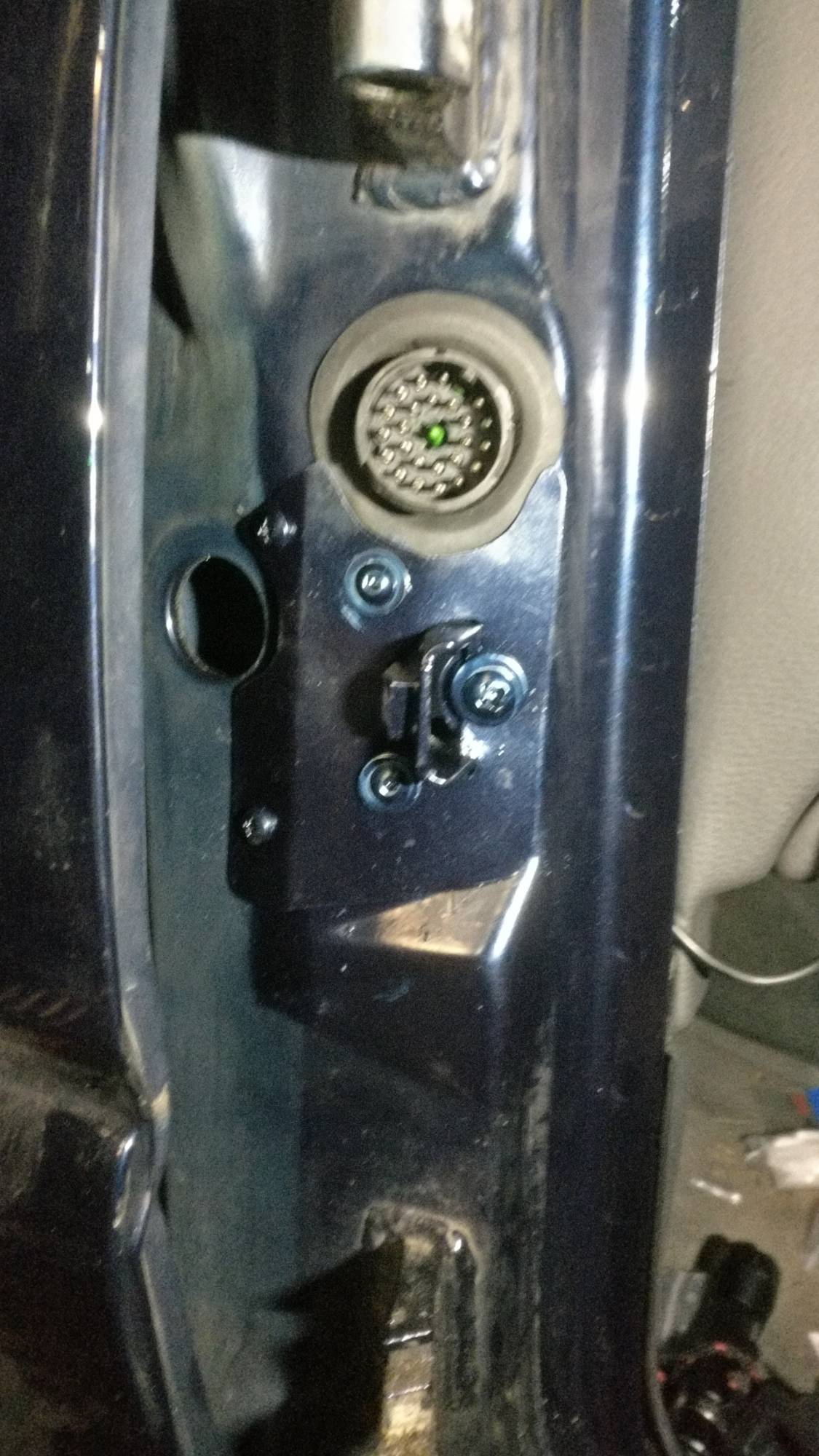

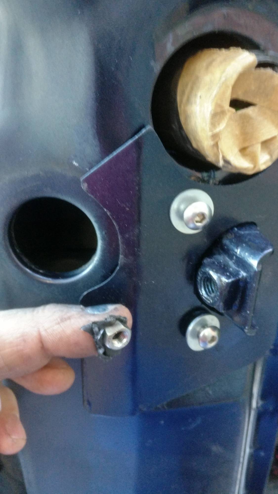

It is moments from here that I realize both the catch joint and the strap bolt will interfere with the 3 o'clock bolt head upon door installation. Ended up thinning the allen bolt on the lathe to clear the 3 o'clock bolt and loosening the nuts on the catch only enough to push it indoors a little to get the the catch joint past bolt into the hinge.
I am satisfied with the result. What would I do differently the next time? 1. Thicker gauge metal to get rid of the flex for good. 2. Avoiding catch strap interference to bracket bolts. 3.Taking off the fender right away!

MotorTheresa wrote: 07 Apr 2025, 02:05 Recap of my Sunday project:
Nice job! Hopefully that will take care of it for good!
