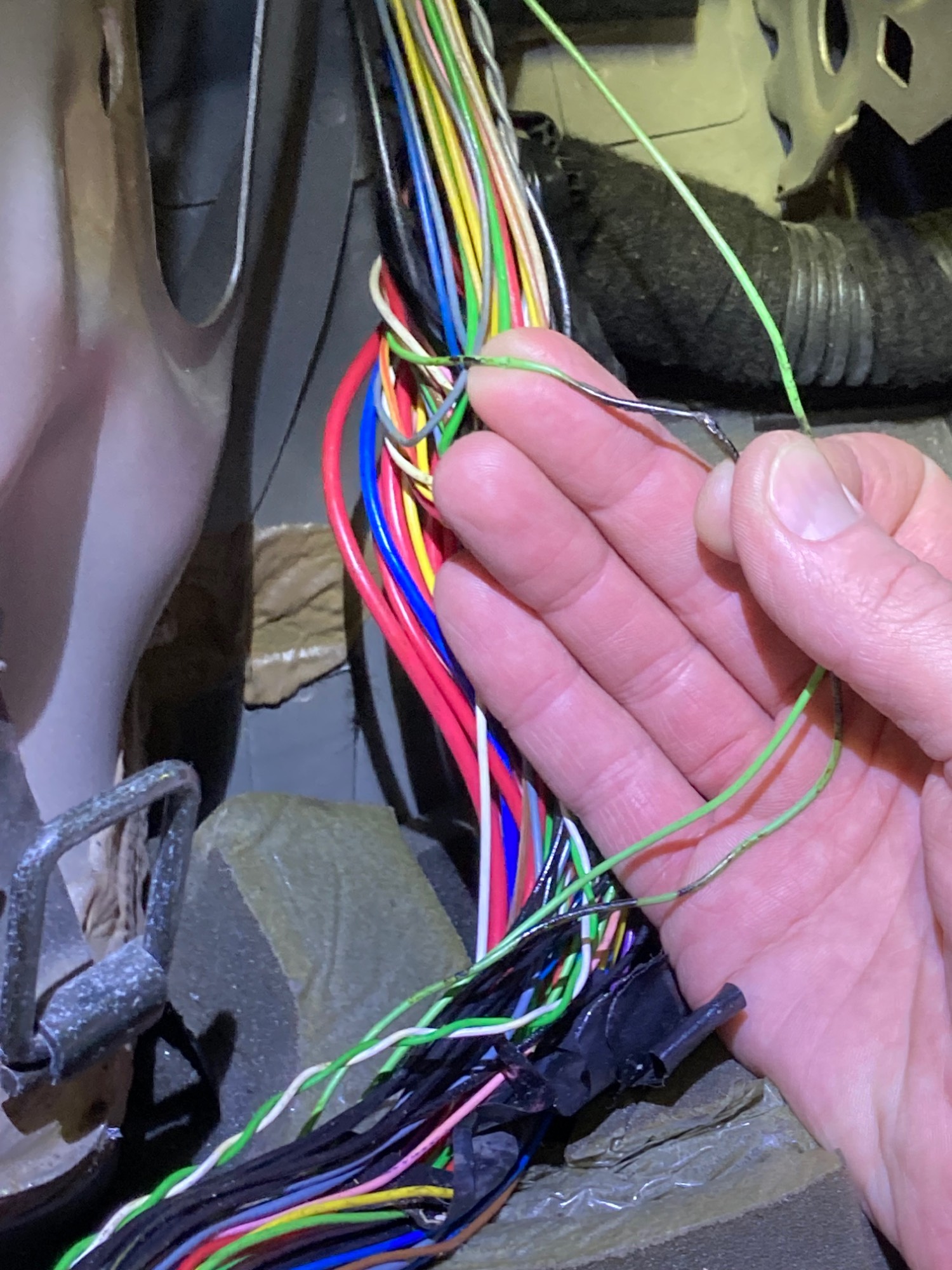

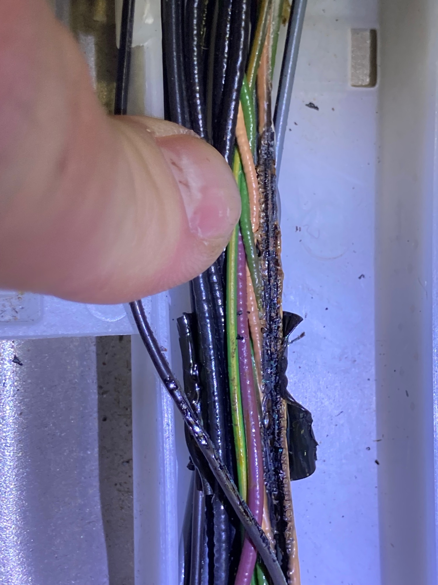

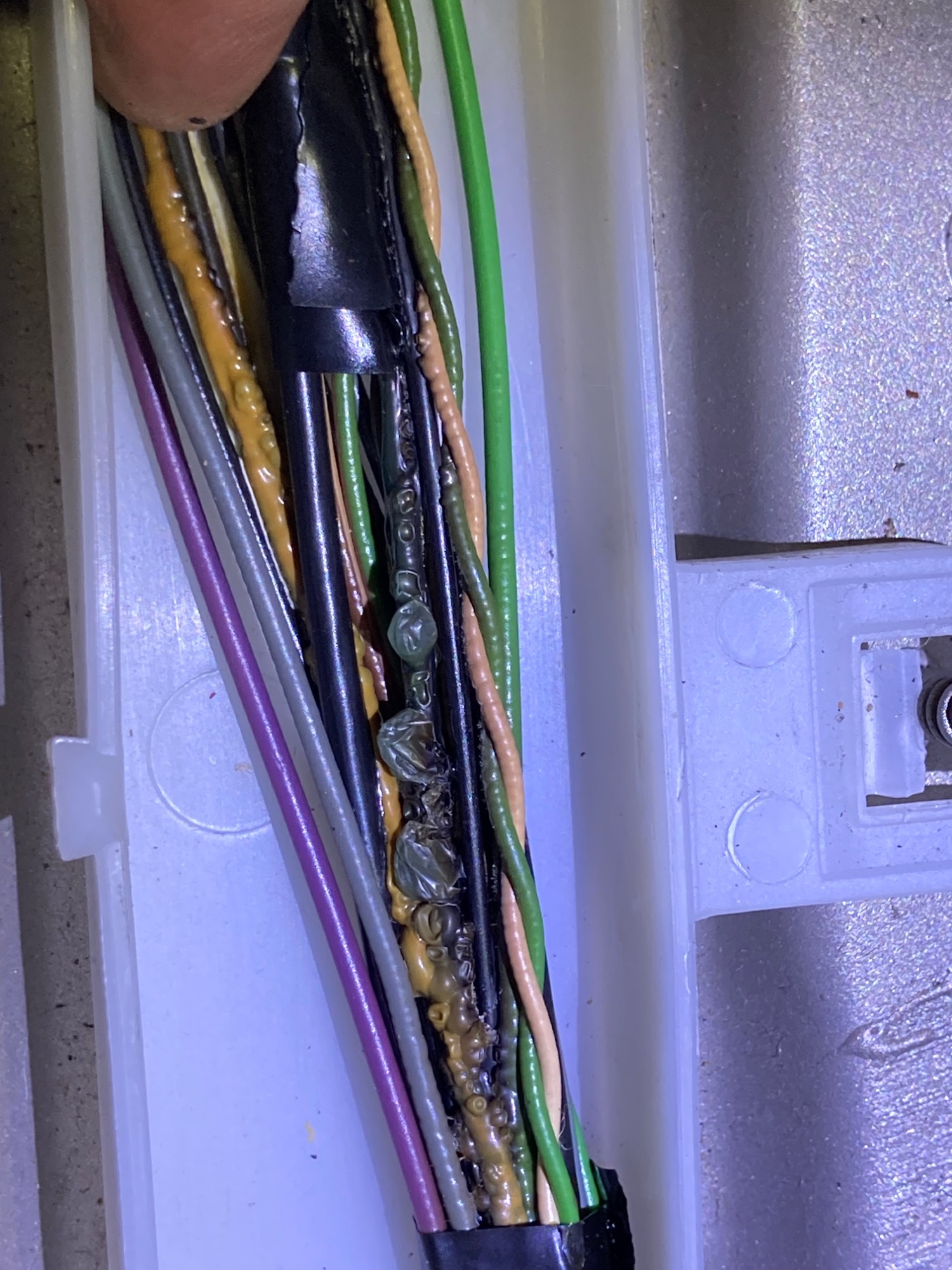

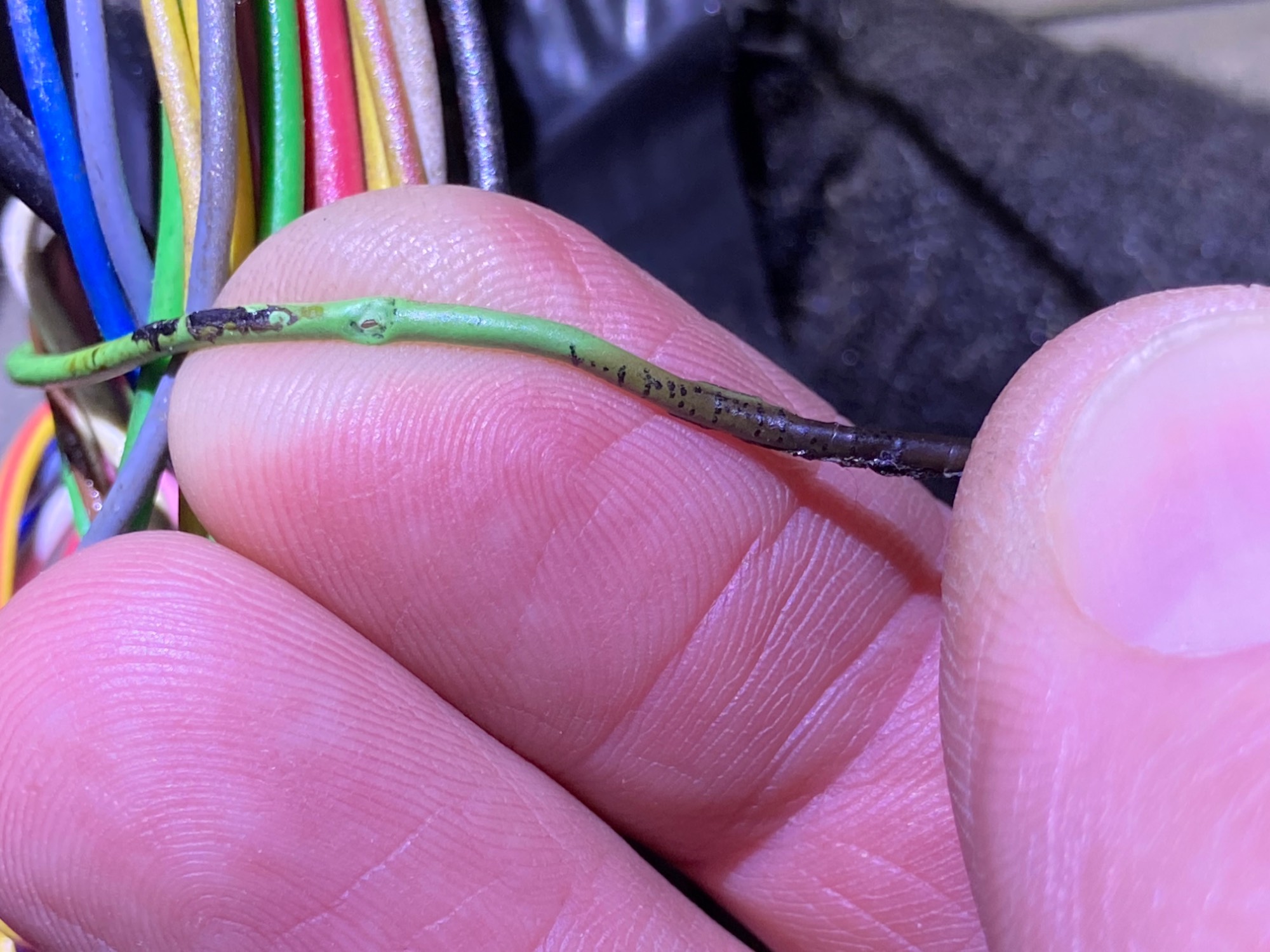

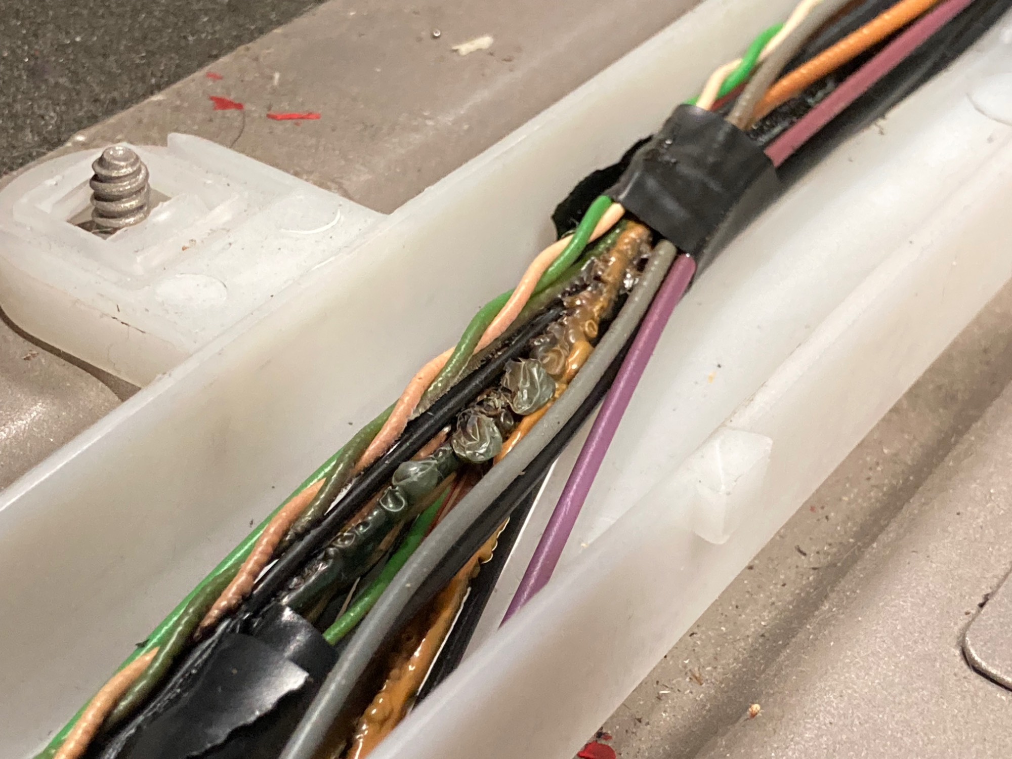

Well I found some crispy wires finally. Didn’t occur to me that I’d have to look up into the sheathing where they are completely protected to find where they’d gotten hot to the point they then became crispy. I tried to upload a video but was unsuccessful. Here’s a few photos.
Would it be simplest to chop out good a section from a junkyard car & splice it in here?
I have a feeling I’ll need to brush up on my less-than-remarkable soldering skills …
I need to pull up in ViDA where it talks about what are suitable solders to use.

Congratulations on this find. I am still surprised that all those fuses and shunts were not able to prevent this disaster from happening. I would prefer to replace that harness all together if possible to obtain from donor car(? If there is damage under portion of wire with still intact looking insulation). If such option would not be available I would prefer to use crimp and seal connectors with heat shrink wrap(usually advertised as marine grade. I think I bought from Amazon haistronica or something like that brand) for all the wires but the CAN twisted pair. Here I would try to find long donor section(if possible I would try to gently remove pins from donor car and slide them into your harness plug(this way you will only be soldering at 2 points and not at 4 which would minimize chance of disturbed signal).

Thanks. Yeah the CAN wires I am most concerned about. Concerned as in, I fear my repair skills may be too subpar to successfully perform a long-lasting surgical repair on those. I have to admit that I really don’t understand enough about the CAN portion, other than it carries signals moreso than voltage? If replacing the whole length is the best option, I then think about how much more of the car I’ll need to dismantle to replace the entire length of them & that isn’t less than daunting. They clearly were close enough to the heat to have their insulation be compromised.

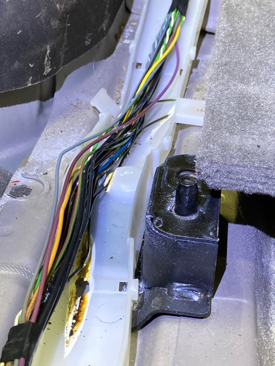

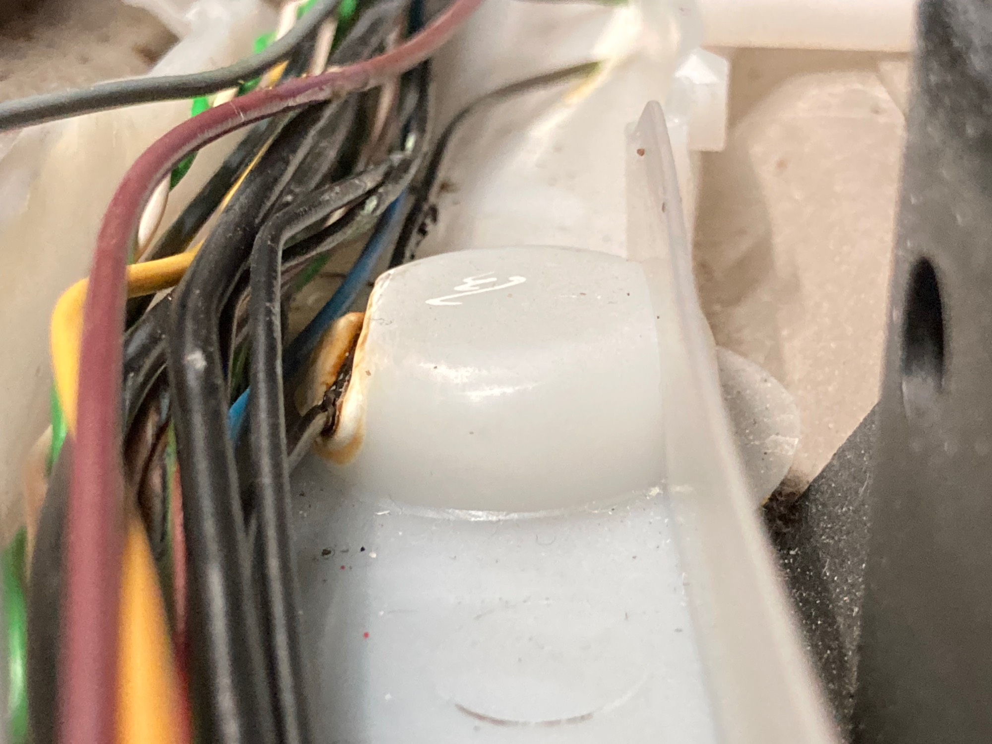

In conclusion, replacing the entire rear harness was surely the way to go. I sourced one from a local pick & pull yard for about $47 USD. As I was installing it I also wrapped all exposed portions of it with high temp electrical cloth tape (thanks for the suggestion by Vova).
Aside from pouring over the car for the last 15 months, the most time consuming part of the electrical repair was removing the entire (rear) interior. Basically all but the roof liner came out. Quite a straight forward and almost therapeutic exercise as it offers a great opportunity to clean all the junk that falls from small hands & finds its way through the cracks.
The most frustrating part was not being able to openly see the wires that had literally fused themselves together since they were several inches inside the protective white plastic sheathing. The result of this occurrence is without a doubt why I was having all the odd behaviors. Several power cables had become joined to several grounds. I had been looking for damaged wires specifically in the location where the damage occurred - the left rear tail lights. There was but 1 tiny nick in the insulation of 1 wire - barely perceptible - which I finally found just last week. Evidently, that was shorting to ground & was enough to create heat further upstream, which is where things really went awry.

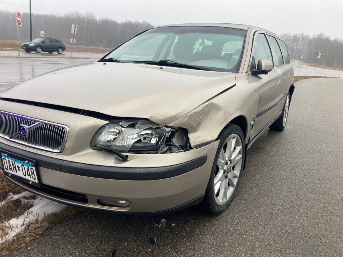

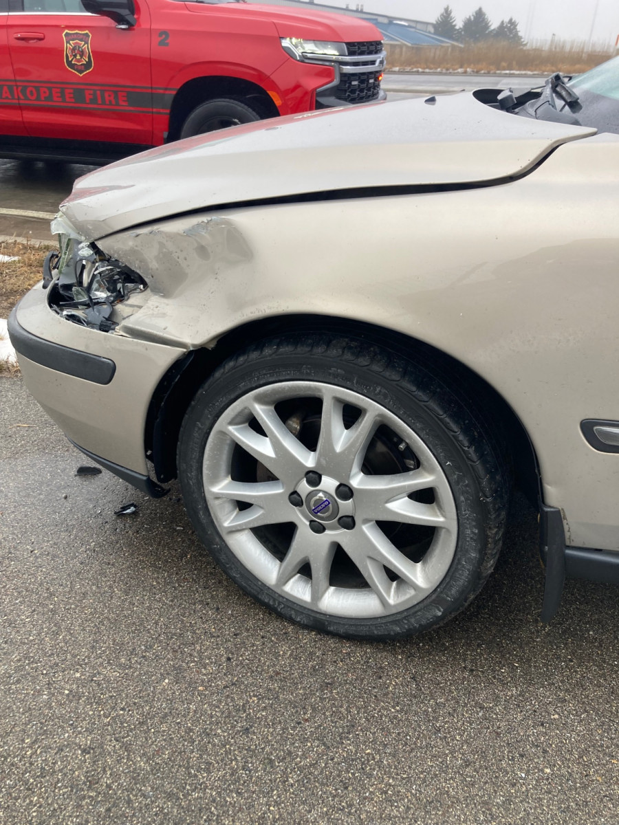

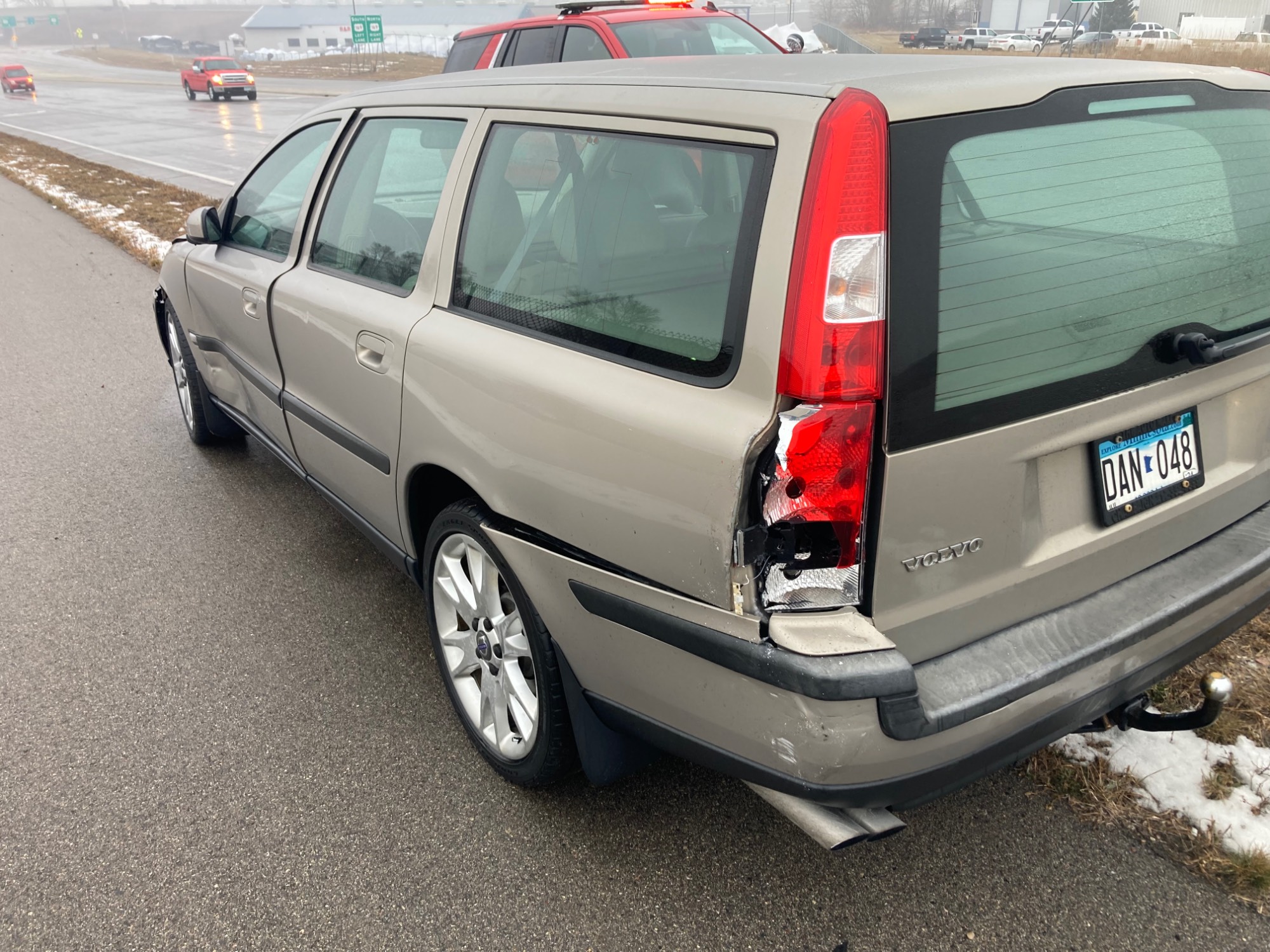

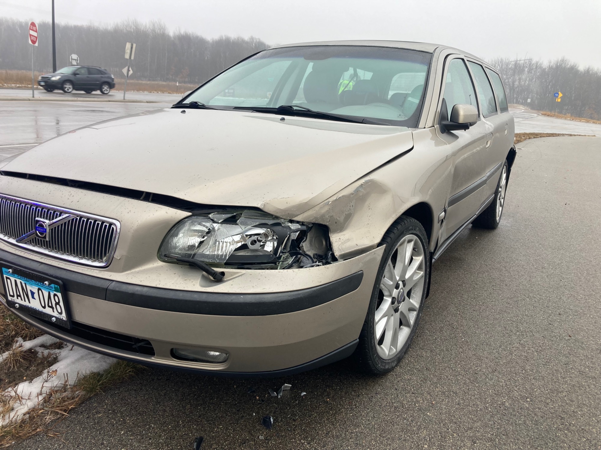

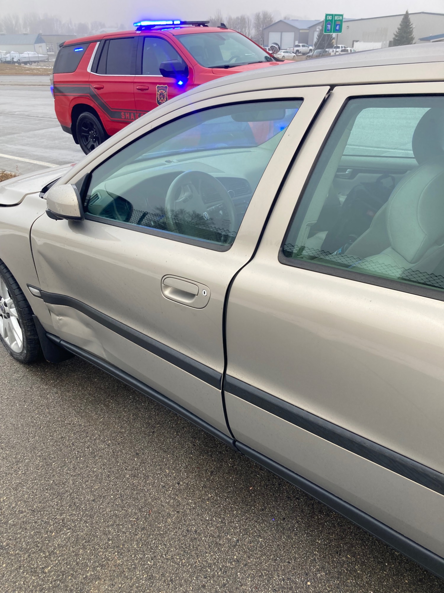

Here is the car the day I crashed it. I will get some daytime shots post self-repair job. Even though it was totalled, I was fortunate to not have much at all in the way of actual damage. Some part swapping, several hours with a porta-power & various other methods of persuasion & bending, some rattle-can paint (far from perfect but at least it’ll keep rust at bay). I still need to align my door & body panels but it’s good enough for the time being.
