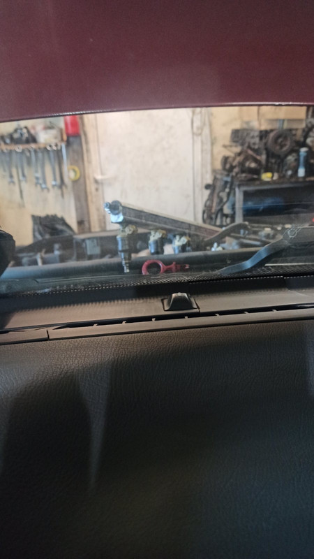

koralski
Posts: 47
Joined: 13 March 2025
Year and Model: '92 850
Location: Sofia, Bulgaria
Been thanked: 7 times
Post by koralski »
The weird thing is the LED on the dash does not flashe when the car is locked. It only flashes when I program the remote.
I will DM him and hopefully he'll check out the topic.

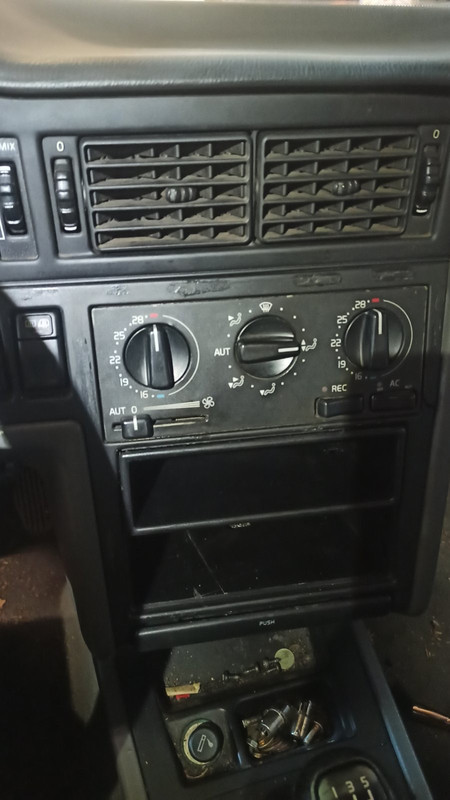

koralski
Posts: 47
Post by koralski »
Here you go.
misha
Posts: 5379
Joined: 7 December 2008
Year and Model: '97 850 2.5 20v
Location: Serbia
Has thanked: 152 times
Been thanked: 402 times
Post by misha »
Can you post a picture of whole dash please?
Not just sections.
I need to see switches too.

koralski
Posts: 47
Post by koralski »
I can't. My dad isn't home right now and I got him to snap the pics.
The switches were the old style square ones, I changed them to the later ones (which are more rounded)
koralski
Posts: 47
Post by koralski »
Hi misha!
Tomorrow I'll be sure to post pics.
Thanks for being patient with me :D
