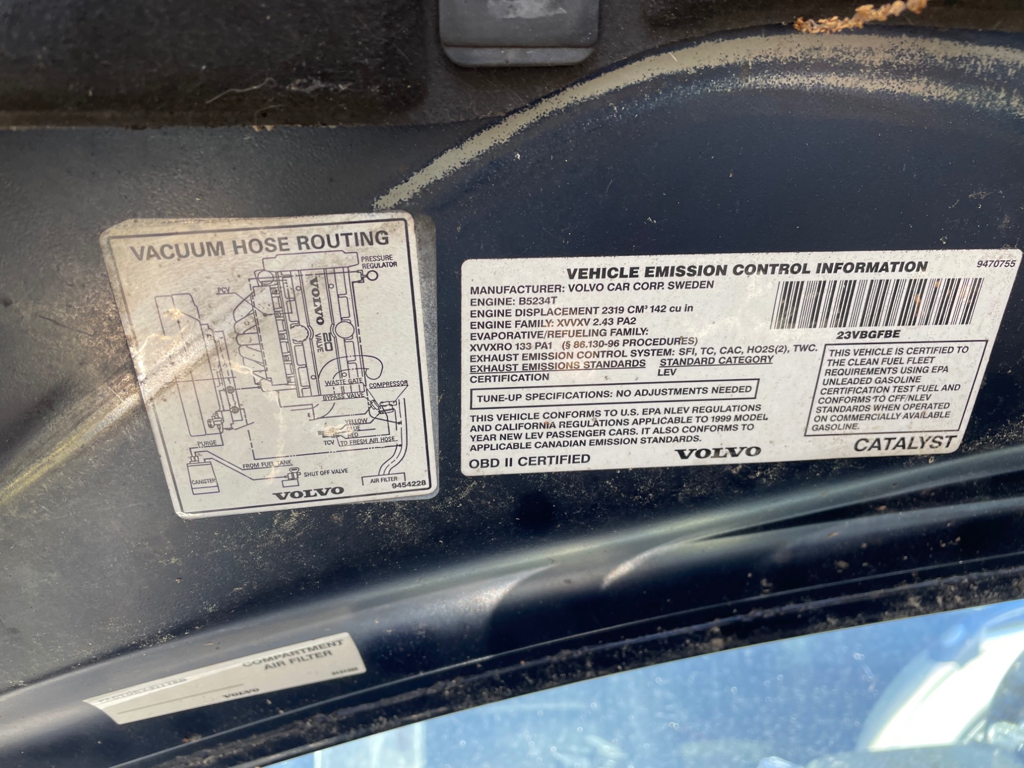

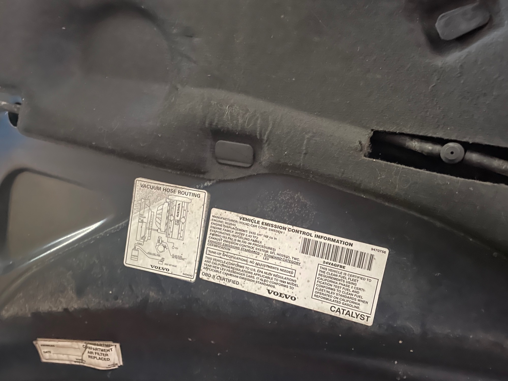

Look under your hood for the yellow vacuum line sticker. You have to be a bit careful on a 99 as Volvo kept using 98 stickers for a few months, so if it has an “FPR” on it, it’s the wrong one . You don’t have the tree on a 1999, it has ports distributed around the manifold.
The purge valve usually connects to the vacuum nipple between cylinders 2 and 3 ? On the manifold. It’s a simple hose o an NA, on a turbo it splits into a T with check valves and has the T connected to the snorkel down low at the turbo
There’s a skinny line that runs to the air box on NA cars
Another possible skinny line to the SAS solenoid near the radiator ( silver) ..if you have a UFO floating behind your engine either you have SAS or they are here.
Big fat hose to the brake booster on right side of manifold
Small hose to small black map pressure sensor above radiator , NA only
Turbo cars, a medium size hose back to the turbo blow off valve
Shrimp purge, shrimp sas, shrimp turbo, shrimp map, shrimp brake….i think that’s it.

Here a couple of these stickers from 1999s, for reference
