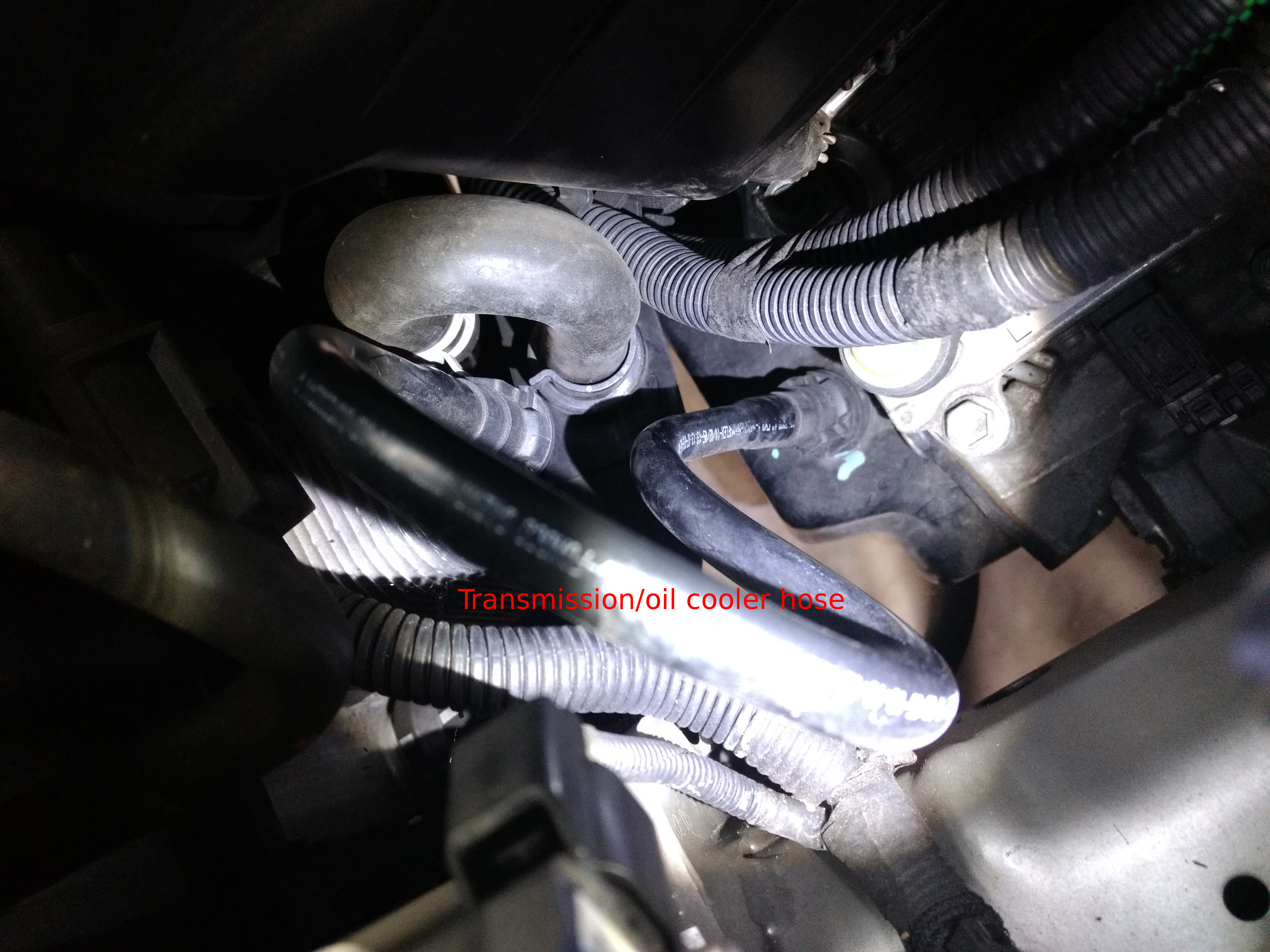

I'm trying to flush my 2005 2.4i V50, I think I've found the oil line between the transmission cover and the oil cooler. The problem is I can't find a way to remove the connector.
Haynes manual simply say "quick-release connector."
VIDA says "The quick-release connectors for the oil line are detached by pressing the clutch housing towards the cover/oil cooler. Hold the connection housing in this position. Pull back the lugs on the connector on the connection housing. Pull the connector off the cover/oil cooler."
Needless to say, this did not do much. I do see two green buttons on the connector but it's impossible, without tool, to press both at the same time. There is simply not enough room in there.
Have I identified the wrong hose?

I have the same situation with an '07 S40. I notice Haynes gets a little vague sometimes, like they haven't actually done the job. The advice from VIDA is right but... The connector on top of the transmission is inaccessible. Follow the hose back to the cooler and then locate the cooler from underneath. There is a hose with the same connector on the other side of the cooler. This one you can get both hands on.
Twist the hose a little so it starts to move around and then try pushing it into the tube going into the cooler. If you look closely you can see the little tabs move as you push the hose on. Push it on as far as you can and pull back on the tabs. With a little fiddling it will pop off and cover you with dirty oil.
