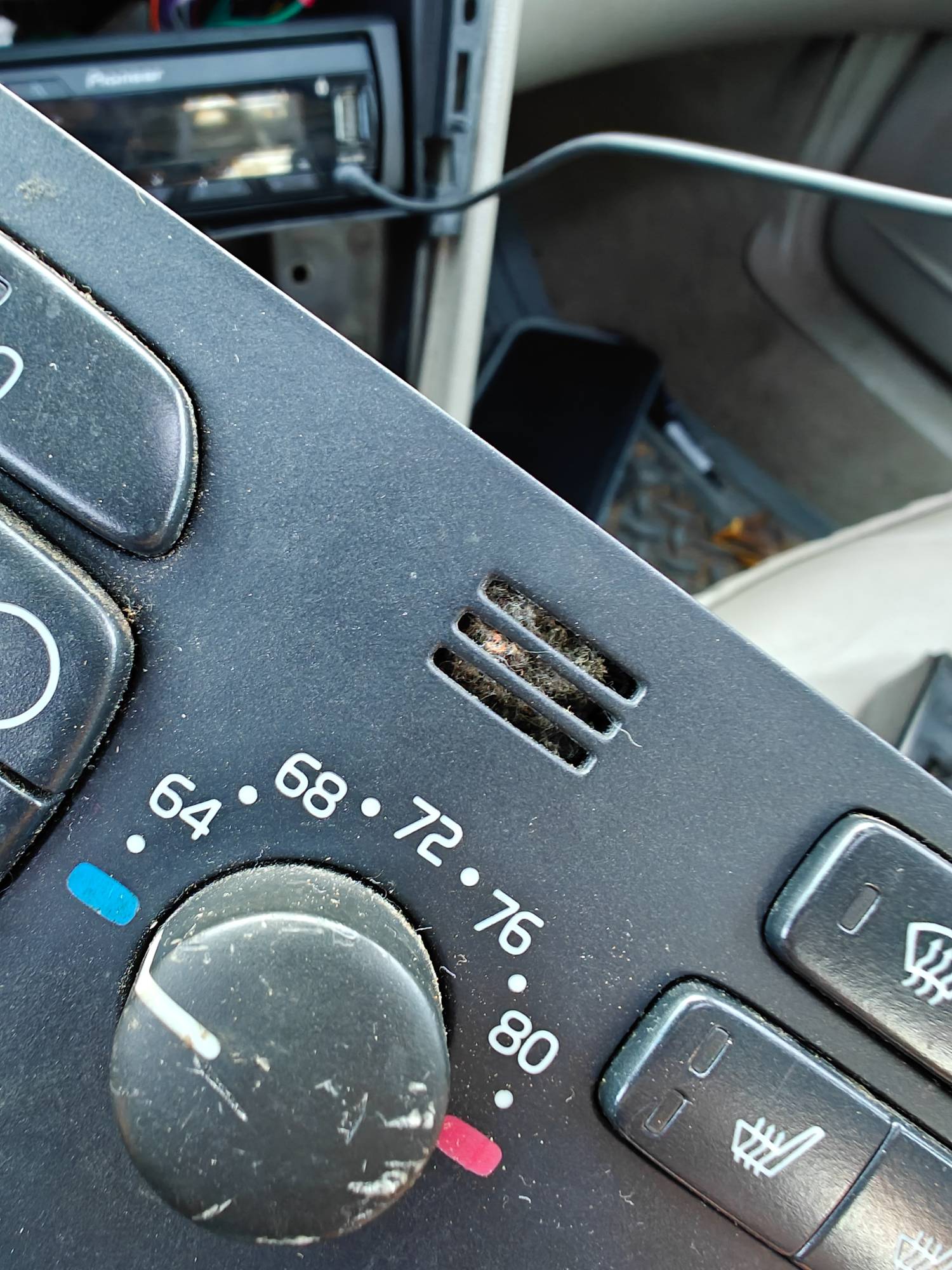

The thermistor did have a bunch of dust built up around it (see attachment), but still not cold air. The air is not burning hot like on high heat, but its definitely not cold and doesn't feel conditioned. I was also sitting in my driveway rather than driving, so my broken fan doesn't help.
Interestingly enough, while I was disassembling the unit and fumbling around, I bumped the AC on and it felt cooler than post disassembly/dust removal. I'll try it again tomorrow and see if there's any difference, but doubts are high.
