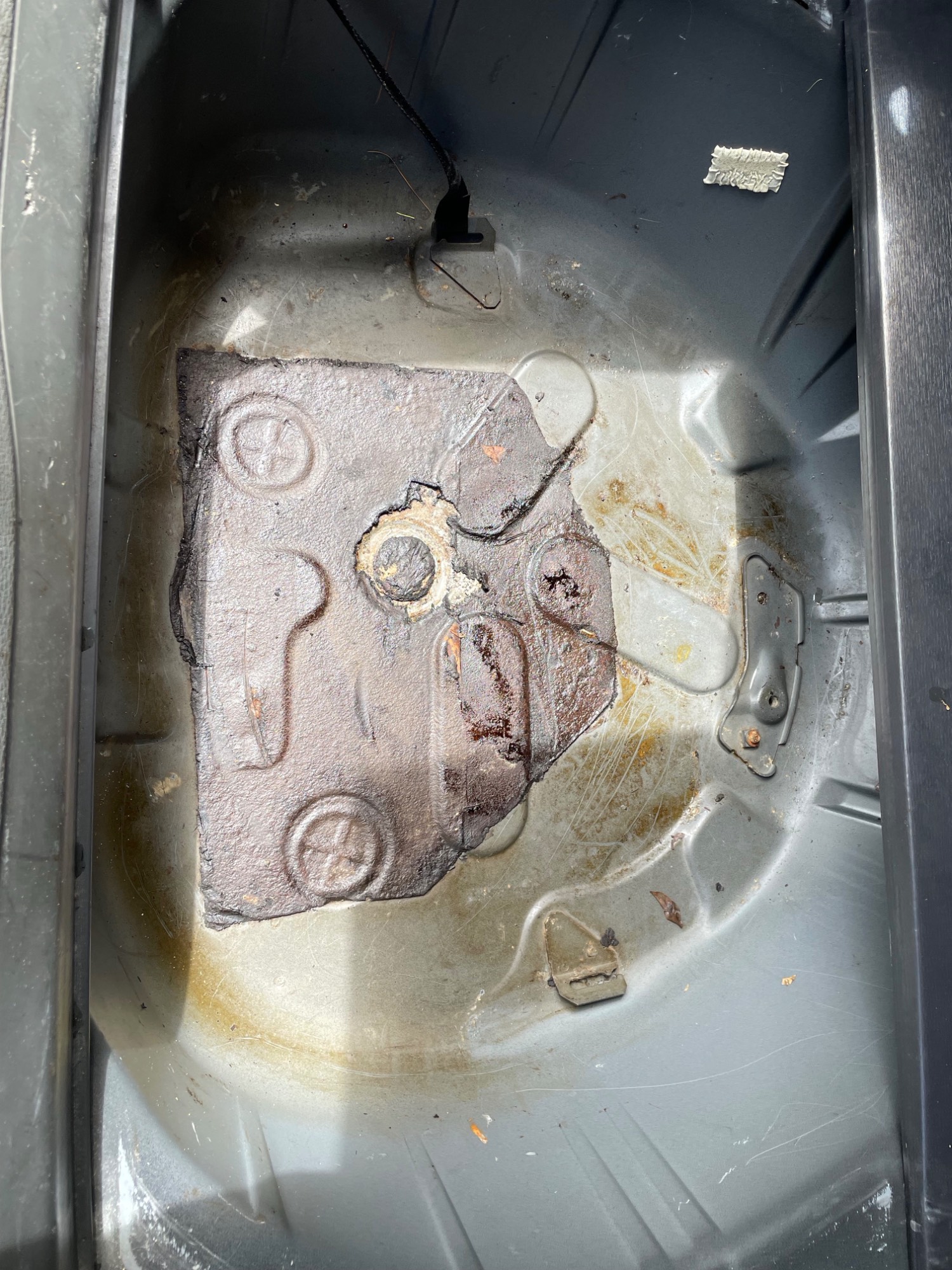

Evita seems to gather water in her spare well, happened to me again.
Is this a trunk drain that pops out? Well glued in…..

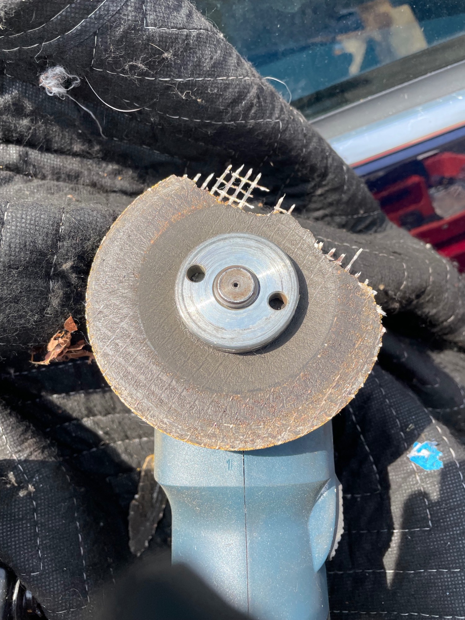

New solution for cutting semi-circular holes in stuff

Have you considered spreading something like talcum powder in the trunk area to see if you can get a track of where the water is coming in from?
Check the rear light seals, electric antenna seal, and rear windshield. Trunk seal is possible if it is flattened or not glued in some points.

Pretty sure it’s just overflow when the pin oak drops debris into the gasket channel. Right now it’s a clean out once a quarter In the wet season

Well, Matt did a you tube on this I finally found! I’ve never cleaned my drains on my S70s…

Well, I don’t have those drains on my 1999 S70…..they welded them up to give thst extra 2,5 HPboost per side.
