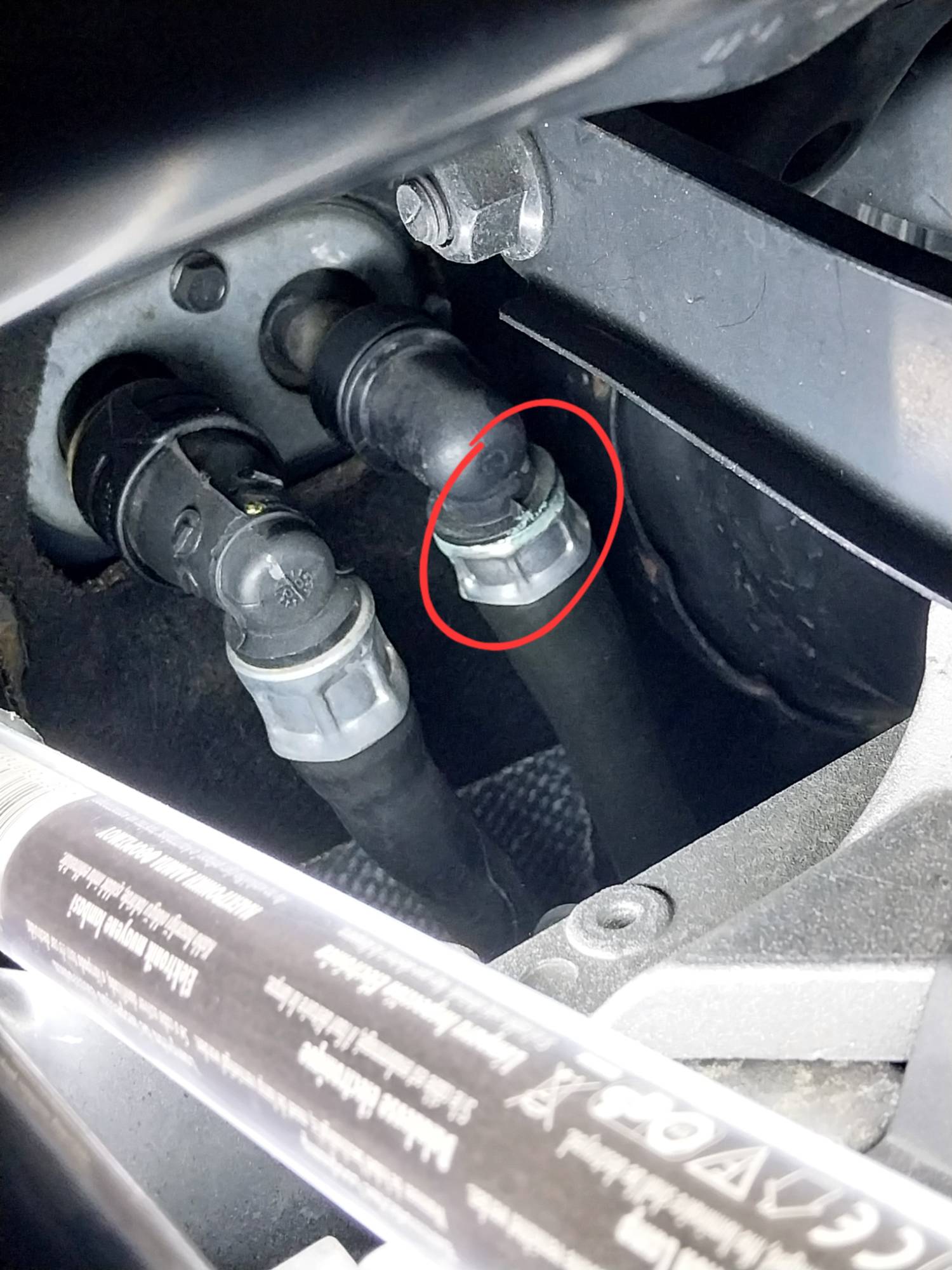

Hey guys, I have a parts related question which I think fit in the spirit of this thread.
So, Last summer one of my heater hoses failed.
I know to avoid URO, so I looked for an OEM one. Searching by the part number, I found an ebay shop selling a brand new, Genuine Volvo hose.
IIRC the hose did arrive in a nice looking box addressed from Volvo Poland or Slovakia, and the hose itself had Volvo logos in it.
I did notice the design was very different from the original hose that came out of the car, I assumed they changed the supplier to cut costs.
-> I installed the new hose, vacuum-filled and bled the cooling system with Volvo approved coolant. No excessive pressure in the system or anything like that as far as I can tell.
Now, less than 8 months and 10,000km later, it's already leaking! Coolant trace is clearly visible in the crimp union from the rubber with the metal/plastic part.
I imagine these aren't very robust and tend to fail in this area, but 8 months sounds excessive to me...
- Anyone had a similar experience? Is the OEM hose supposed to be this bad, or is this a freak occurrence? there a chance the ebay one could be a fake?
Thanks for your help!

There are a couple of ways eBay can counterfeit parts…
Outright copying with poor QC
Collecting rejected OE parts and selling as new
Both the part and source have to be vetted in this Brave New World

The seller does look like a semi-official dealership or something, and has 98% positive feedback, so seems reputable enough. Indeed it's impossible to know these days.
I'll try to trigger their 2-year warranty on parts and see how that goes. Thanks!

Good luck with that Hiroku, and let us know how it goes. I’ve collapsed 99% of my purchases to FcP or the Volvo dealer , thankfully only 5 miles away
