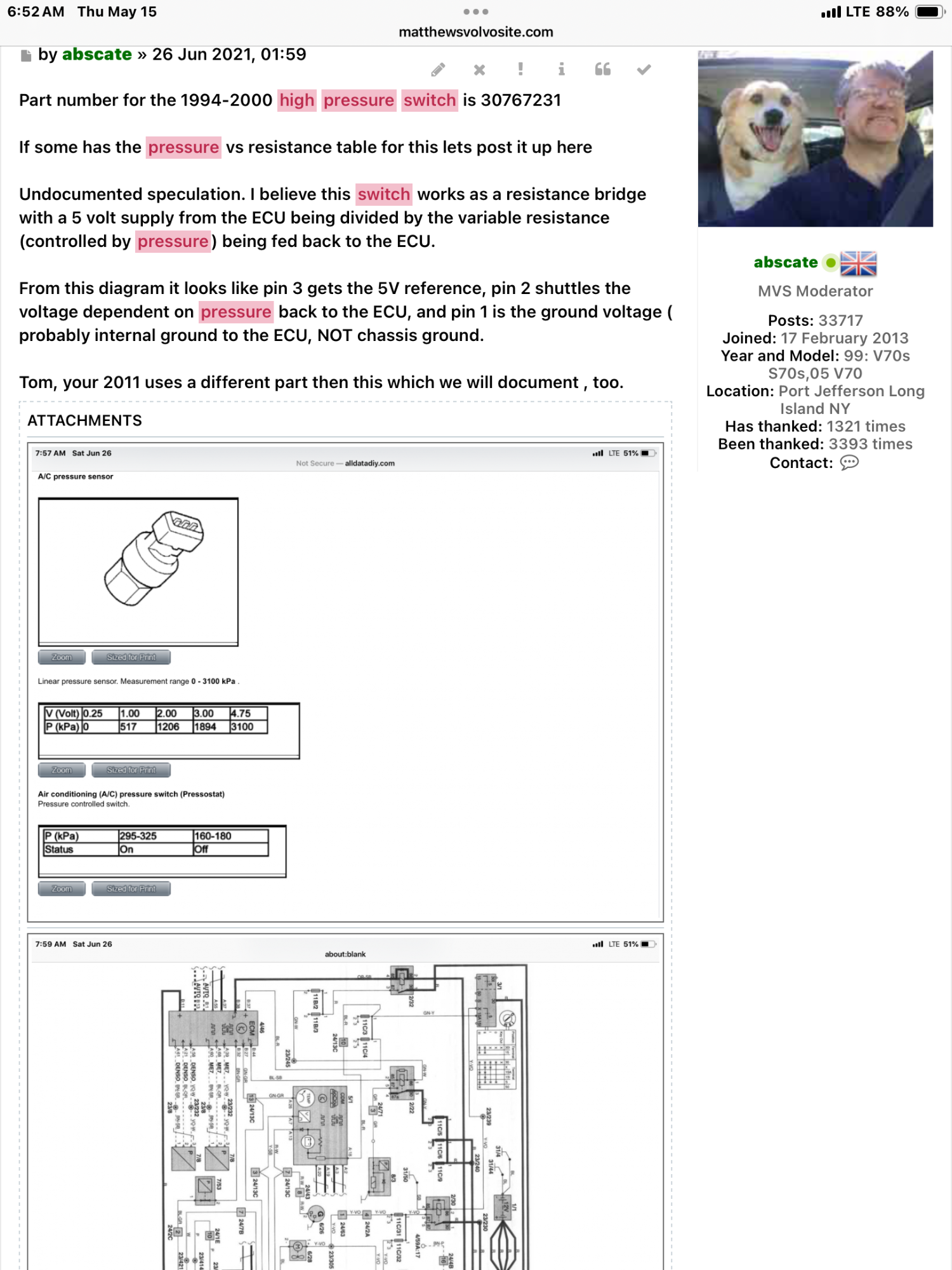

Your high pressure should be in the range of 150-200 psi.
That OBD data is suspect, it’s a data man table some wrote not specific for you car. If you don’t have a reader with Volvo specific software, you need to measure voltages on the back pins of the high pressure sensor.
I believe 1998 is the same as 1999 which is here

abscate wrote: 15 May 2025, 04:30 Your high pressure should be in the range of 150-200 psi.
This is very helpful! Based on this info ignore the data in my last post. I didn’t know what I was doing. This time around I checked between 1-2 for signal and got 4.76v. Reference 1-3 is 4.98v. This is with the car on, ac on, compressor not engaged due to whatever issue I’m having. I then checked voltage with the relay jumped. STILL got the same voltages. You think my high pressure sensor is bad based on that? Based on the table in your post it looks like my sensor is maxed out reading high pressure. My obd850 app gave me a very similar kpa value too. I feel like I am getting somewhere finally. Might jump on ordering a sensor right now.
