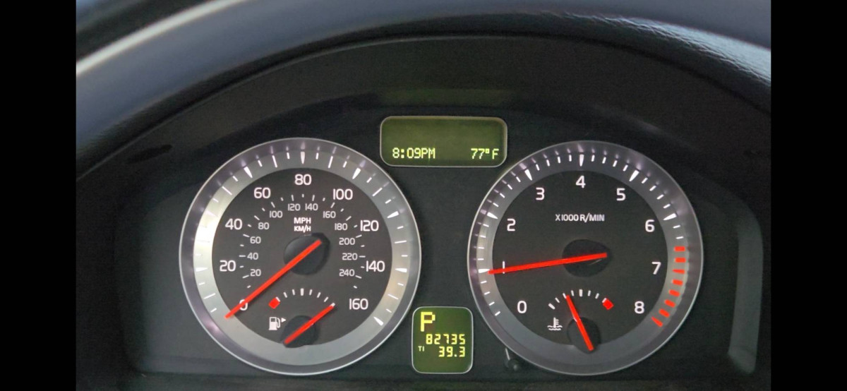

I have a C70 2007 and a C70 2011, trying to repair some interior in the 2007 so I can sell it. The front driver seat was broken so I found someone have a similar model 2011 so I replaced the seats, immediately the SRS light got on. I try to rest with vida that I have, using the VCDIAG and the Vida 2014d soft, I found where to do it and try it few times but the light stays on, If somebody can help me on how to turn off the SRS urgent service. Thank you

I was able to solve the problem and add the video hopefully can help other people. After replacing the seats I had the light on for the SRS, I have Vida but wasn't able to reset the lights. So I bought a icarsoft I906 for Saab and Volvo and it was very easy and quick, sorry for the video quality and the Ring sounds
