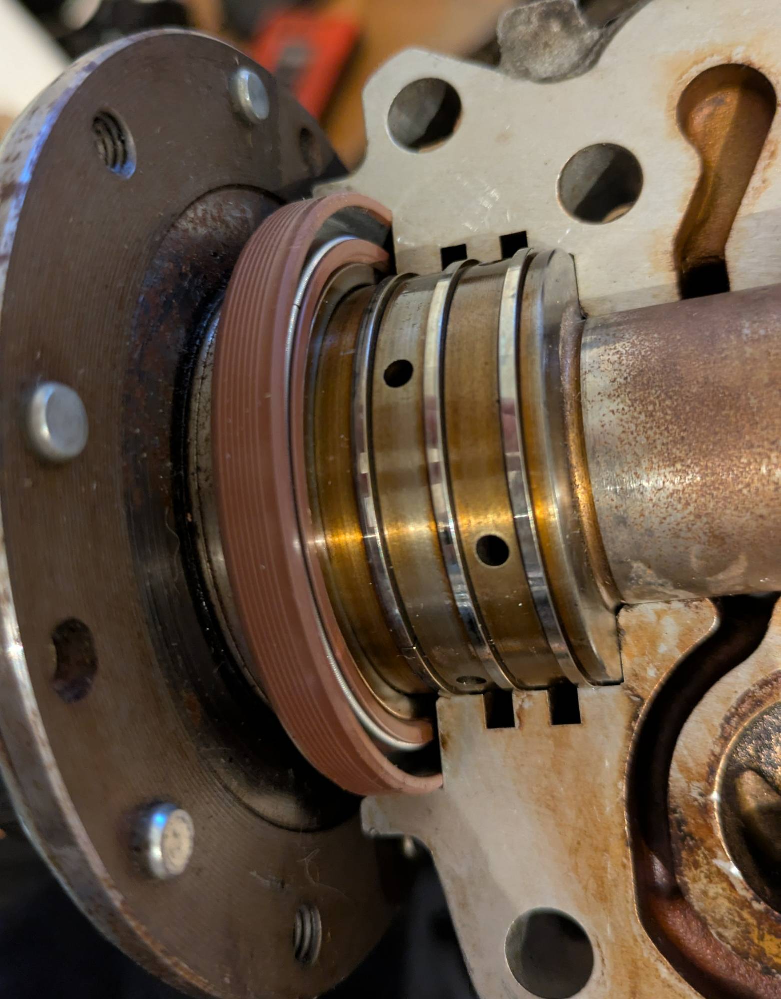

crasbe wrote: 24 Apr 2025, 16:11 Fortunately one of the cam shafts was still in it's original position and as you can see, the seal should not be pushed all the way in (at least on the B5254FS) as that would block the oil return channels (if they are not already blocked by oil coal that is...)
As you can see, the oil passage on the top of the picture would be blocked.
I don't know if that is also valid for the later engines, if they have the same return ports.
The rear seal can be pushed all the way in though, as it has a separate cavity, as you can see in the cut section:

So the new (to me) valve cover arrived from East Europe and it appears like the seals are not pushed in all the way either, judging by oil stains. They seem to sit flush with the housing originally. However the newer head does not seem to have the same type of oil return channels, so the seal can be pushed all the way in.

However in this case, it really might not be a good idea to push the seal in all the way or much further than original, the wear edge is quite close to the chamfer of the VVT unit:

Yesterday I finally changed the cam seal and before taking it out I measured how deep it sat. About 1mm:
Also, the drain hole won't be covered by the seal, so you could push it in all the way. However it's likely that the sealing lip sits past the VVT unit then.
This is the tool in action. However I ended up using the +1mm tool, because with RTV, the seal popped right back out.
