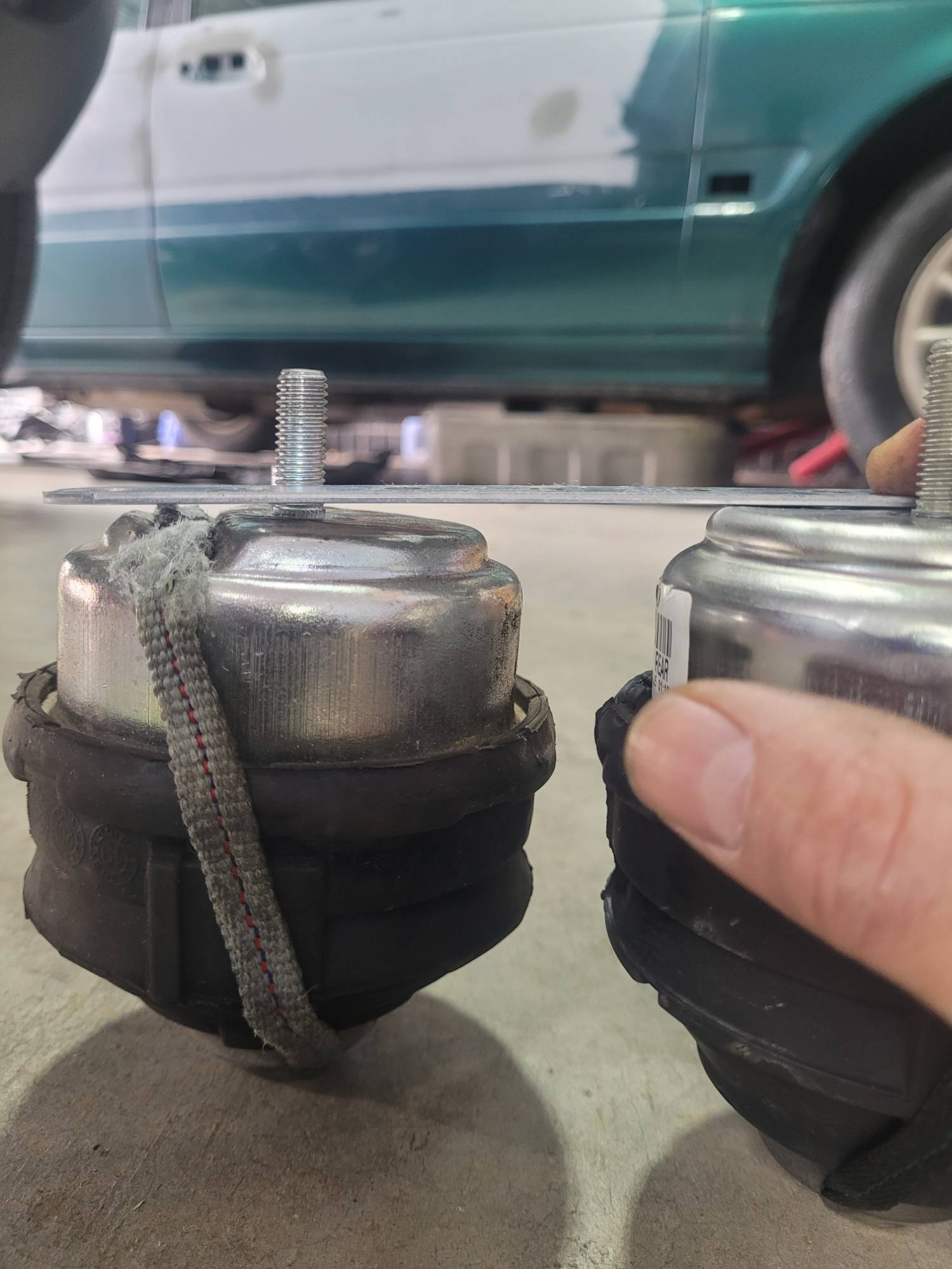

3) Discovered the rear mount wasn't holding vacuum. Bought an OE genuine one. Upon comparing the two, the aftermarket one was 10mm shorter in height and overall appeared about 90% in size of the OE one. Fitted it and the difference was minimal. At least it wasn't leaking vacuum anymore..

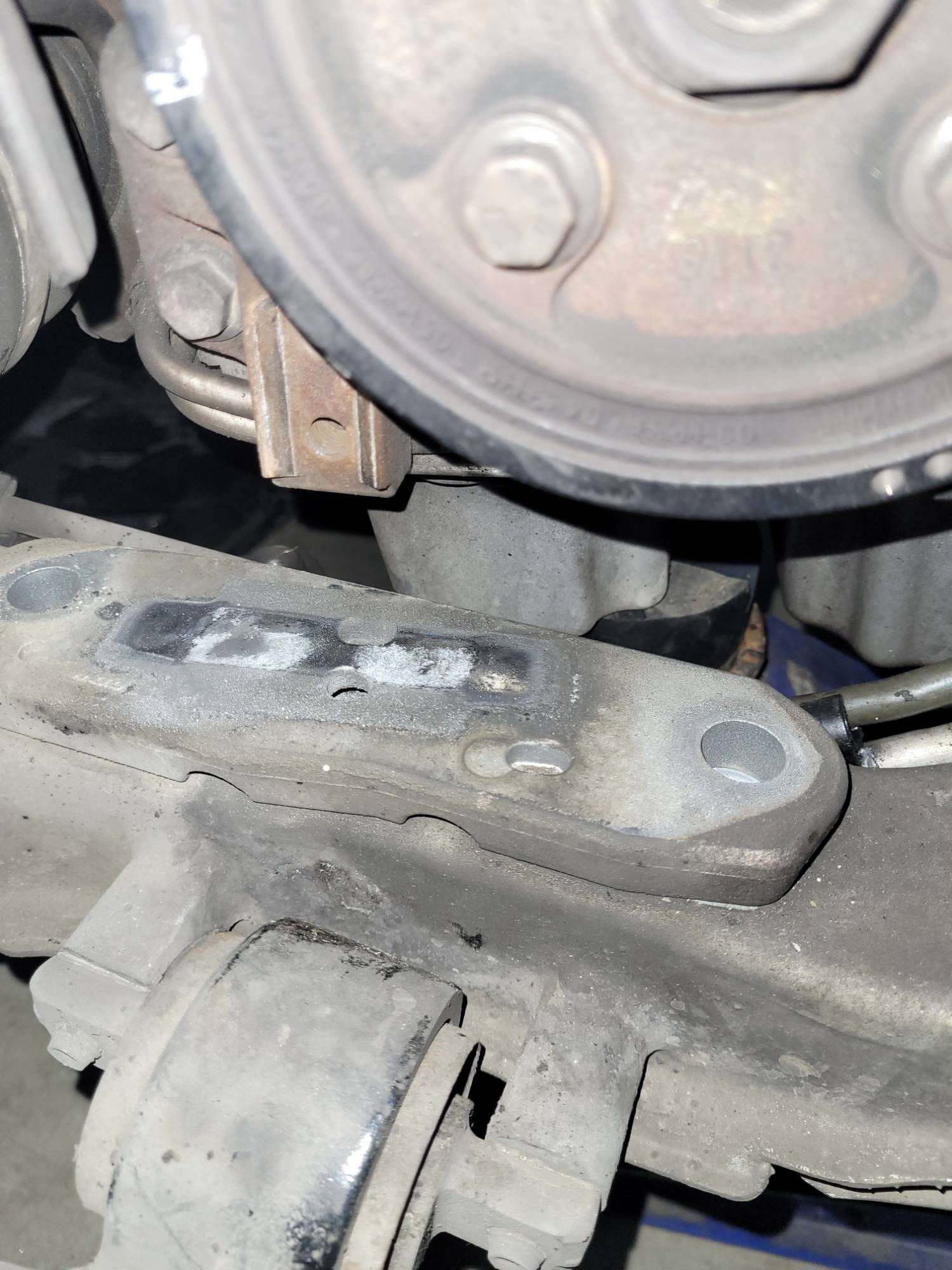

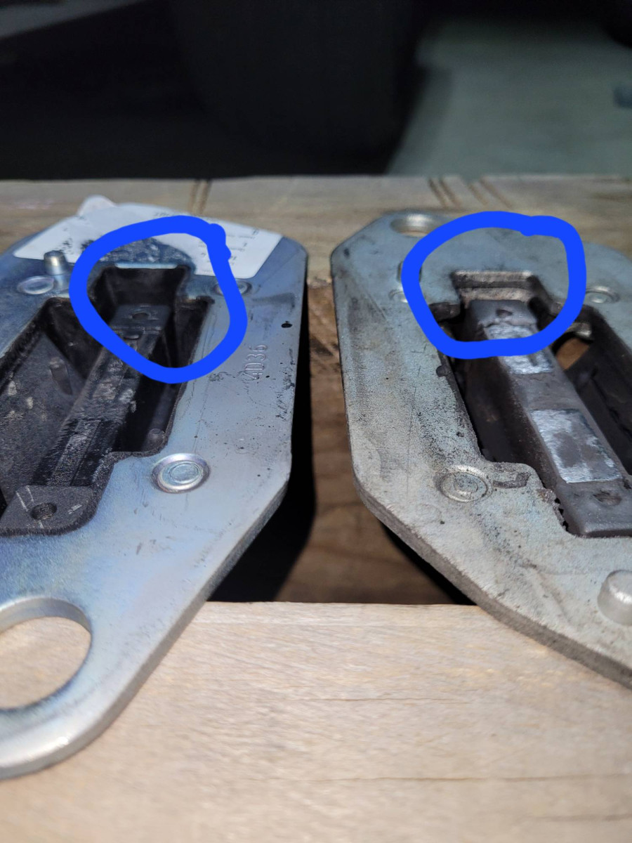

4) I managed to convince myself that despite the r/h mount looking fine and intact, the groan under acceleration, particularly when turning right could be the issue. I bought an OE genuine one to replace it. Wow!! When I removed it. The issue was obvious. There was aluminium metal dust settled beneath it. The inner metal structure of the mount is not inset to the mount as far as the OE one. The inner part of the mount was resting on the chassis!! Also the rubber is far too soft and nowhere near the density and quality of the OE mount.
