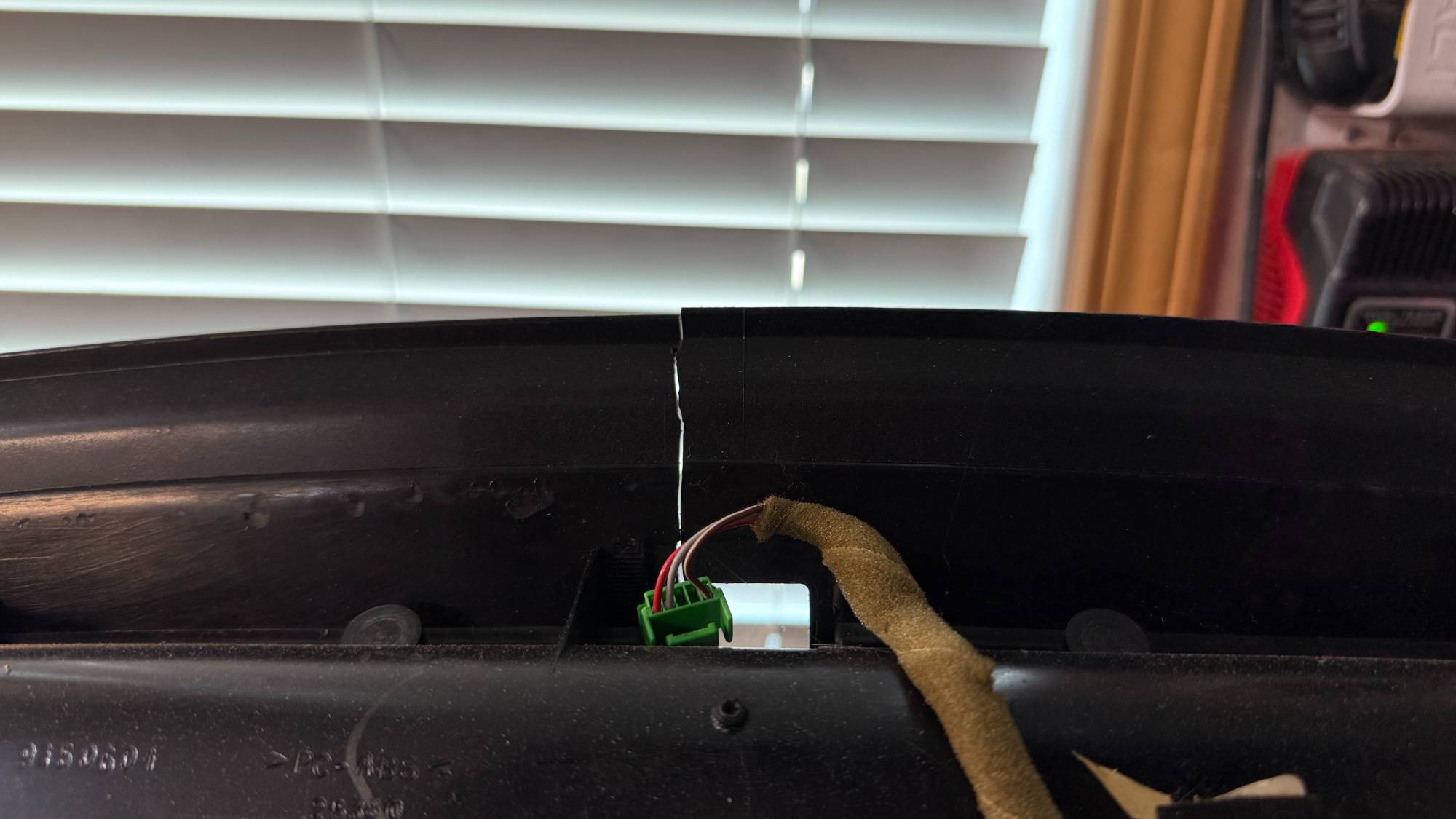

Hey everyone,
I’ve recently pulled the dash on my 1998 S70 to replace some cracked trim around the instrument cluster left by the previous owner. While it’s out, I’m planning to repair a crack in the dash itself and reinforce a few broken mounting tabs using JB-Weld and a plastic-welder gun. Since I probably won’t have another chance to access everything behind there for a while, I want to make the most of this teardown.
Has anyone taken advantage of this moment to pull or service the heater core or evaporator? I’m curious whether it’s worth draining the system now and installing a fresh cabin air filter or tackling any HVAC seals before things freeze up next winter. On that note, are the blend-door actuators and vacuum lines easy to inspect or lubricate while the dash is down? I’d rather fix any sticking doors or leaks now than chase weird temperature swings later.

Cabin air filter is under the hood near the windshield wiper. Heater core is serviced through the kick panel, no dash removal necessary. Now would be a good time to replace any burnt out bulbs on the instrument cluster, including the clock backlight bulbs. Would also be a good time to install a trip computer if you have the inclination and can get the parts. Not sure how the A/C evaporator is accessed - if you can get at it, a pre-emptive replacement might be a good idea!
