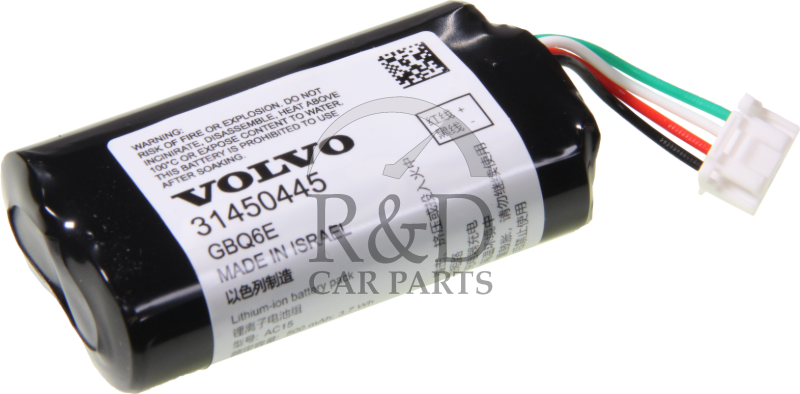

My wife's 2018 XC60 T6 Momentum is in for service on the AC and the "Volvo on call service" error code. Confirmed the VCM battery is bad.
They want $875 to fix it. I have been looking around for tip n tricks with not much luck thought I'd ask you all?

This is something I'd do over $875 at the dealer. Passenger side rear wheel arch, looks like a small plastic black briefcase. Once you're in there:
Also -> Amazon link

I think the TSB also calls for software update at the same time. Dealer should probably charge 100-150 for that.
