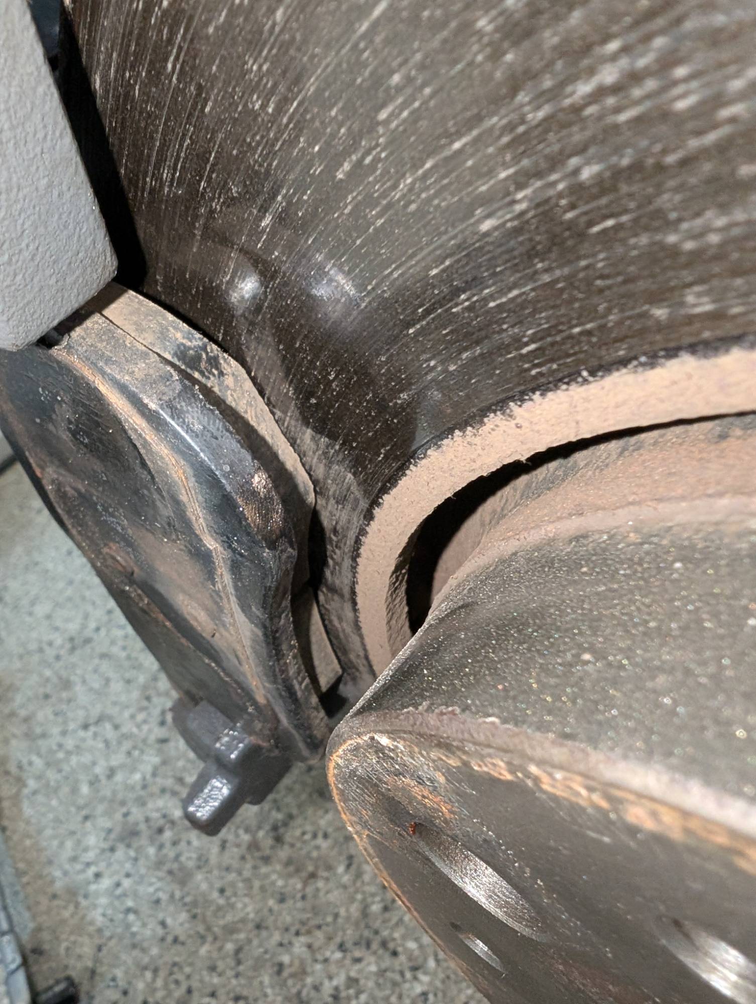

So again I answer my own question. So the caliper brackets that came with these reman units are wrong they are for fitting the 305mm diameter rotors and I'm convinced they would not fit inside the original rims as were fitted to this car from new. We bought the car from Volvo in 2011 for 50k miles on it and have since fitted several new rotors due to a Volvo quality issue causing warping, but all were the same 286mm rotors. I tried fitting the brackets incase I was wrong, but it moves the pads about 10mm further out and the pad then overlaps the edge of the rotor.

The picture below shows what happens when you try to fit the 305mm bracket. You can see the imprint of the wear face would move outwards if you fitted the wrong bracket.
Wrong bracket for 286mm rotor
