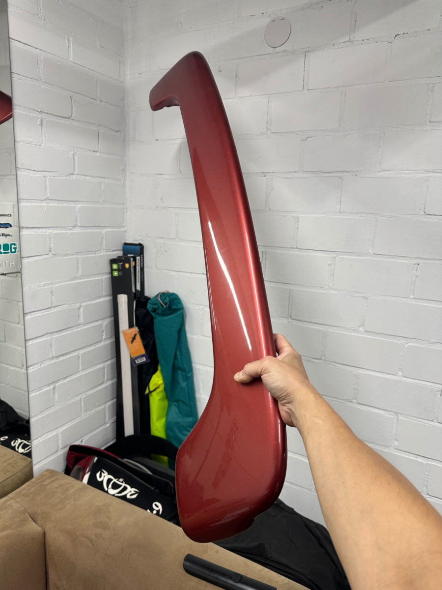

I hope you got the mounting brackets with that! They look really good when fitted to your wagon.

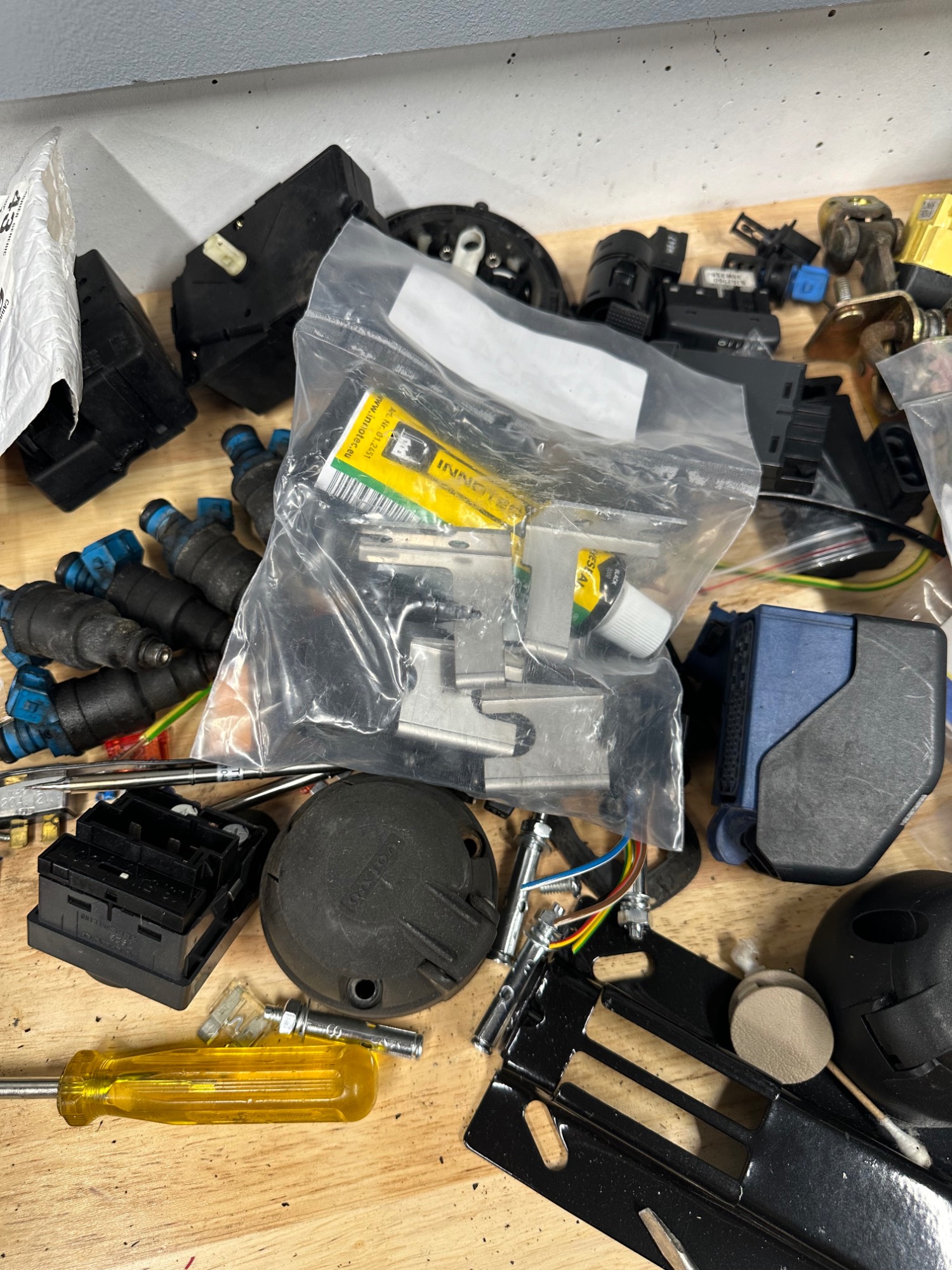

Yessir. Purchased through skandix. The mounting kit was more expensive than the spoiler.
The brackets arrived with sealing/adhesive kit to glue the spoiler to the tailgate.
But I’m probably going to grab some double sided tape together with the brackets.

Most of the ones I have seen removed have double sided tape and the 2 mounting metal brackets, one each end.
