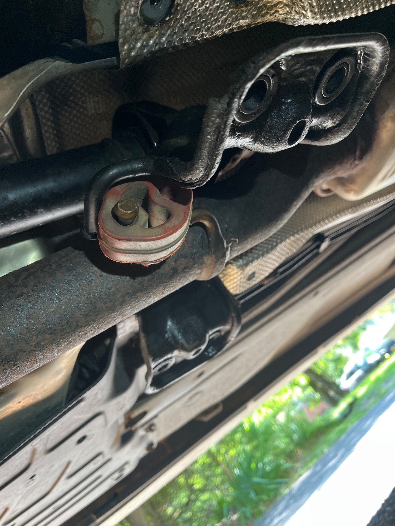

Do you know if the rear driveshaft carrier bracket can be installed by only removing the rubber exhaust hangers on a 2011 xc70 t6 or similar?
My bracket was rusted out and fell apart so I didn’t have to dismantle anything to remove it . But on installing a new one it’s so darn tight fitting, the bracket won’t go over the large exhaust tube and clear the opposite side of the tunnel. There must be a trick .

Success ! Removed ALL rubber hangers and that gave just enough room to squeeze the bracket over the exhaust tube .
