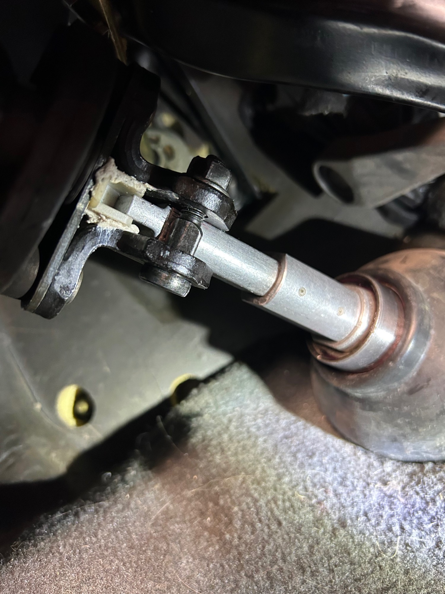

I woke up in the night and had an idea -
Go back inside the car, undo that little keeper bolt, which lets the lower shaft slide down towards the rack. Get that joint connected underneath. Back into the car to reconnect that u-joint, as the upper shaft from the wheel seems to have some up-down sliding movement.

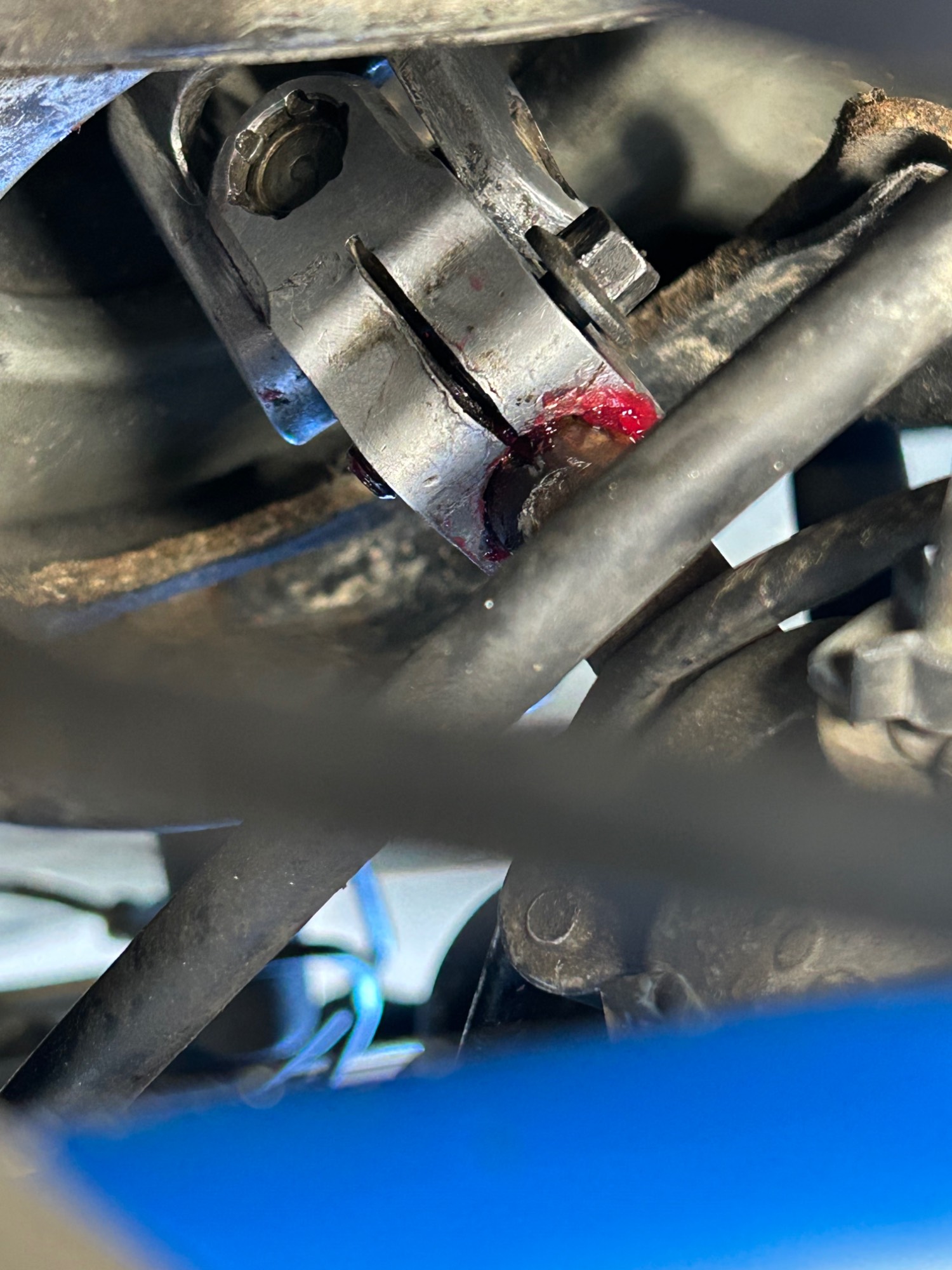

3/8 of an inch! My KINGDOM for 3/8 of an inch! I’m pulling and pushing and leeevering with a long needle nose with bent tip.
BlackBart
Posts: 6501
Joined: 10 December 2016
Has thanked: 927 times
Been thanked: 884 times
Post by BlackBart »
Ya know when you have something almost on, that you’ve been fighting - pulling with all your weight, prying, making a loop out of steel cable and using a crow bar for leverage?
It’s “almost there,” 1/4”, you can’t quit, you can’t lose the progress you’ve made!
So of course I took it all apart. There had to be a physical reason it wouldn’t close, not pure strength. I looked at corrosion on the aluminum end, scoring, burrs, galling - some of it from bashing together raising and lowering the subframe, some from the subframe weight hanging on a small bolt.
So I got out some tiny fine files - round, triangle, flat - and cleaned the opening and shaft up and smoothed all contact edges.
After smoothing up both ends and greasing them up, it just slipped together PLOP. Now with arms jammed up in there I am threading in the pinch bolt 3 degrees at a time with a tiny wrench.

DONE!
Bolt is bottomed on slightly mangled threads - I won’t force it in aluminum.
Put some caulk on that little white plastic clip to hold it up there while I got the top of the shaft in place. Bearing collar re-greased and popped into the boot.
