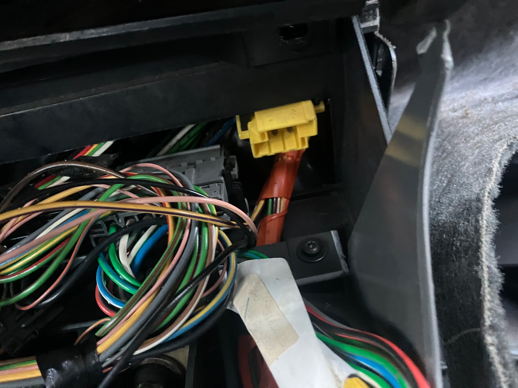

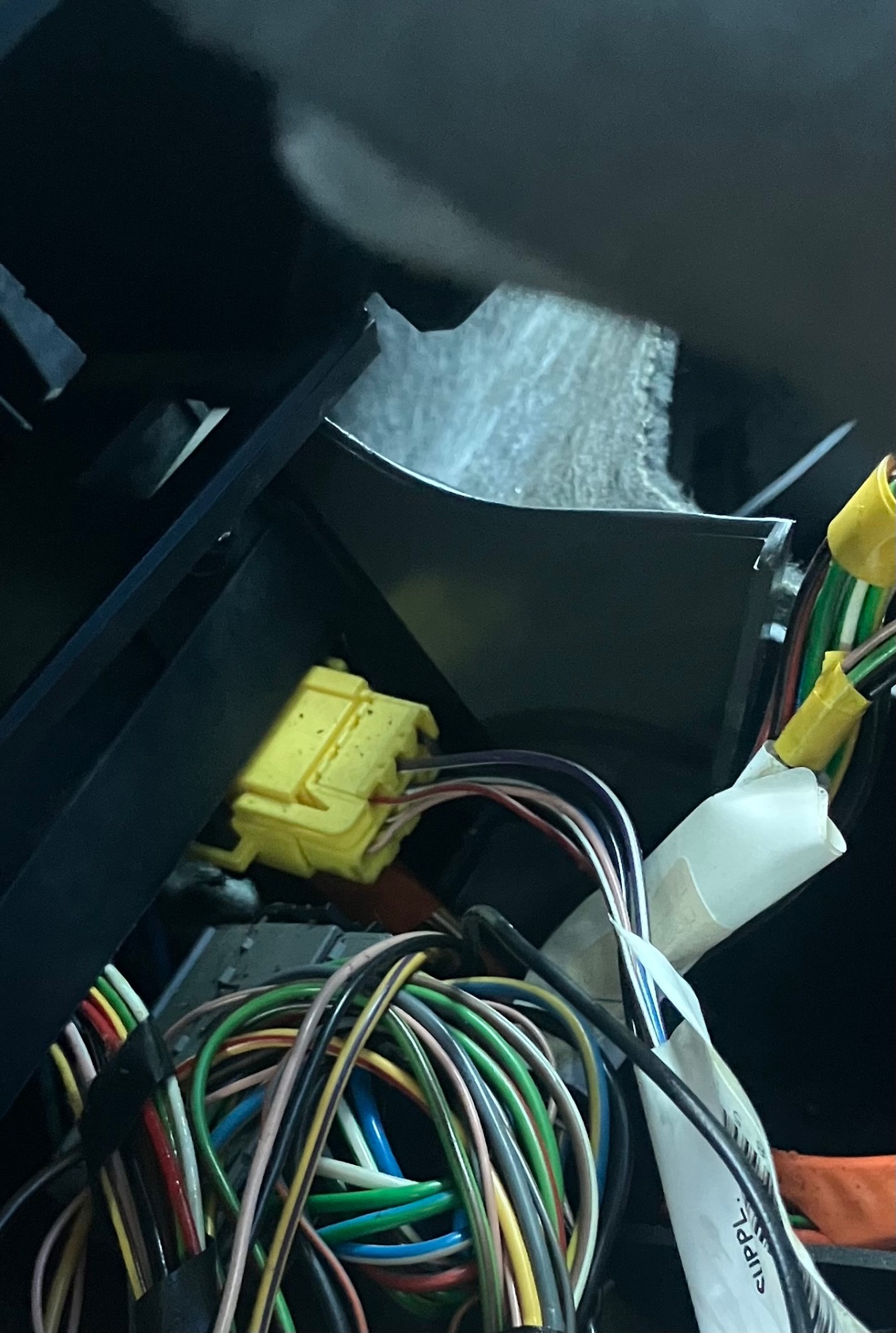

On fcp euros page about rear seat heaters on the s70. Seems to be similar in layout and setup. But will obviously be a 12v wire on each side. That hopefully runs back to the center console as stated which would then make install way easier to just run it from the center console then under the carpet to the rear seats instead of up and under the dash then down the doorsThe heating pads are wired in series, with the chain ending at a ground bolt under the driver's side rear cushion. The whole seat system is fed by a single 12v wire that comes from the center console. This means that if one pad fails, (even a minuscule section of heating element) the entire system is rendered useless. There is also thermostat in each seat bottom pad that will cut power to the system if they get too hot. The system really is quite simple, and I like how Volvo designed it without utilizing a mass of wires to implement it. Every car was built with holes for the wiring harness clips in the body, and the seat pads have holes pre-cut for each pad's wires.

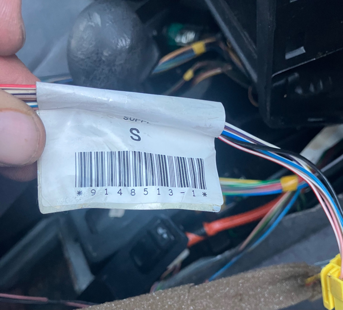

So the harness for the switches runs under the center console. Assuming other 850s have the an empty yellow plug that’s where it would go.
Still seems as if the 12v for the seats is wired into the dash somewhere
