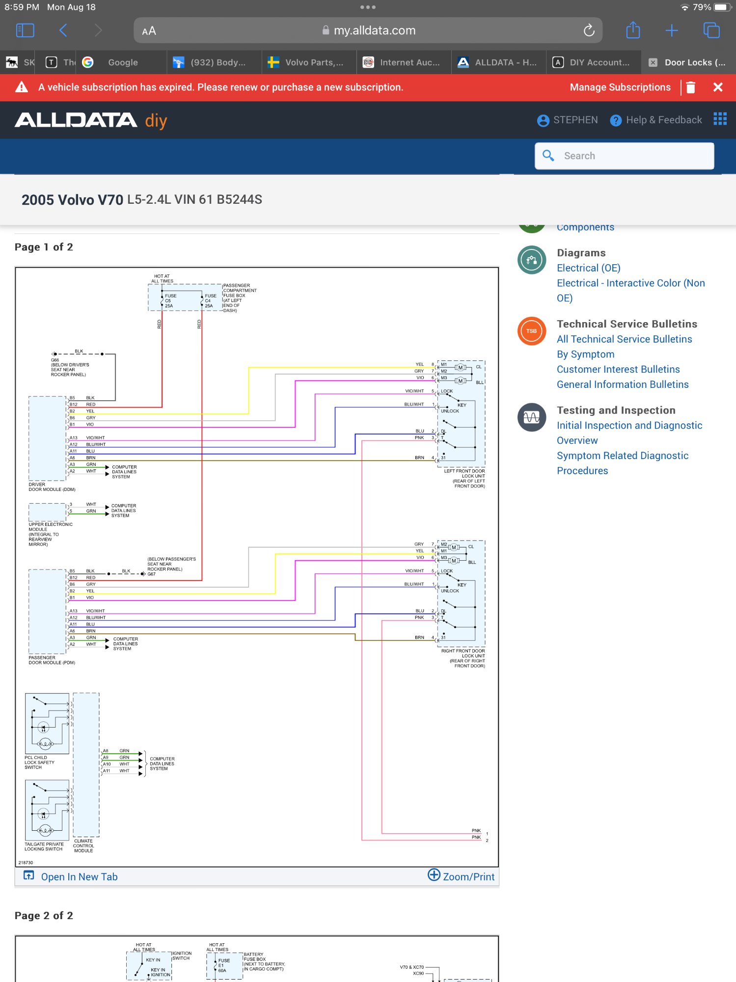

I would be hard pressed not to take that to the largest Volvo dealer amd body shop in town. Remember p2 door lock modules are onthe CANBUS so electronics are involved.

I thought the door handle/ lock cylinder assembly was all mechanical. A few years ago I replaced the driver door on Ikea and swapped this over from the old door, and I don't recall any cables going to this. Are you sure?abscate wrote: 17 Aug 2025, 15:19 I would be hard pressed not to take that to the largest Volvo dealer amd body shop in town. Remember p2 door lock modules are onthe CANBUS so electronics are involved.
The actual door lock assembly maybe on the CANBUS, but that can be swapped over if they decide to install a new door (which I highly doubt will be needed)

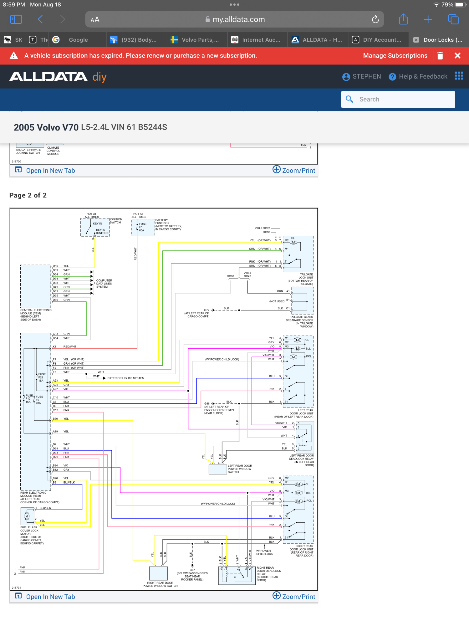

850 LPT wrote: 17 Aug 2025, 15:40I thought the door handle/ lock cylinder assembly was all mechanical. A few years ago I replaced the driver door on Ikea and swapped this over from the old door, and I don't recall any cables going to this. Are you sure?abscate wrote: 17 Aug 2025, 15:19 I would be hard pressed not to take that to the largest Volvo dealer amd body shop in town. Remember p2 door lock modules are onthe CANBUS so electronics are involved.
They are definitely on CANBUS but I don’t think there is VIN pinning or that foolishness.
2005 diagrams attached
