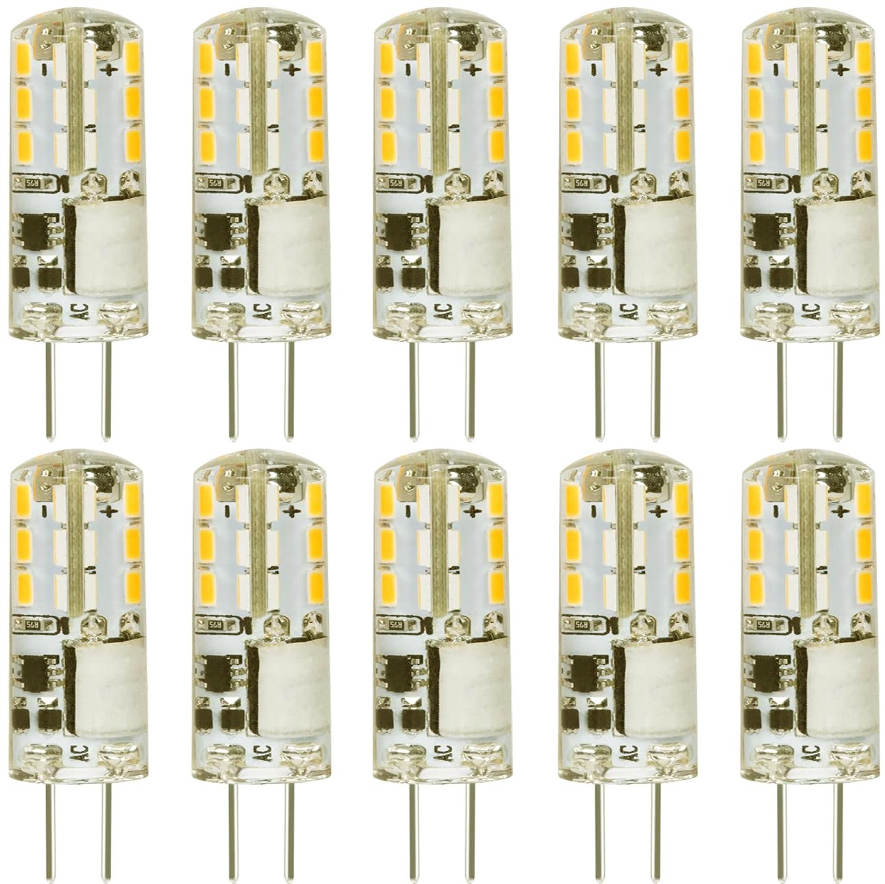

If you remember this post from 3 years ago, it's when I got my step lights working. They'd never been hooked up to actual good old 12V, or any volts. As far as I could tell, they'd never been used.
Sometime in the last 12 months they quit, and my tenant (I rent the house now) asked about them. Hm. Time to investigate.
Turns out they'd been seriously damaged by water, and probably a few dozen freeze/thaw cycles. I should have sealed those grilles in 2021.
So I look and look online for the same product of LED lights, but can't find a thing like them. My speculation is that they're probably from 10 or so years ago, and have long been retired from production. Just look at how they're designed: an actual little chip board with no weatherproofing. I couldn't even get close to that style in form factor. The whole enchilada was just forgotten by industry. So I got these to replace them.
I should have gotten the bases too, but if you're going to do something incorrectly the first time, and you're me, you're going to do it incorrectly a second because consistency is king here.
These replacements are 100x more likely to survive water/cycles... the enclosing material is a very durable rubbery type, and they're tough. Excepting the pins, I'd be shocked if you couldn't run these over with a car a time or two and they'd still work.
So I soldered them up and the step lights work again, and I sealed the grilles very well. Happy tenant.
Question: the solder was not happy touching and staying on the wires. What am I doing wrong?

You have to remove oxidation from the pins by scraping with a sharp blade. Pretinning is best

Thanks Steve. I also found this given your oxidation keyword: "To de-oxidize wires for soldering, use a chemical solution like a vinegar and salt mixture to clean the copper, followed by a neutralizing soak in a baking soda and water solution. Alternatively, you can use a muriatic acid solution, but be sure to neutralize it properly, and clean with isopropyl alcohol before soldering."

Copper you can scrape to shiny metal, then tin. I found my soldering technique got a lot better with a station with adjustable heat settings.

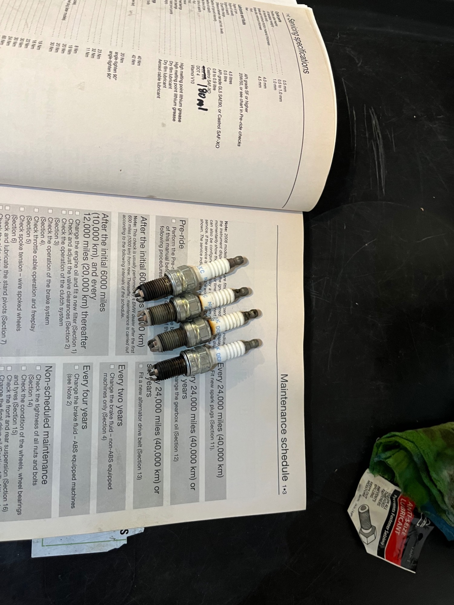

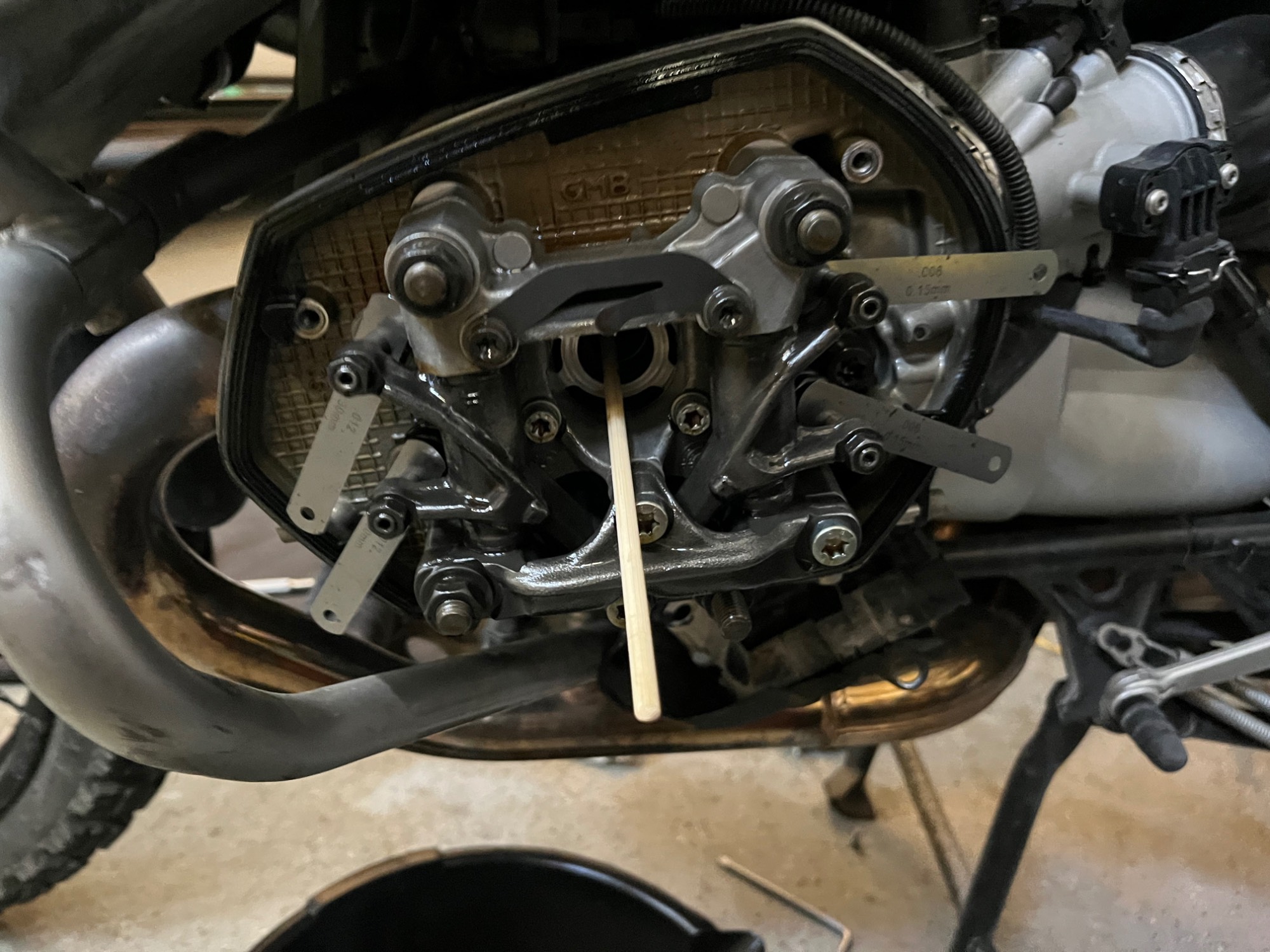

My BMW motorcycle is at 60k miles so valve check and new spark plug time. Pretty easy access on the boxer twin. Chopsticks make an easy top dead center visual guide.

That's a great idea! I was planning on a wooden pencil.Krons wrote: 18 Oct 2025, 14:10 Pretty easy access on the boxer twin. Chopsticks make an easy top dead center visual guide.
