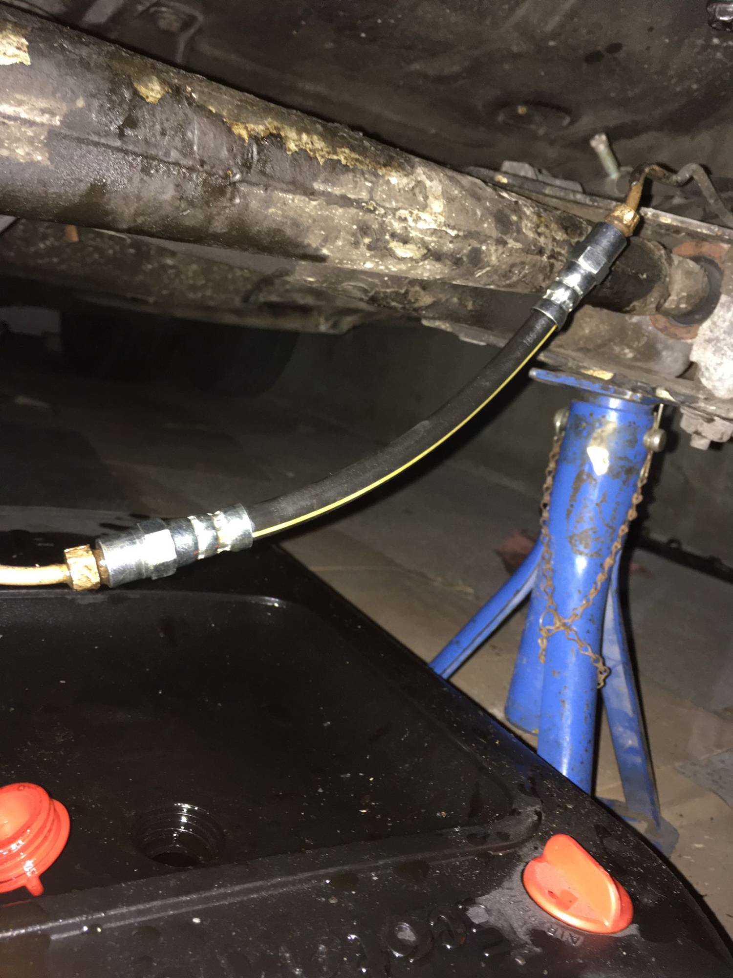

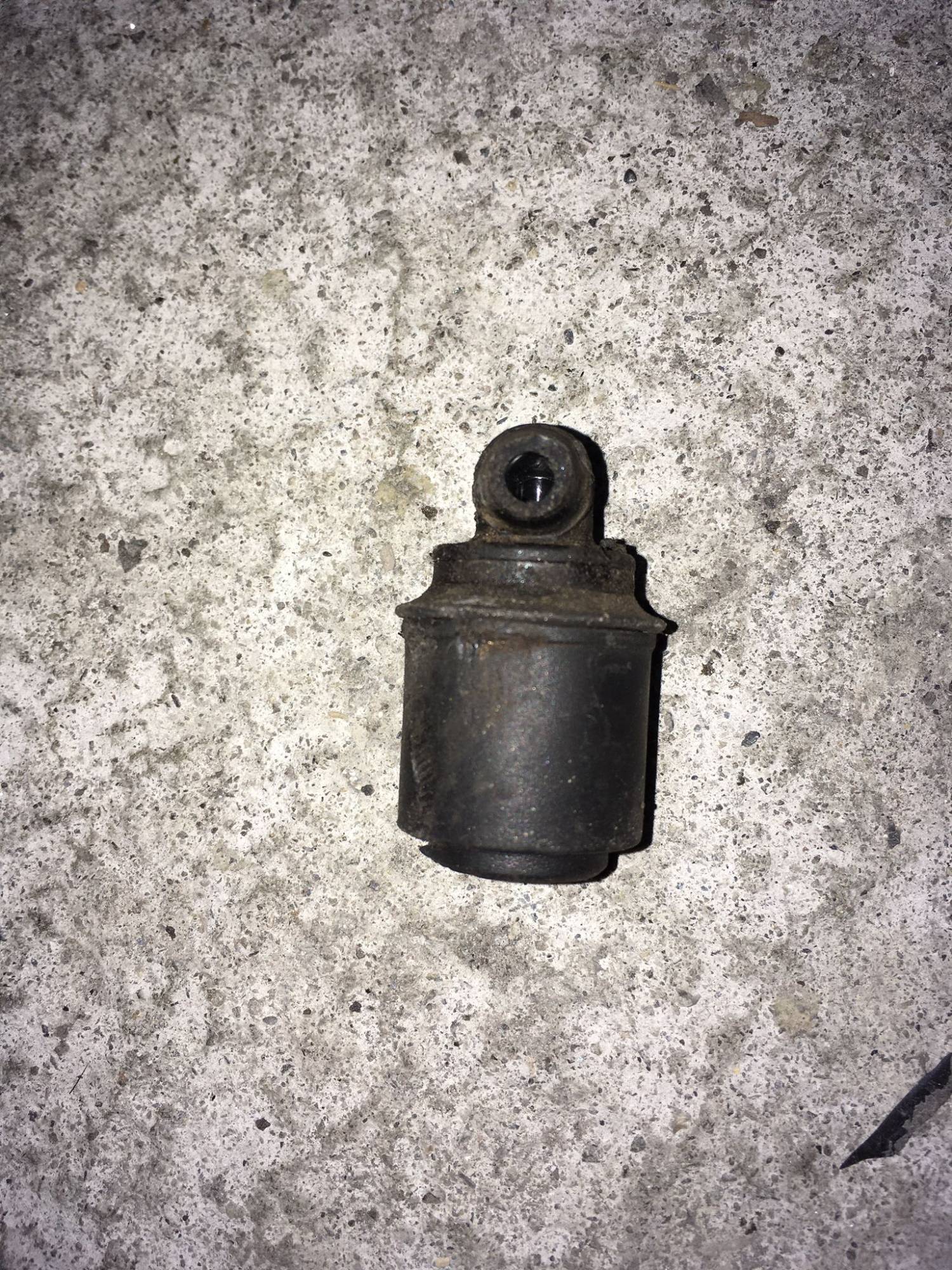

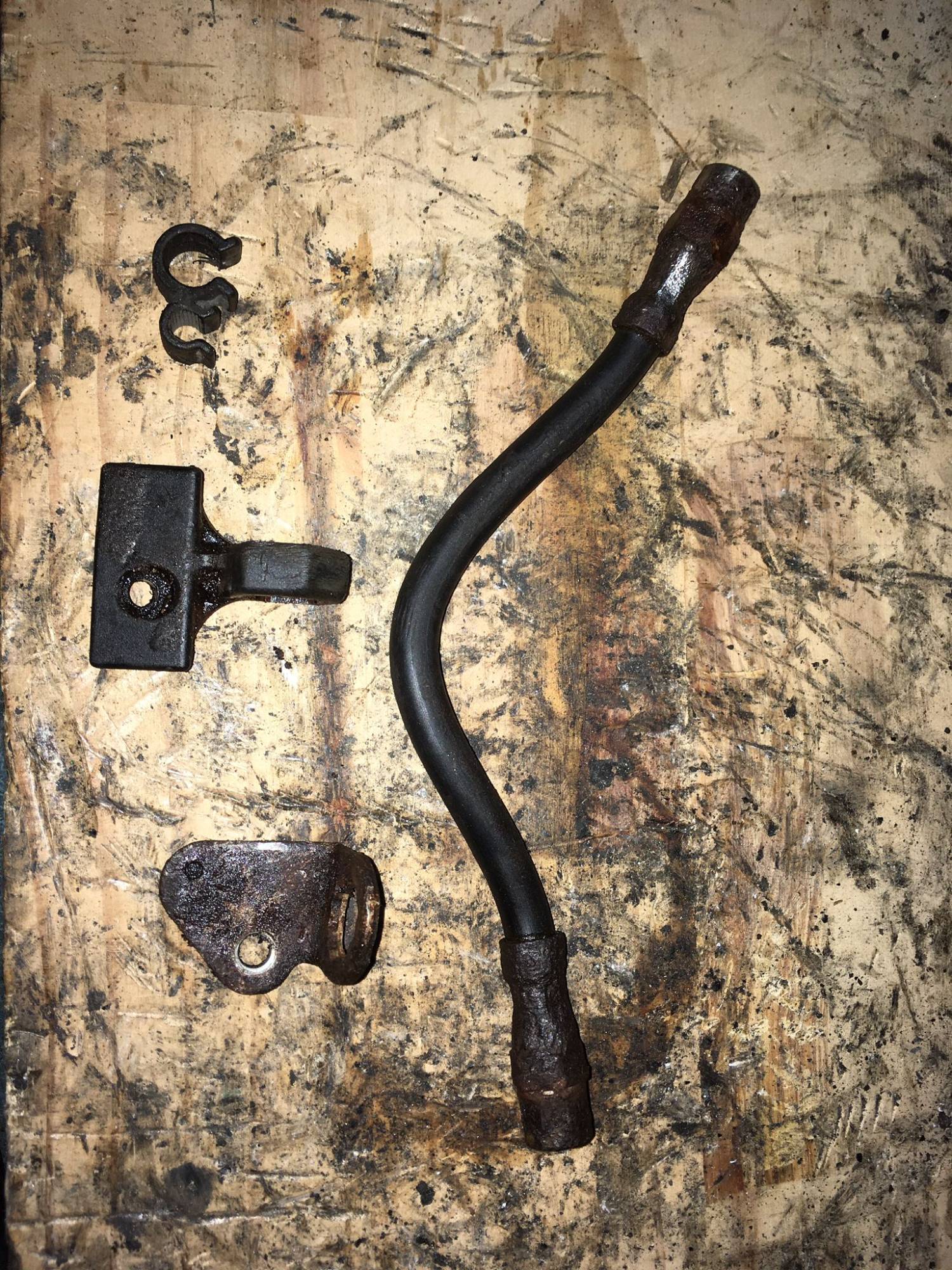

I continue with my rear brakes... Here's the result. A PITA. Rust everywhere. Steels hoses are ok, but tscrews have suffer a bit i must say. I've cleaned every part, putted some rust killer, and let it dry. Tomorrow, some black paint, and i will be good to go !

The rear flexi-hoses are a real challenge, in particular the one on the top of the rear axle. Well done!

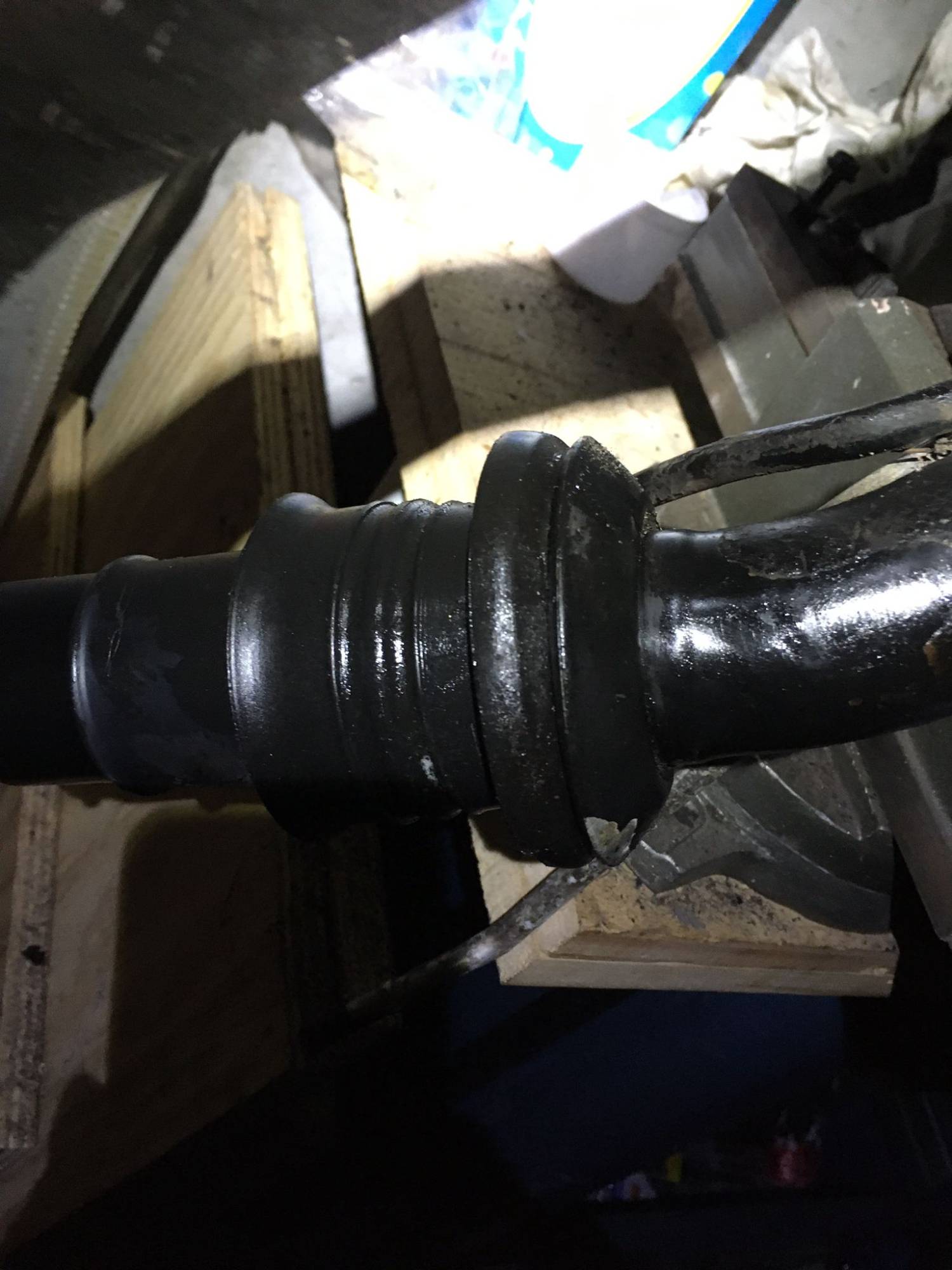

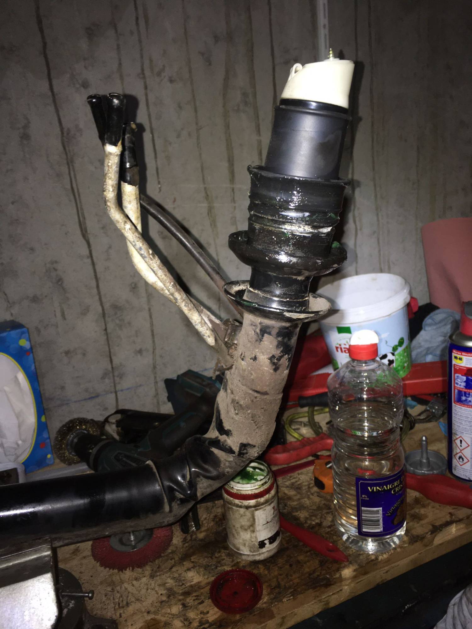

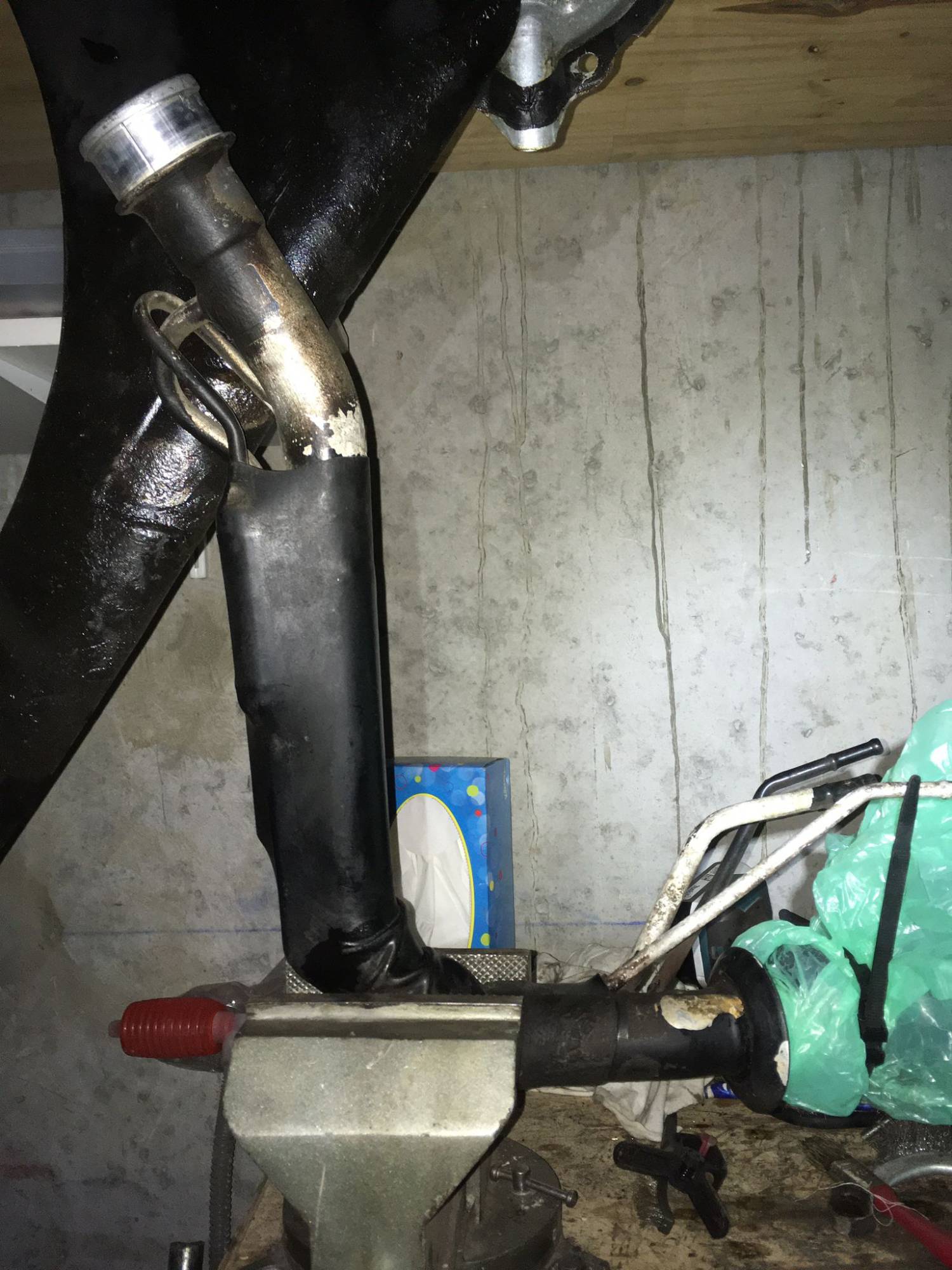

Continue to repair my 850. Today, I've tried to disconnect the fuel tank. The both hoses didn't want to come and they broke... I prefer not to speak about fuel hoses...
The outer size of the the nipple on the top of the fuel pump is 9mm. Can i use these replacements parts ? Or have someone another idea to propose ?
I've used a oil filter tool to get the fuel pump "screw" out to inspect it. No issue. I've disassembled the metal hose to feed the tank, cleaned every part as much as i could, putted some grease on rubber parts, and assembled back. No issue. Last question : one hose goes from the fuel pump to the fuel filter. Where goes the second one (i've forgotten to have a look). May be some knows. I need to buy fuel hoses Ø 9 mm, and so i don't know how long this hose should be.

Manalov, as per your picture from the dealer, the 2 pipes. One is the feed to the fuel rail at the front from the pump via the fuel filter, and the 2nd it the return from the engine to the tank. I can't recall the specifics of the pipes other than them being routed along the channel under the floor.

Salut Neil !scot850 wrote: ↑11 Oct 2025, 08:35 Manalov, as per your picture from the dealer, the 2 pipes. One is the feed to the fuel rail at the front from the pump via the fuel filter, and the 2nd it the return from the engine to the tank. I can't recall the specifics of the pipes other than them being routed along the channel under the floor.
You have had to tackle a long and painful challenge. Just be happy you have not had to deal with cars like Abscate and his friends on the Eastern side of the northern US! Great work!
Abscate, I can only agree with your statement. Hopefully the T5 will be resurrected soon!
Thousand thanks for your post, i appreciate. I agree your analysis about the way hoses get under the car. I discover everyday than the right tool makes the right job. These fuel hoses are hidden behind a plastic cover fixed by plastic screws, under the car, right side.... This car seems to be so "simple" to maintain. I've succeeded unscrewing the 2 connectors at the "exit" of the injection bracket. Some good penetrating oil, again, the right tool... I will get new hoses the week. I was wandering if it was a option to thread the hoses directly onto the fuel pump fittings. I suppose the 2 quick connectors may have a reason to have been installed there. Numbered dealers couldn't help me with new connectors because our fuel pump doesn't have a "throat" on their top. So i will finish to thread the hoses directly on the FP nipple...
