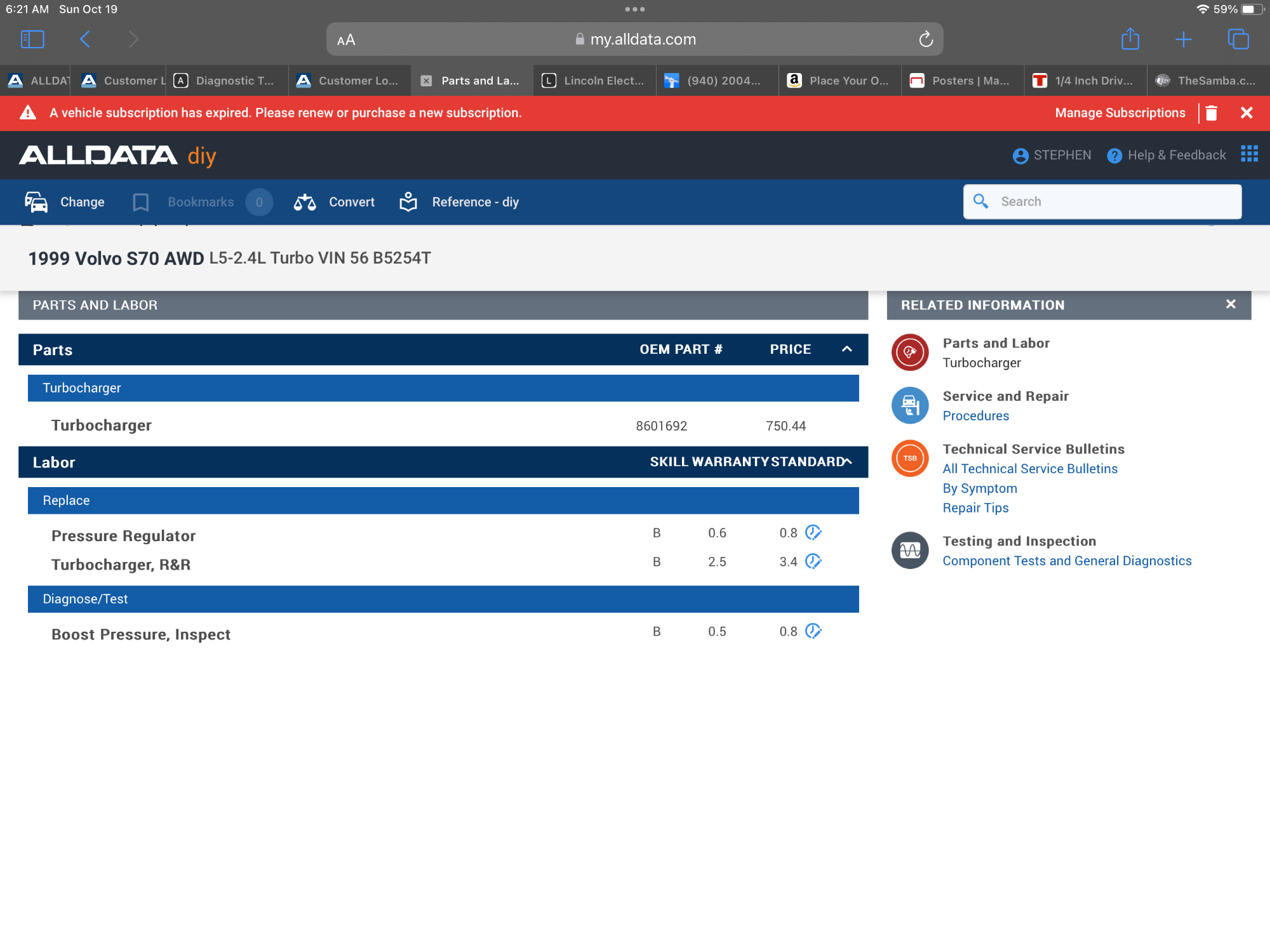

Posts: 36158
Joined: 17 Feb 2013, 17:54
Has thanked: 1611 times
Been thanked: 4074 times
For my 1999, 3.4 hours labor for turbo RR
Good used turbo is $200-250 from a wrecked vehicle.
