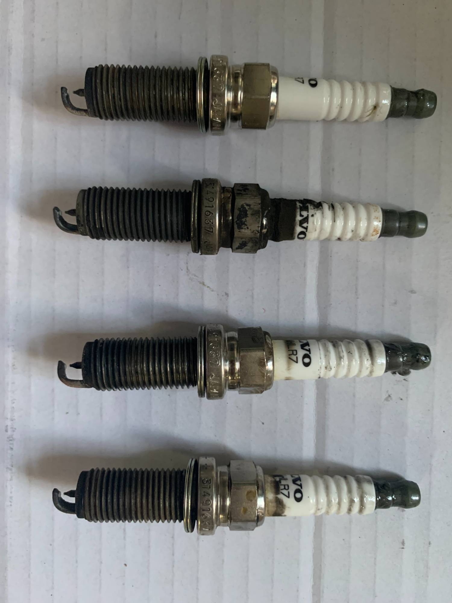

The spark plugs came off easy -- threaded to snug tight. The #2 spark plug (2nd from timing belt) was covered with excessive brown powdery substance, where 1, 3, 4 were cleaner burns. Why is it like this? Do send the oil to Blackstone for analysis?

The four spark plugs with 57,3xx miles.

Post by volvolugnut »
Top plug gap looks huge in photo. Unless newer Volvo gap spec is wider than P2 specs.
Have you checked gaps? Could cause misfire.

Post by xHeart »
volvolugnut wrote: 03 Oct 2025, 13:59 Top plug gap looks huge in photo. Unless newer Volvo gap spec is wider than P2 specs.
The car is running very well after spark plugs change during the recommended 60,000 miles service. Here is the oil report...
