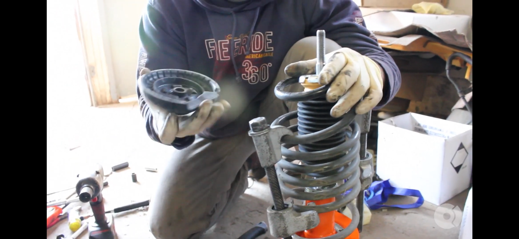

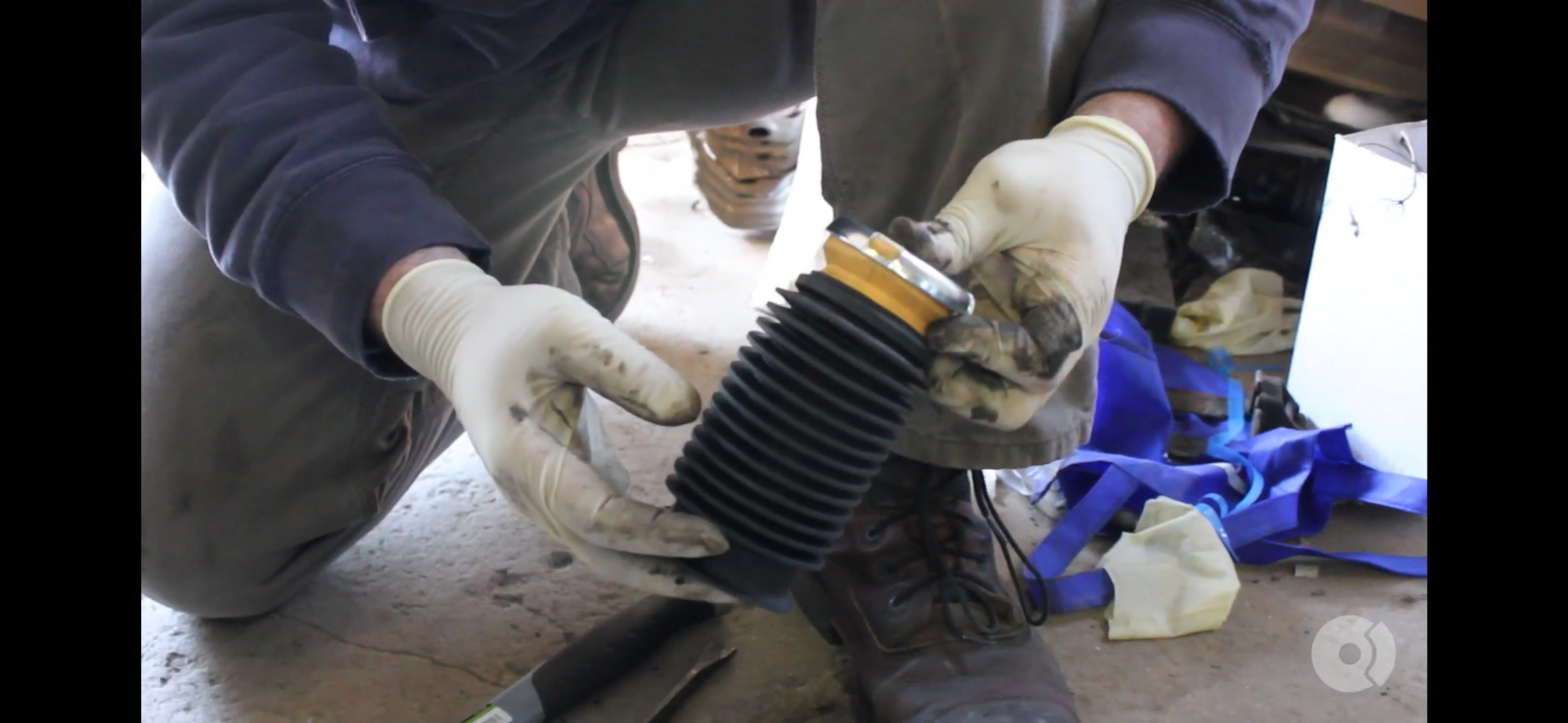

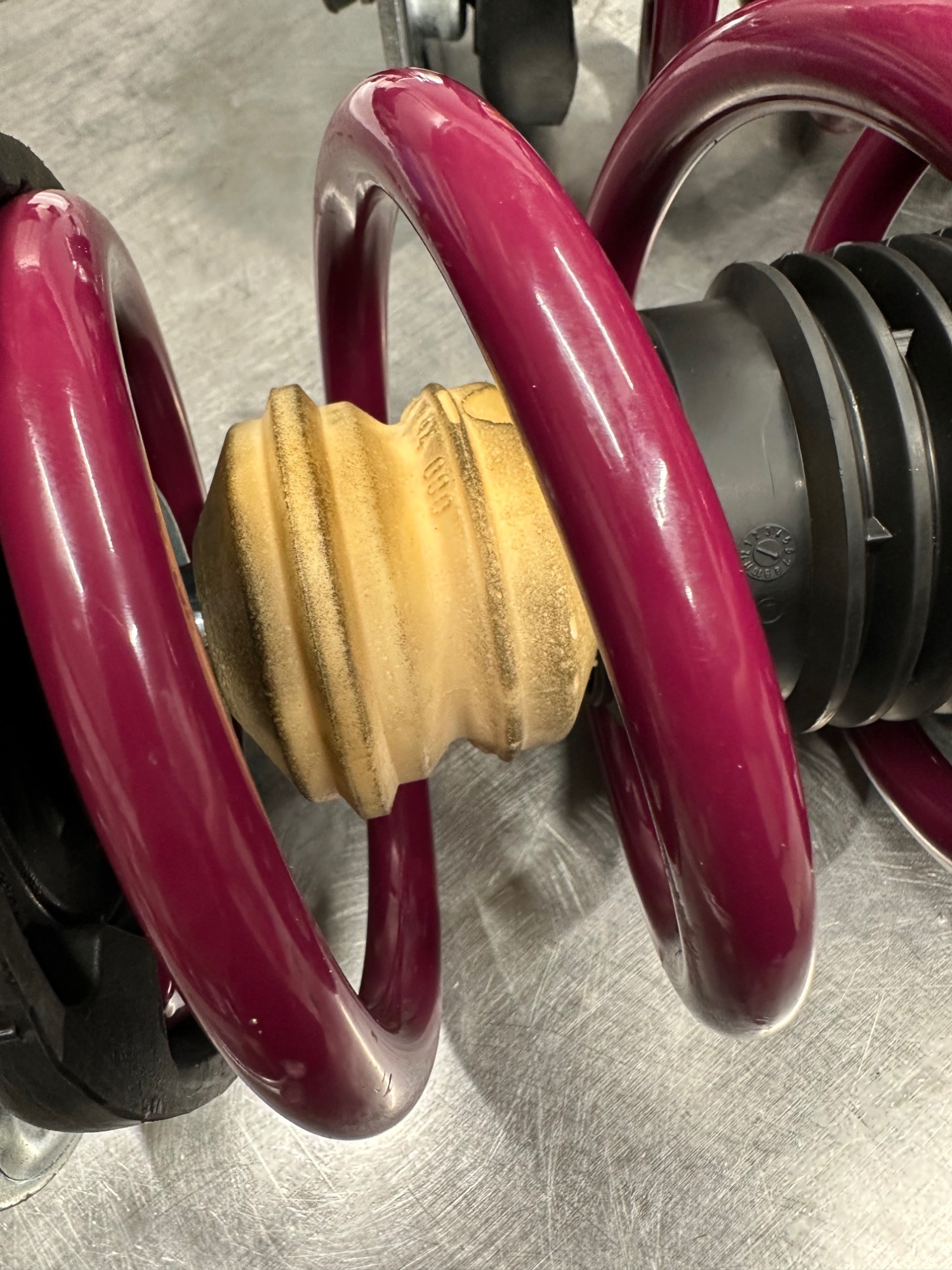

I went back to the mechanic and showed him this picture from a video.
He’s going to install it the right way and am able to pick it up tomorrow again.

Good catch on that! Leaving it the way they fitted it originally defeats having the boot.

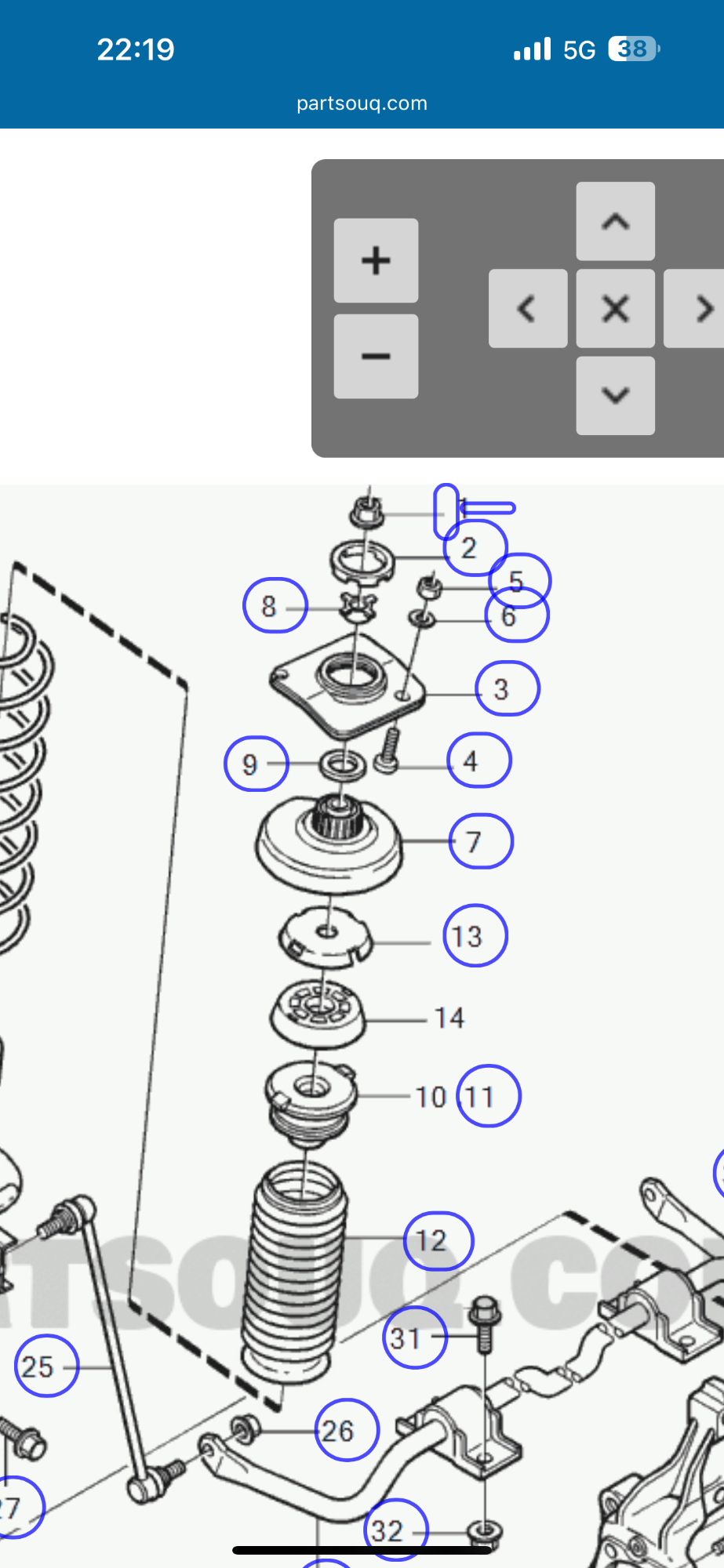

What I am not sure I am seeing is the star nut under the top plate. Maybe it is just as the units are not fitted and on the car?

scot850 wrote: 16 Dec 2025, 08:23 Good catch on that! Leaving it the way they fitted it originally defeats having the boot.
It should be under that special washer.
I don’t know how they installed it wrong, they had the parts diagram that I gave them.
If it’s wrong again and they refuse to work on it any further, I’ll be out 140 euros.
And 140 more to get the spring compressor and find some courage to do it myself. But that would be defeating the purpose of getting it professionally done.

Fingers crossed they got it right then! Once you get your car. it will have the weight on it and you should be able to see between the top cap and the bearing plate. Hopefully there is a star washer under there!

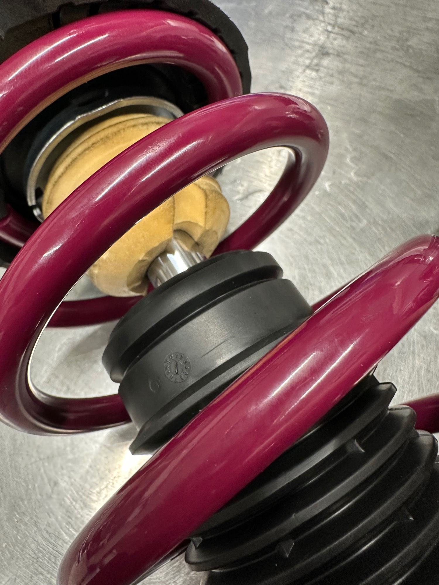

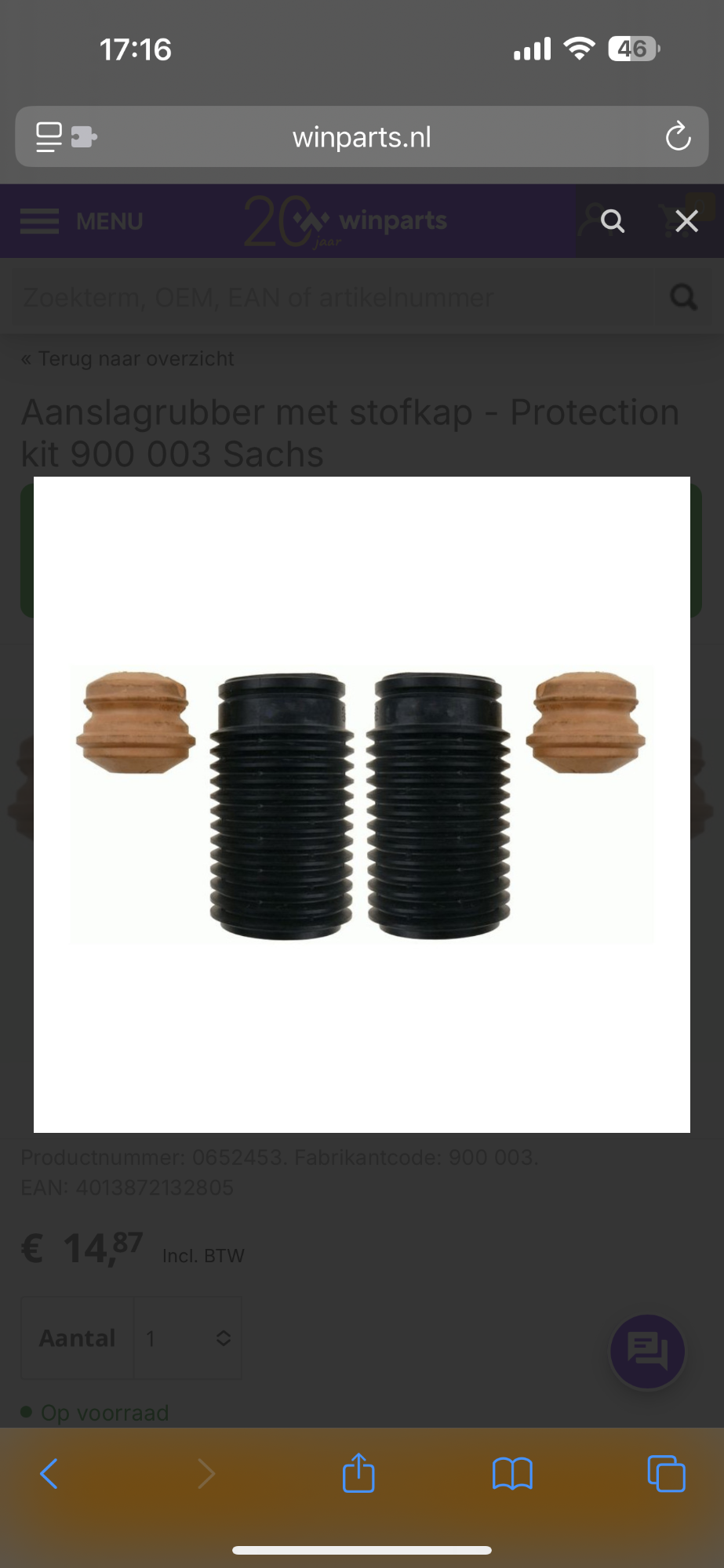

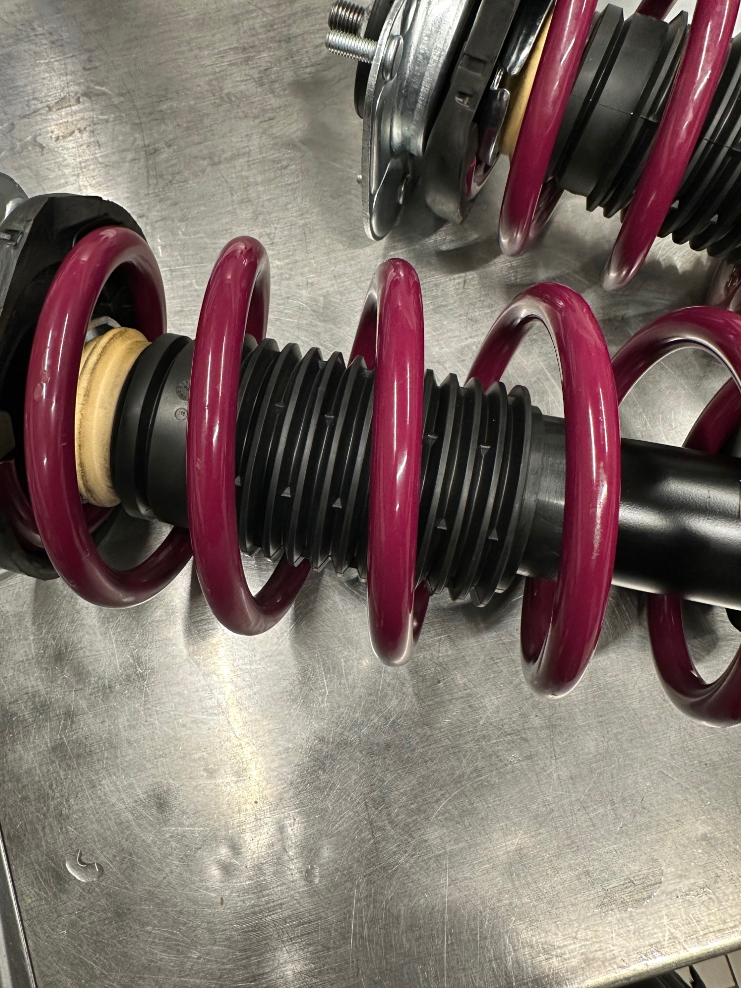

Alright. Seems like the bump stop doesn’t has tabs. I got this one from Sachs based on the part nr.
They flipped the bump stop around but not the sleeve. The sleeve is quite snug around the bump stop. It looks like the upper and lower diameter is the same.
But now I’m not sure what the correct orientation of the bump stop is.
What’s wisdom?
Leave as is or get a different sleeve and bumpstop or take it apart myself and only flip the seal around?
Sachs sleeve set
