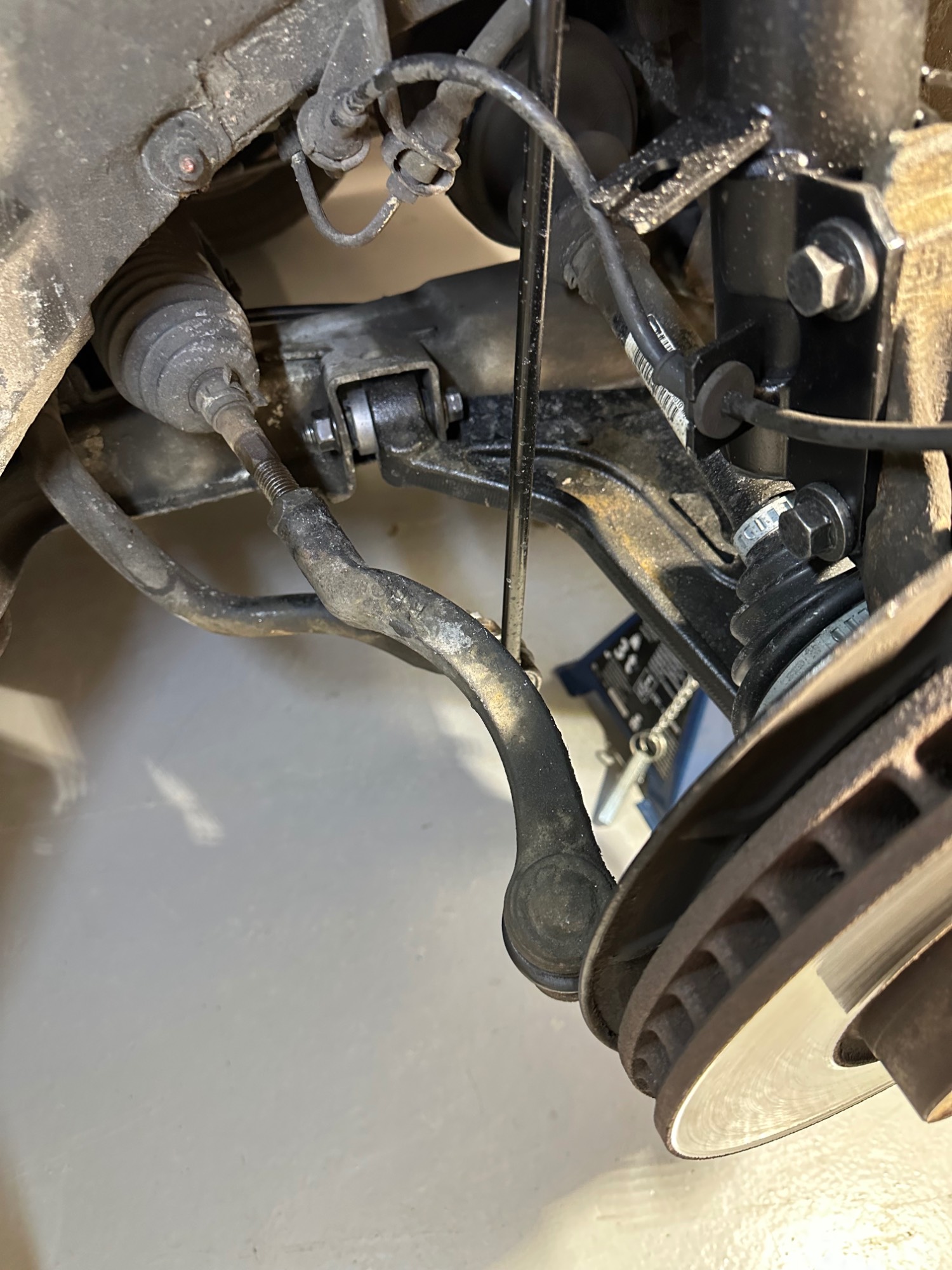

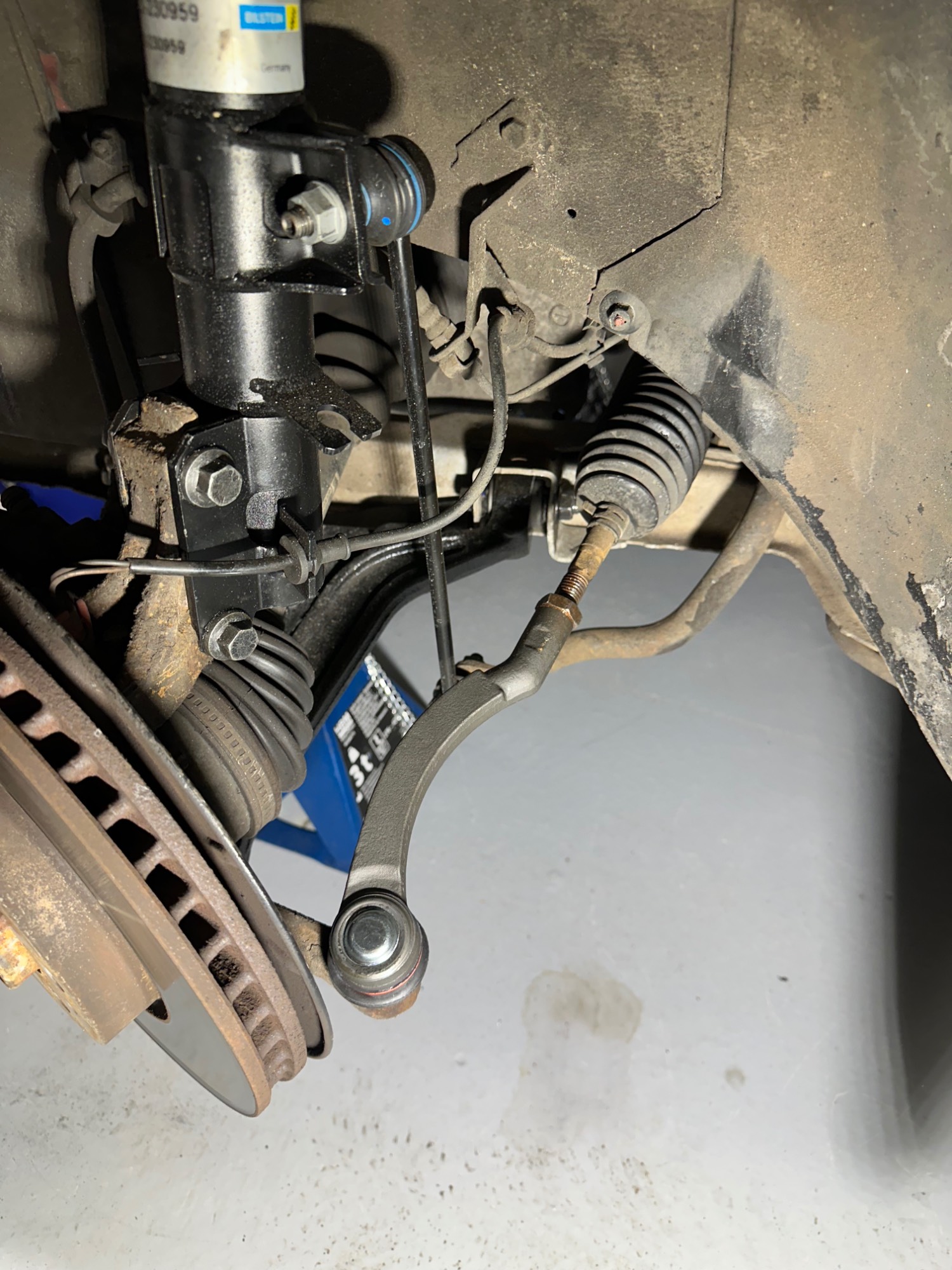

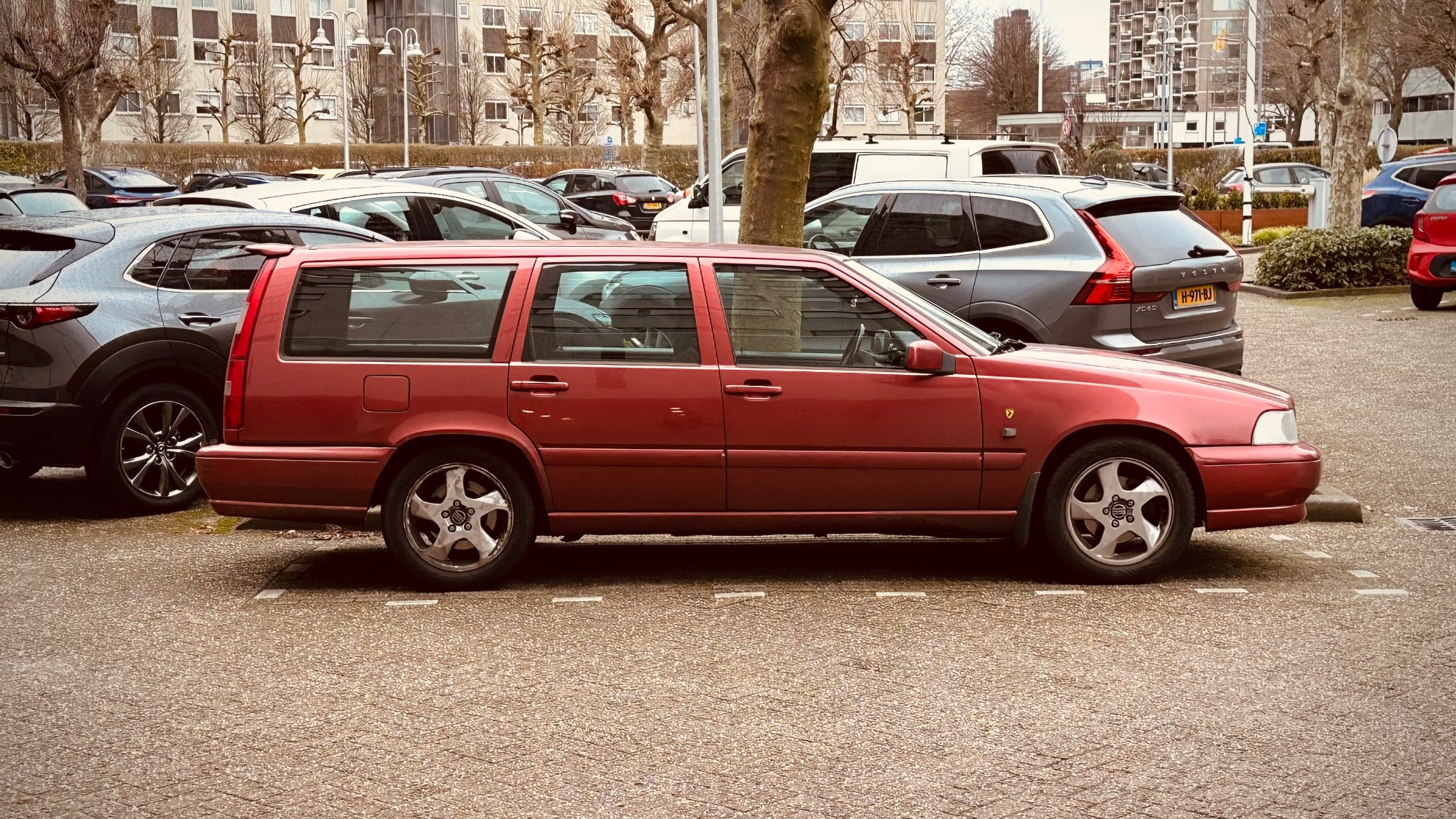

Finished the whole suspension before the end of new year.
I was able to loosen the jam but of the outer tie rods with my newly arrived crows foot wrenches. The threads were pre soaked in pb blaster and lotsa heat.
So outer tie rods are done!
Its not aligned yet, but it drives like a dream. The new delta link bushings made the most difference, even with new shock and springs.
So far in 2025 I’ve done the following on this cosmetically ugly v70:
- new battery
- repaired abs module
- replaced whole pcv system
- new spark plugs
- new throttle cable
- new hood release cable
- automatic gearbox lever lights
- new bits and pieces for the interior
- replaced the whole ac system plus heater core
- replaced blinkers and head light glass
- installed fog lights
- added leds into the dashboard
- new used tweeters up front
- new used blower motor
- replaced new light bulbs for the dashboard switches
- did a full oil, fluid and filter services (except brakes)
- new used drivers side lock actuator
- new used drivers side broken door stop
- new used right hand upper tail light
- new floor mats
- repaired broken cup holder
- new used interieur temp sensor
- new drivers side window control module
- new rear pump windscreen washer
- fixed the rattling interior of the tailgate
- replaced strut, shocks and springs front and back with new assembly on lowered springs
- new cv joint boot right side
- new control arms
- new outer tie rods
- new stabiliser end links
- new delta links
- new trailing arm bushings
- new tailgate lift struts
- all new bulbs in the rear
Next year will be:
- brakes and parking brake
- vacuum lines
- coolant hoses
- transmission mount
- upper engine mount
- valve stem seals
- rust on roof at antenna
- roof liner
- cruise control that doesn’t engage properly
- new used wheels or refurb old ones. Paint inside is flaking off
Exterior wise I’ll leave as is, with the exception of bad rust. The body work and paint is real bad, but I like it. Gives me one less thing to worry about when parking and everything.
Once this engine goes, I might be tempted to swap a t3 and a manual in it for the sleeper car look. Maybe prep a it for Nurburgring as well.
So far I’ve overpaid for the car, which was 1650 euros.
For parts, I’ve spend a grand total of 3757,09 euros, which brings the total of this ongoing hobby to a whopping 5407,09 euros.
My estimate is that till now, I have saved at least 5 to 6000 euros on labor by doing this myself.

Well from 10m the car looks pretty good to me! Just think, no car payments, little depreciation and when you have done all the catch up service work, good for another 100kkm with normal servicing.

Sounds like you got a whole new car to me. Very nice color. Im on my own restoration journey.

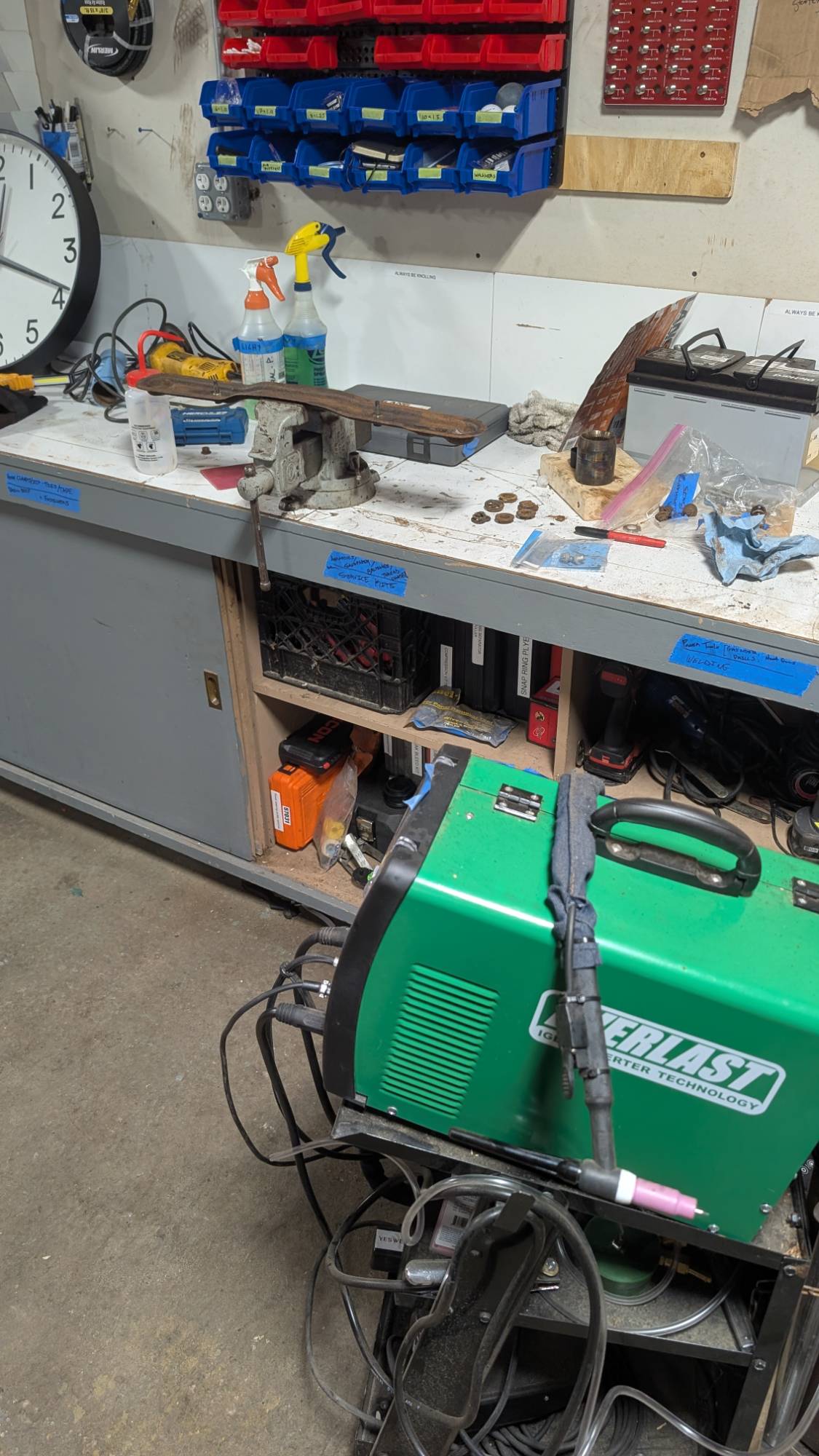

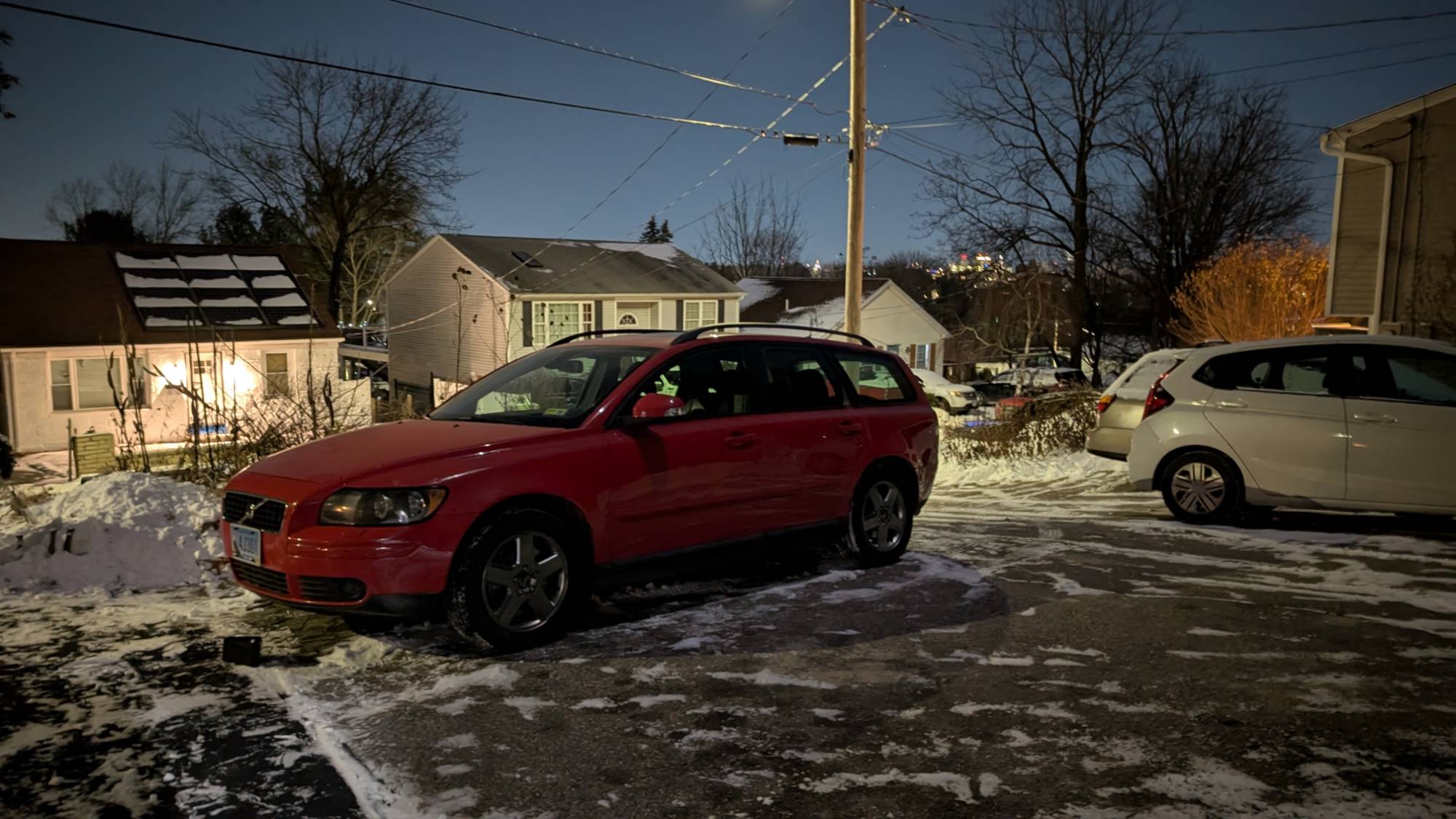

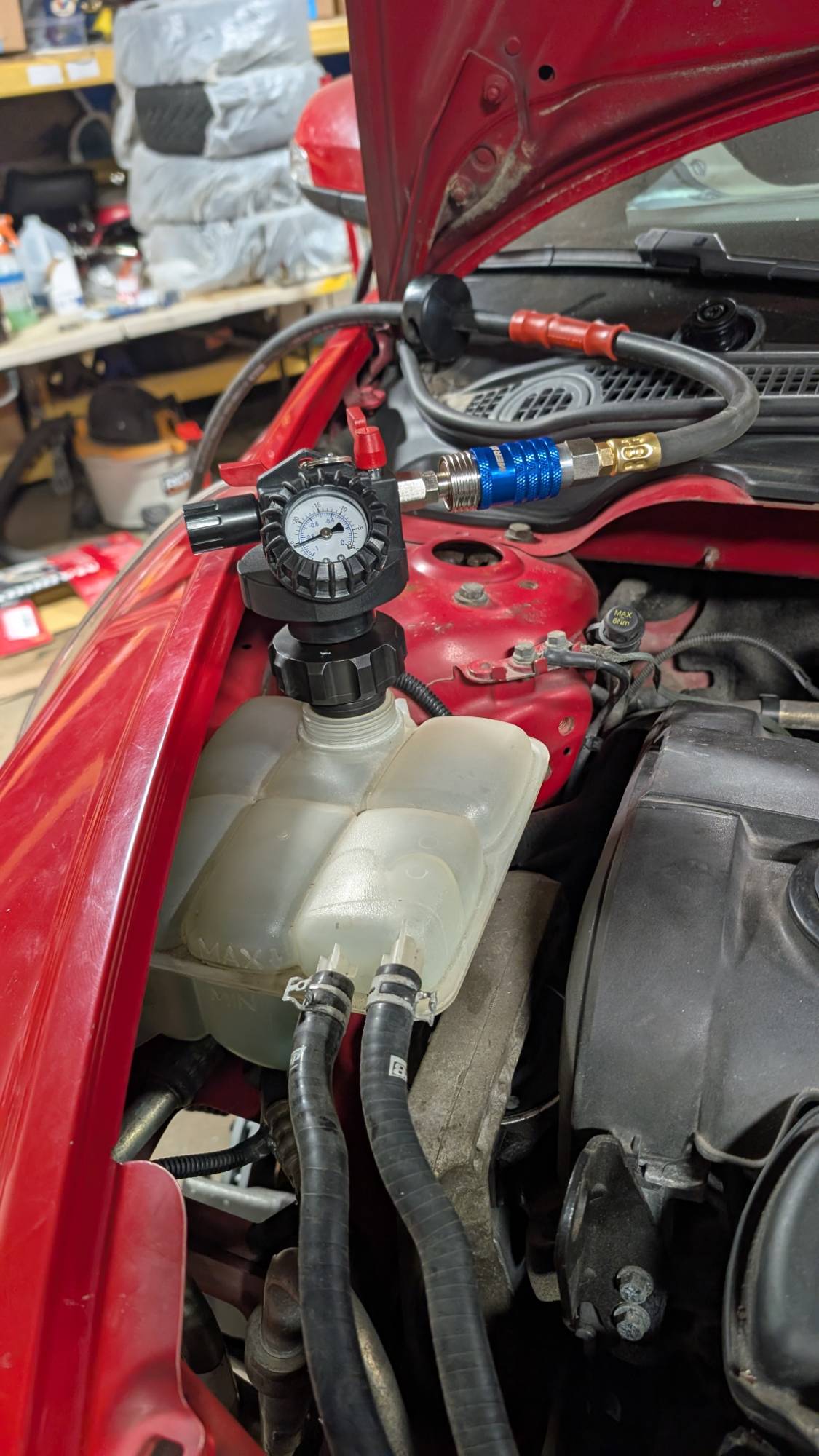

V50 reassembled and made it back in the driveway, I'll pull it back into my shop this weekend since it has a few lingering issues to button up.
Big job generally though so pretty proud of it starting up first try- engine swap with a 100k motor from Erie Volvo. I did a full timing kit including all front and rear seals, serpentine tensioners, pcv system, coolant system refresh and motor mounts. Transmission refresh with flywheel+clutch+pressure plate, all seals including on the angle gear, AWD collar sleeve, drain/fill/filter for rear haldex and dif.
Only hit a few roadblocks having to drill out some snapped bolts on the belly of the car as well as grind down and weld new captive nuts for one of the rear driveshaft brackets. Plus I bent the power steering line dropping the engine back in but thankfully fcp had it 50% off and shipped it to my house in 1 day on new years eve.
I've learned that working on an AWD turbo P1 vs my old fwd NA P80 i should expect everything to take 2-3x longer because of tight packaging and added complexity.

The authorities have been notified. I sure like seeing you in a shop vs thst clutch job outside in New England winter smacnabb

Is that a vacuum filler for the coolant? If so, what exactly is it, and are you happy with it? That's something that I've contemplated buying.
