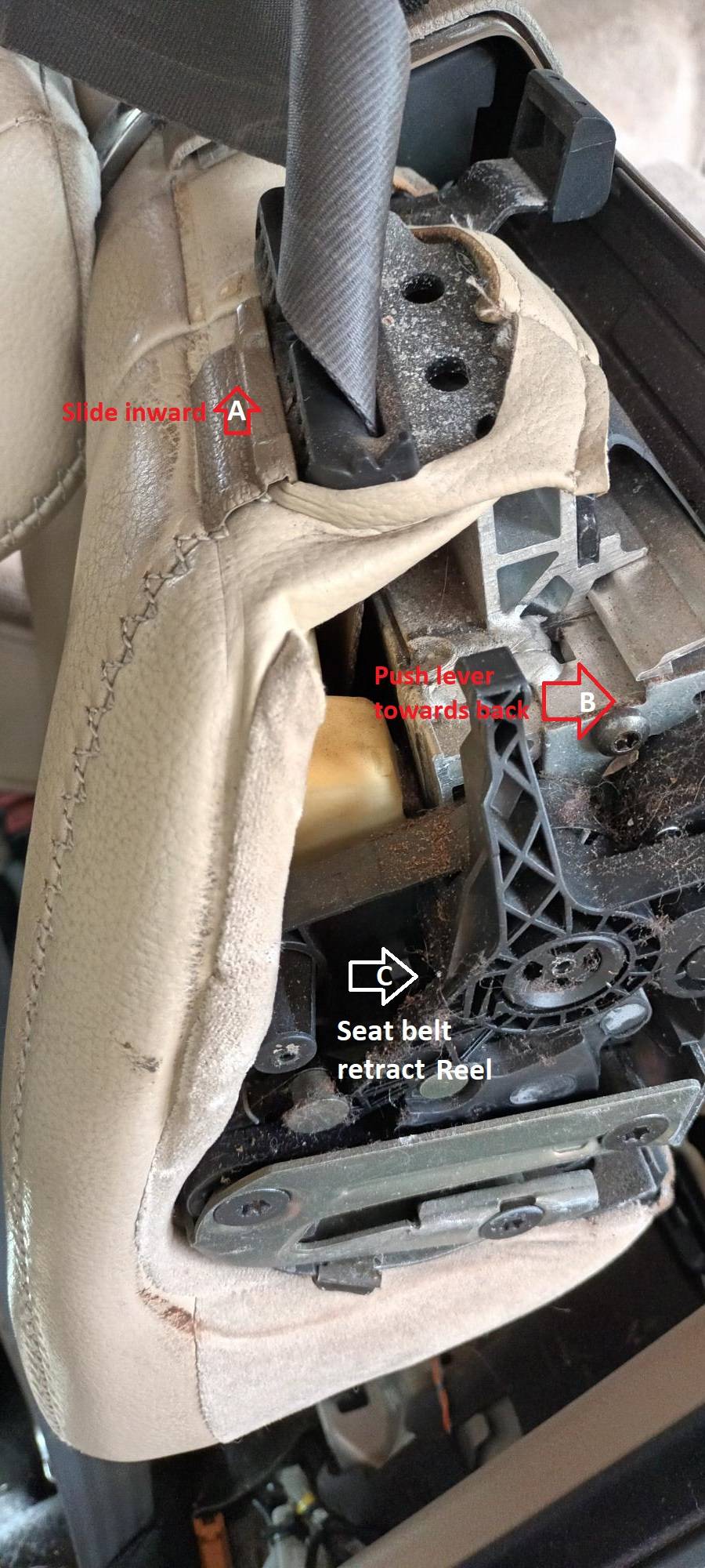

Rear seatbelts loose their retractable-ness and get jammed in the doors. Removal of the reel which is located inside the seatback. Removing the plastic covers slide trim (A) inwards or it lifts upward then the cover slides outward, it may also stick to the leather in places.
Incase like me you accidently latch the seatback trying to un-reel the seatbelt, you need to push (B) lever while lifting the plastic cover.
**BEST** to avoid latching the seatback while the cover is partially removed by removing the seat belt anchor bolt.
Seatbelt is hidden (C) inside cushion its a 15mm nut, all other bolts are 14mm
Very hard to remove trim inserts (pull them up) there must be a trick to releasing them?

Please identify your year and model. This looks like P2, but I am not sure.darylrobert wrote: 27 Dec 2025, 06:18 Rear seatbelts loose their retractable-ness and get jammed in the doors. Removal of the reel which is located inside the seatback. Removing the plastic covers slide trim (A) inwards or it lifts upward then the cover slides outward, it may also stick to the leather in places.
