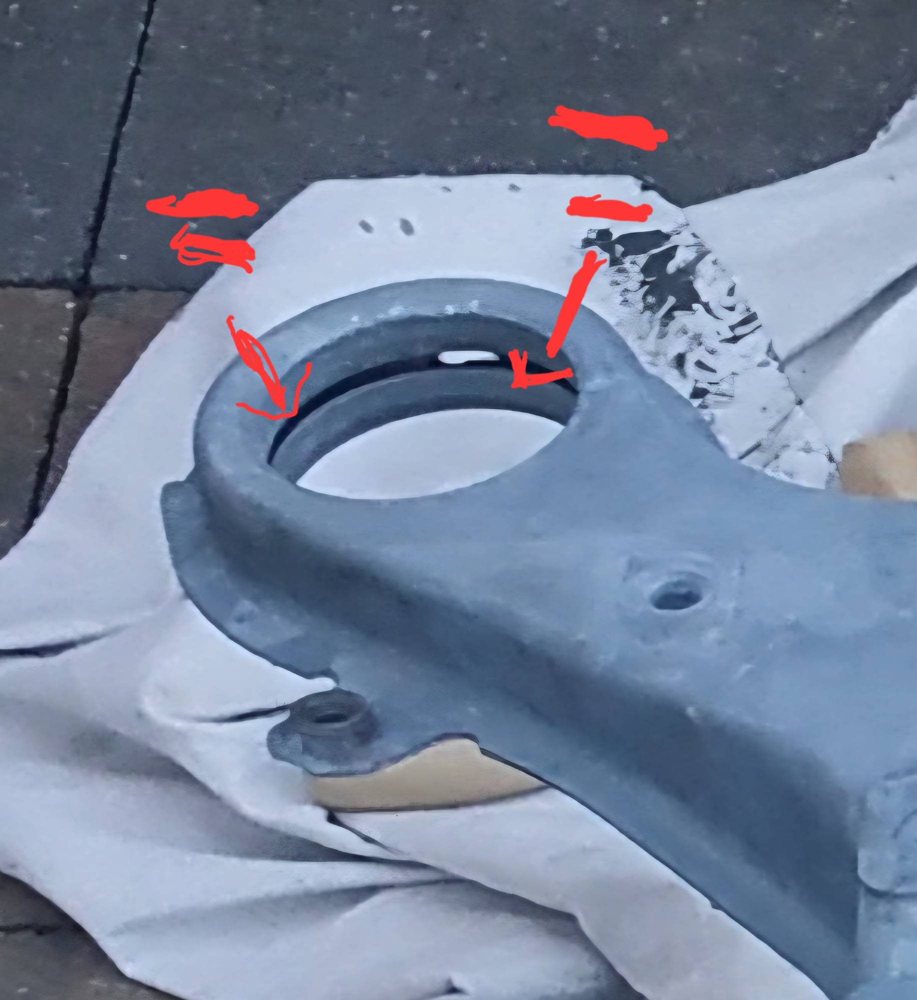

Getting to my issue - I think i completely ruined my front subframe bushing holes.
I used the 3D printable subframe bushing tool that some generous member of this forum uploaded, in combination with a wheel bearing kit and a threaded rod with nuts and washers.
Left bushing is pressed in but looks very slightly crooked looking at it from the top, it doesnt stand out evenly meanwhile its completely seated flush looking at it from below. I am fearing i created so much pressure by hand tools i bent in the lower portion of the subframe bush hole. For the other side, i dont have the bushing in yet. The one i tried to put in cracked in the installation process.
I tried visualizing it in the photo i attached. The "gap" between the upper and lower portion in the hole isn´t spread evenly anymore, its a small gap in the front, while the rear is a much bigger gap.
Looking at it from below it very much looks like the front part got bent in.
I´m now at the point where i don´t know what to do anymore. I kinda feel this is damaged beyond repair. My only options are getting the bushing in, reassembling everything and see what happens or having to replace the entire subframe i guess.
Any opinions?

Welcome to MVS, lobsterclaws. Can you upload several close-up photos from different angles? Take the photos from a close distance to the subframe.

Well, break it down to what you can and cant do. A tow without a subframe will probably more complicated then towing it with a subframe. Waiting for a subframe/sourcing one may take some time right? Also, if the bushing compresses against the frame then that pressure will likely put it all flush/be a non issue.

My gut feeling is the uneven gap in that opening is not that critical. The subframe is built from two shells welded together top and bottom. The gap in that opening may just be part of the assembly process, I don’t know.
I damaged mine by pushing the bushings in poorly aligned. The bushing caught that lip at the gap and actually split the steel.
That episode is in this thread I think -
viewtopic.php?p=666689&hilit=Subframe+bushings#p666689
When the bushings are seated all the way in, they and that gap are clamped with big honker bolts.

Need some better pictures but it really doesn't look like anything to worry about. If your super fussy you could get a pry in and make that gap uniform, it may be malleable enough being mild steel. you would be better off installing the bushings in situ at this point using a bolt and washer and the existing threaded hole as a press, I'll include a post that I did on this job for reference.viewtopic.php?p=563260#p563260

But as the others said, the top part is not suuuuper critical to be straight, the lower part holds and aligns the bushing.

I got a new bushing in the mail today and went for it again and got it properly seated. The bushing looked seated flush after pressing in so I think I don't have to worry about the slight deformation, maybe it came back down a little in the pressing process.
