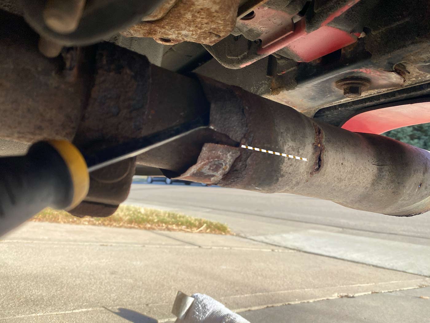

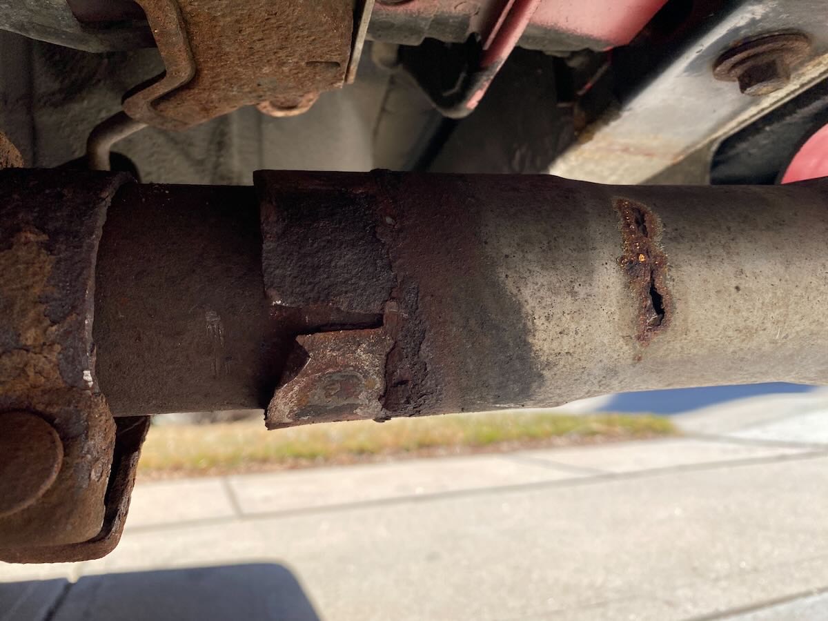

The clamp came off after a day of drinking PB Blaster, but now the tip is stuck and seems to be fused to the exhaust pipe.
I hit it with more PBB and will bang away again tomorrow, but I think I'll end up using a grinder to cut a line (dotted line) to where the tip tapers.
Any thoughts?

My suggestions in order of ease:
Cutoff wheel slitting.
Air hammer chisel.
Manual hammer and chisel.
It;s a rusty tail pipe. Why save it?
Air hammer chisel.

VLN, I'm not trying to save it, just get it off the tailpipe.

I bought a $20 air chisel a while back…fantastic tool.

Air chisels are useful. Best use I've seen so far was my buddy using it to shock loose the O2 sensors on an 02 XC70. Worked like a charm (but I had soaked them a week previously with PB Blaster).
However, in this case I would be using either a Dremel or a grinder with cut off wheel carefully.

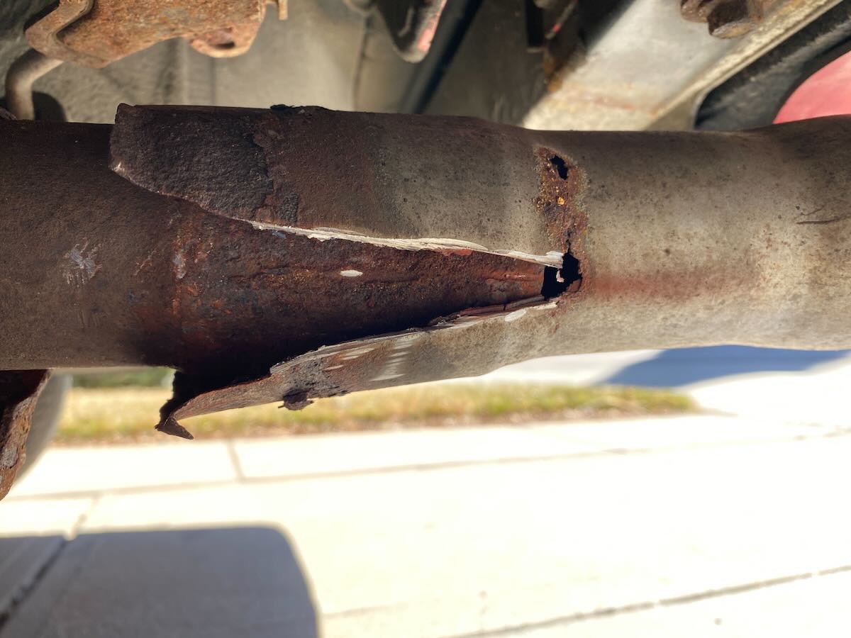

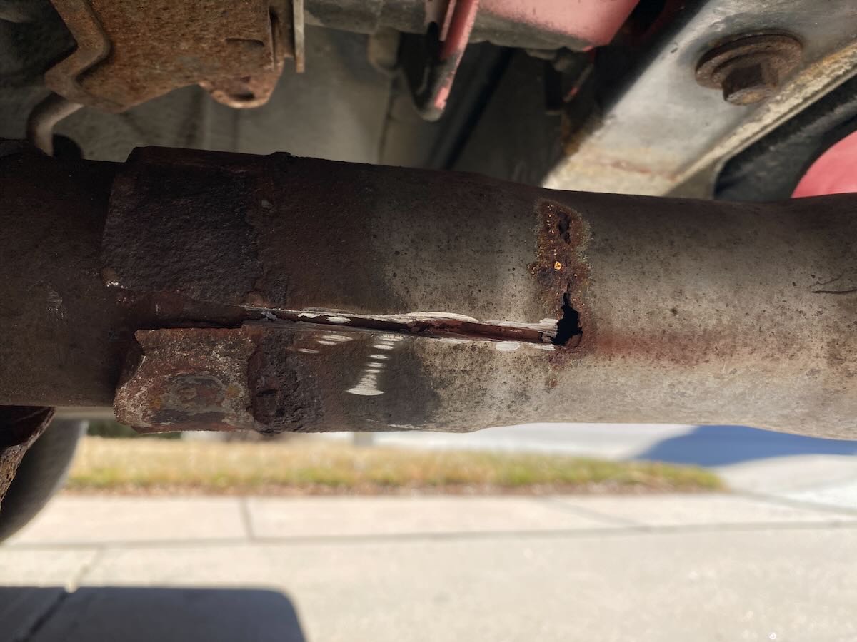

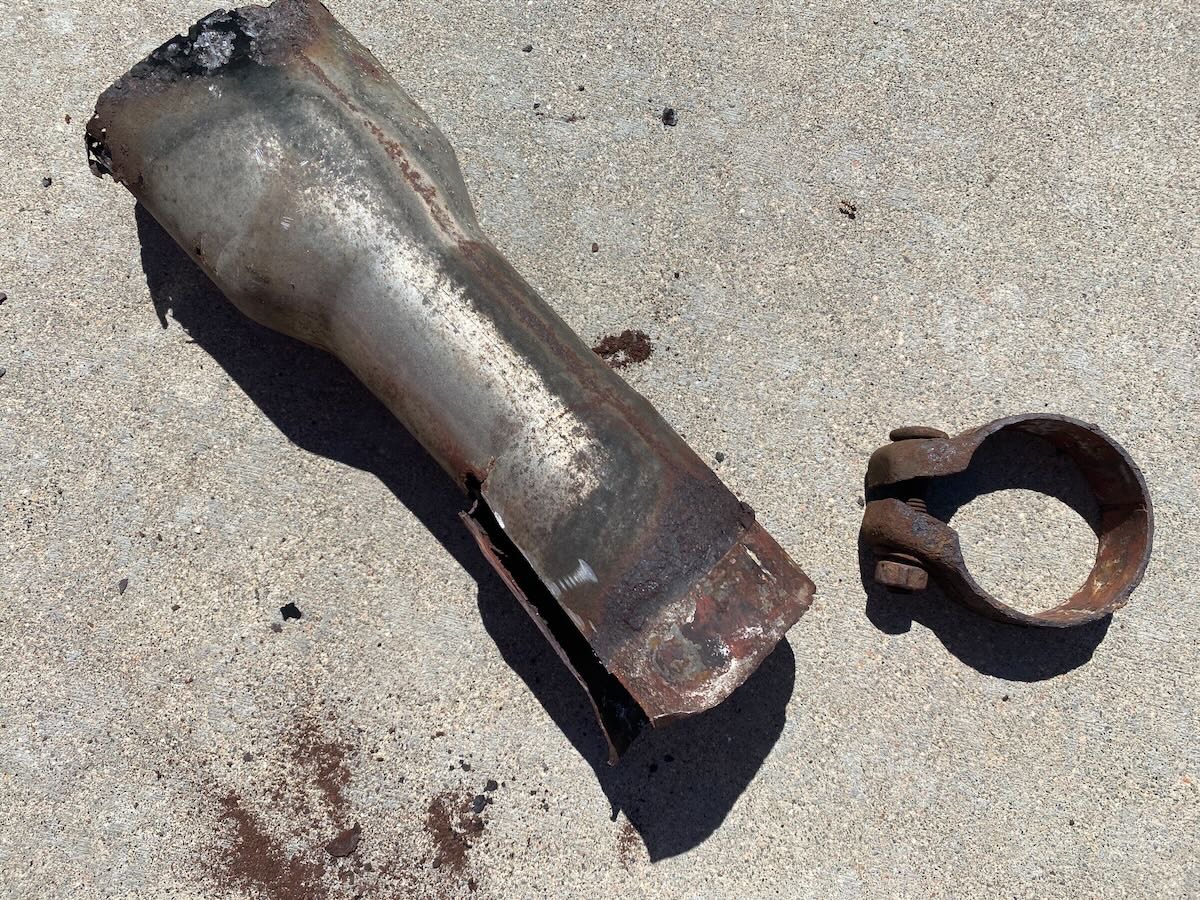

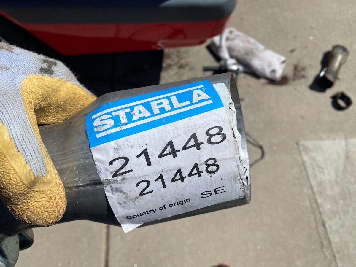

Done. Grinding took all of 45 seconds. Thanks to everyone for their help. Starla 21448 replacement.

Where did you find that? FCP says backorder. I did find one on ebay, but it was $50.
Mine is more like this Ansa https://www.ebay.com/itm/354638023321
Looking on IPD, it seems the style you have is either for a turbo, or wagon.
