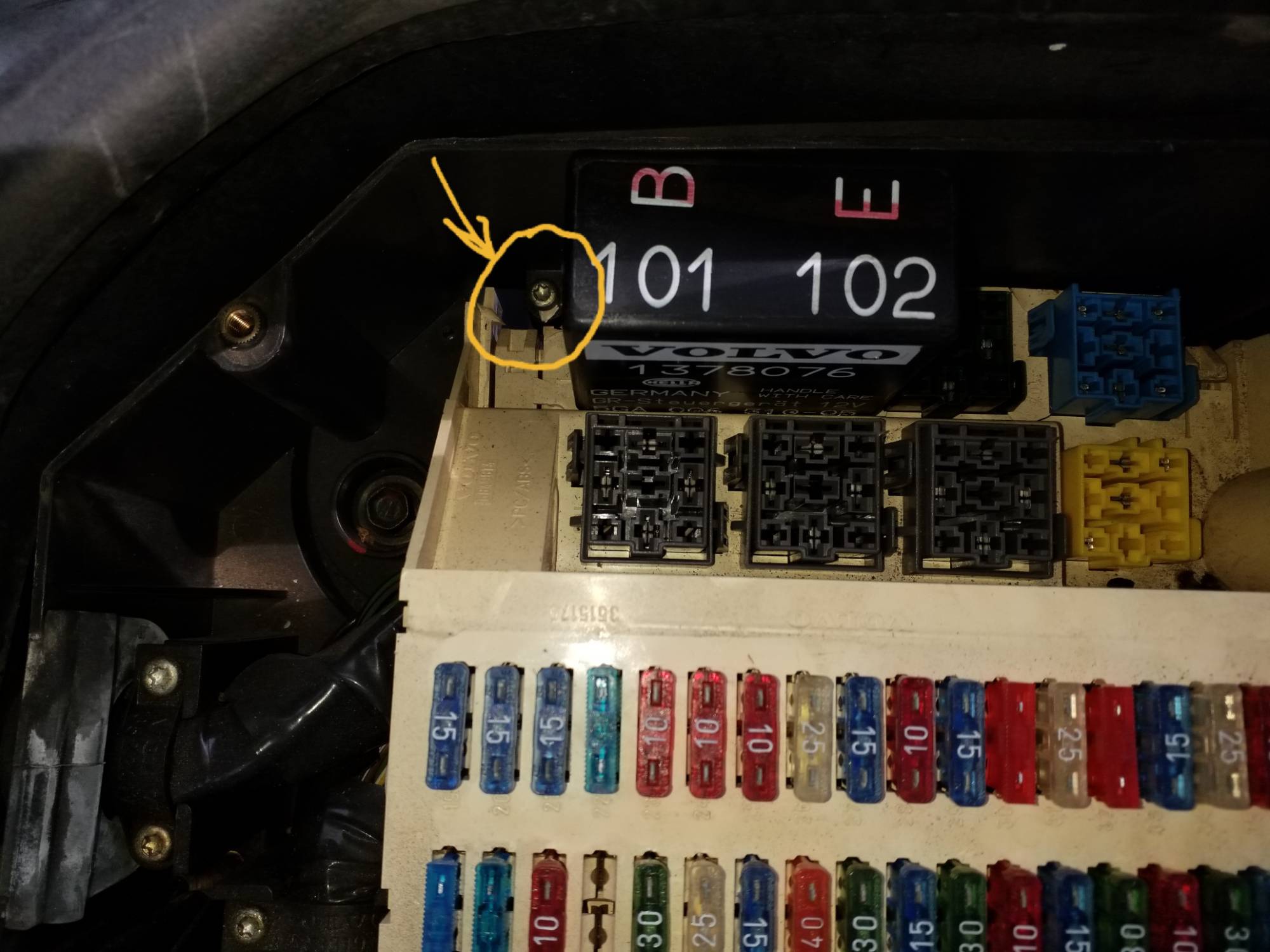

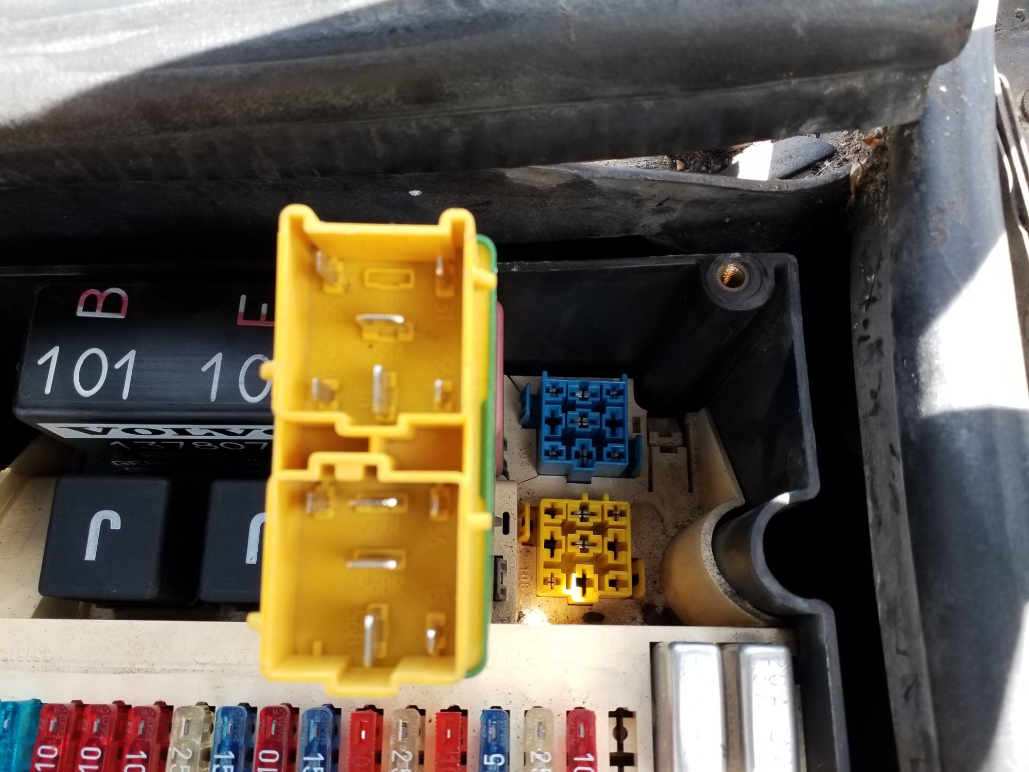

How many times have I been here now saying 'I was wrong' and 'that's not what it was'? But yeah the two J relays wasn't it. I'm not going to say anything more until I buy the correct light control relay. This one isn't for an older 850 but maybe for a 97+. That seems to be causing some sort of short in everything. Doesn't have all the pins. 1995 was a complicated year I guess. Actually this electronic stuff is too intertwined. Seems simple enough until you attempt to track down a strange electrical issue.
One picture show light control relay pin connections on male and female ends. I must have the incorrect one. I tried the same pin-out light control relay from my 98 v70. Same buzz/short issue.
The other picture shows cracks in the fusebox. It was like that when I removed that cover for the first time when I started all this.

I suspect this: https://www.fcpeuro.com/products/volvo- ... 60-9447803
Do you have a spare you can swap in to test?
