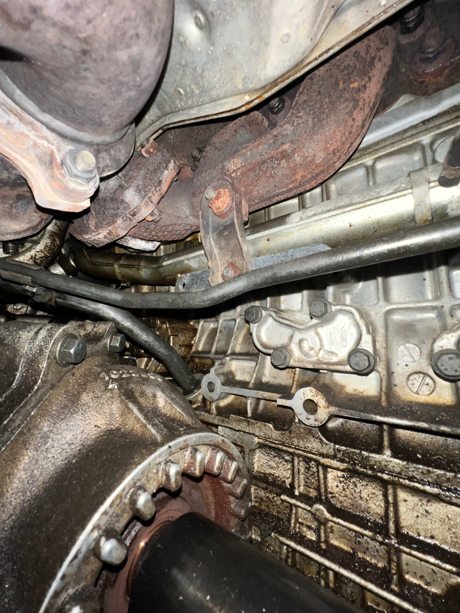

I discovered a curious oil leak from Saskia today. When putting her up on ramps to check for the source of the oil drops that had landed in the drip pan (with fresh absorbent material), a medium-ish leak started to drip oil. Yet when driving off the ramps and remaining on level ground, the only oil dripping was residual.
At 178K miles and recently did an oil change, which didn’t have the leak even when up on ramps, so it’s a recent development.
It appears there’s two leak locations needing to be identified (my leaking oil pan drain plug I’m aware of and am trying to figure out how to remedy).
Overall view of the mess :(
The first leak seems to be coming from nearby the turbocharger on the left side of the car, and is the dominant one that made itself known when Saskia was on the ramps.
The other looks to be coming from the right by the black fuel and evap lines that go over to the top of the engine, as well as the fuel pressure regulator and other things on the right side of the car. (Also noting that the oil cooler lines attaching to the radiator need new o-rings and clips.)
My main focus is the leak that comes out when on a frontal incline. The other two (drain plug and right side leak) I would also be appreciated having input on.

That looks like a cam seal exhaust side leak . I don’t think your 1998 xc70 has VVT so that’s an easy fix
The rear of the engine looks like the turbo drain o ring didn’t seat right. I chased that leak for three years

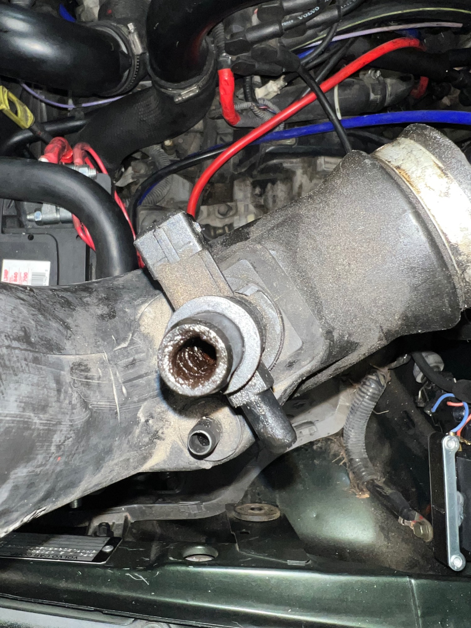

Onto discoveries… did the glove test, and it did have some slight inflation that increased with small revs. Grr
Also noted a fair bit of oil from the PCV line that connects to the air intake right before the turbo inlet
I also noted that there was oil on the outside of the two tubes that come from the catch can by the intake manifold. Not entirely sure what to make of that, other than that there’s an issue there
Tried to get a view of the catch can, front of the engine under the intake manifold looks okay
After pulling out the air intake pipe and shifting some hoses around, I believe I found the culprit (as I see abscate just mentioned). It does indeed appear to be the exhaust camshaft seal on the driver’s side behind the camshaft position sensor. There was a lot of oil that was on the lower screw and the bracket that helps guide the evap, SAS check valve, and turbo hoses
That’s good to know. From feel it seemed okay and earlier photos seem to not show too much of a mess, but I’ll get under there a different day and check on that

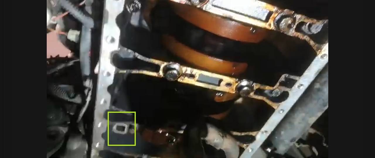

If you have glove test (ballooning) and rear cam seal leaking & PCV job done. Most likely same thing that I have to fix soon based on a local volvo mechanic. Not sure what it is called. It is part of PCV. The oil trap box connect to the engine block. oil from the trap box is draining down from the block to oil pan (square hole) in the attached pictures.
I am still trying to figure out if I should drop the pan and open that blockage or find something to poke through. Not far from out side, but it appears to go down more than a few inches.
There is a youtube video:
I've done the PCV twice without knowing about the blockage. Still have parts that I took out last time and they are all clear without any kind of blockage.

I stumbled across another thread discussing the oil pan in relation to PCV issues, and apparently there's some sort of screen in the oil pan that can get fouled up. At some point when time and money allows I'll get to dropping the oil pan to replace the seals and clean things out (also have to figure how many of each length of bolt to order to replace the old ones that seem like they're going to be very troublesome).
