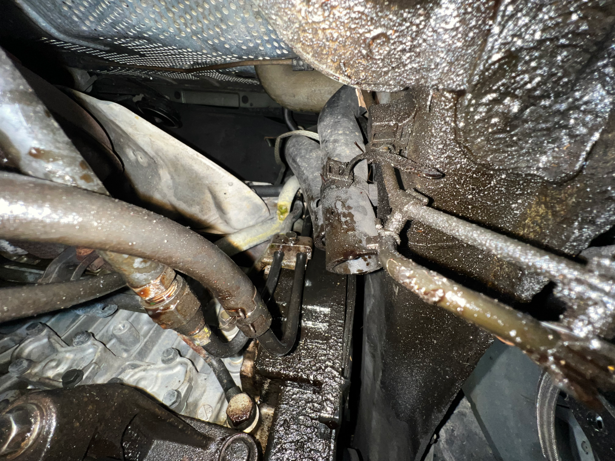

Oily turbo
Crankshaft, A/C compressor, and water pump(?)
A bit of the mess caused by the leaking oil return gasket and o-ring failing
Oil return line on the AWD models... rather tricky
