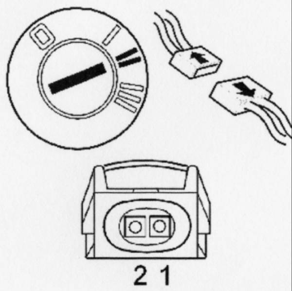

HI, i have a 93 940 N/A wagon, the first time i took it to get tested it failed on Nox @ 1300 ppm. The cat is new so i pulled the codes and it came up as being the O2 sensor so i replaced that. the seconed time around on the test it failed again @ 1052 ppm on Nox. the only two codes i get now are 122 and 221 on socket 2. ive cheaked the and replaced the AMM and the ICV and got no changes. Any thoughts?

1-2-2 is Intake Air Temperature sensor signal missing or defective.
Possible causes are: A short circuit to earth (ground) in the cable, connectors or sensors.
Contact resistance in the terminals.
Poor earth (ground) for the signal earth.
Check all the earth contacts around the MAF and IAT and check the terminal contacts for corrosion/oxidization. Also, whilst you are busy at the plug test for voltage between terminal 1 and earth. Switch ignition on, disconnect the plug and connect a voltmeter between terminal 1 and earth. Reading should be approximately 5 volts.
