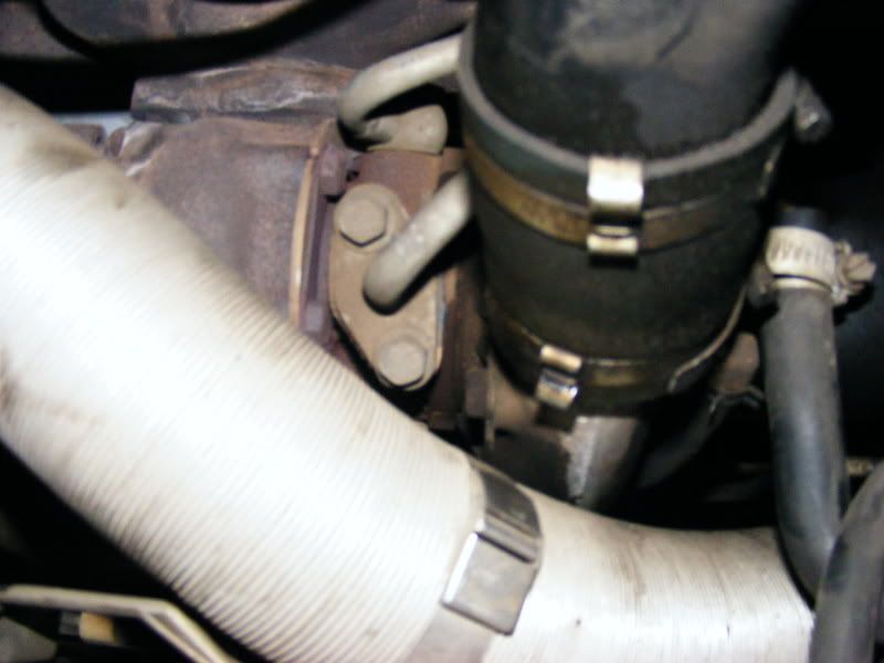

I Seem to be having a hard time figuring out which turbo our car is equipped with ( mitsu ) or ( Garret )
i found some numbers stamped into the turbo air output spout just Below where the intercooler hose comes off the turbo.
they were 09115 95
Here is the Best top view photo i could get since it is very cold outside here in Edmonton Alberta Canada right now!
I hope somebody knows !

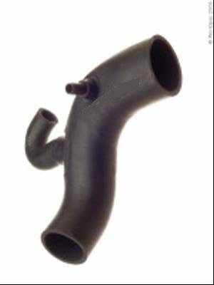

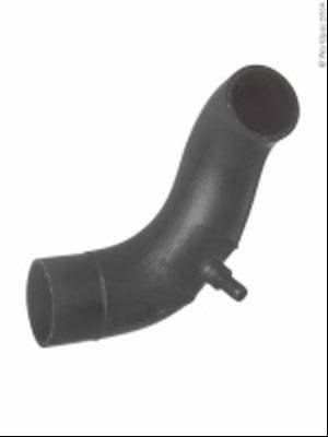

The turbo air intake hoses are slightly different.
Mitsubishi:
760 Turbo hose Mitsubishi.jpg (8.34 KiB) Viewed 492 times
Garrett:
760 Turbo hose Garrett.jpg (9.14 KiB) Viewed 492 times
