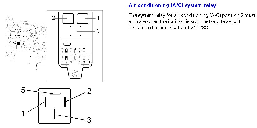

There are #11 (11A and 11B) relays that control the climate control unit. One is found in the relay box, just below and to the left of your steering wheel and the other in the large relay box under you hood (up near the windshield on the driver's side). You can check the ohms between two pins in socket for your relay in the cabin by following the instructions below:
S40 Relay Check.jpg (39.66 KiB) Viewed 1382 times
However, your system is very sophisticated and stores Volvo specific codes that will pin point the exact problem with your system. I looked through VADIS and to problem shoot your system, it might take me a whole day and still I might not have found the problem. Let me suggest that you go ahead and take your car to a dealer you trust and who's reputable or an independent shop that has the VIDA equipment to read your codes. Unless there is more information to go on, it is going to be very difficult for me to give you enough direction to really be of much help.
