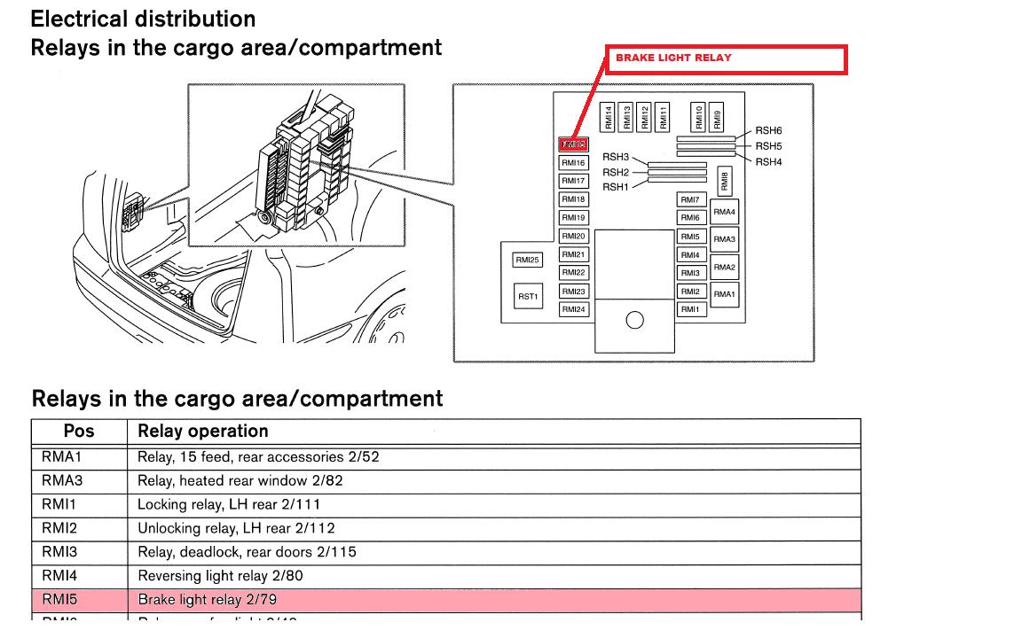

replaced lamps stilldo not lite up only the top rear window lites when you step on the brakes

yes checked fuses in trunk do you koww the location of the brake module or relay ?

The third brake light is fed separately by the Central Electronic Module because they are LEDs. The lights in the fenders are fed by the relay shown in the picture below:
