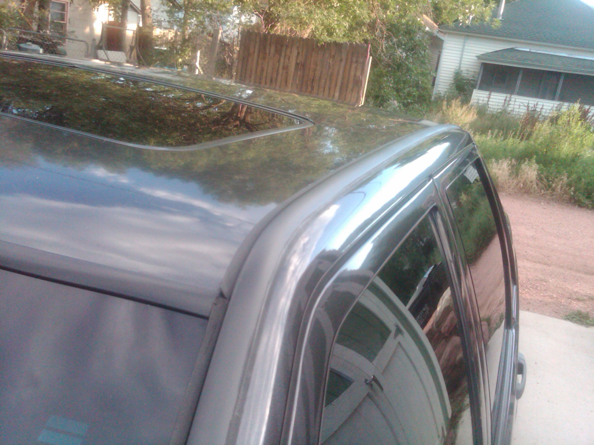

This may be the cleanest & cheapest solution. I used 2 layers of duct tape starting along the rubber gasket edges and masked the painted roof on both sides of the drip rails about 4 inches wide. Then I cut away the peeling finish using an aluminum straight edge (yardstick) and a razor knife carefully avoiding the rubber gasket. After that I just used a 120 grit sandpaper to remove all the glue and then finished off with a 400 grit sandpaper to give the bare aluminum a brushed effect. Honestly it looks pretty damn good.

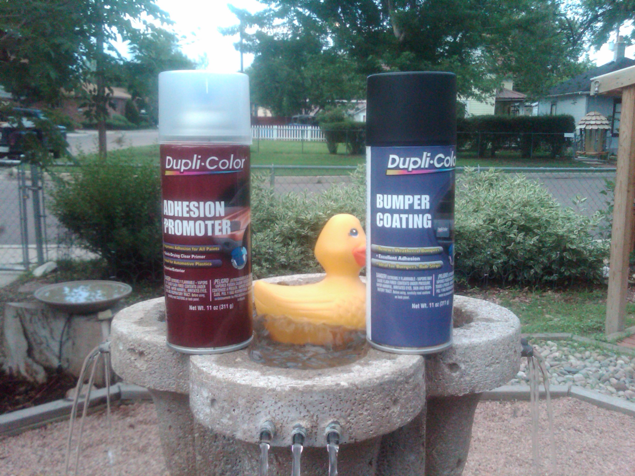

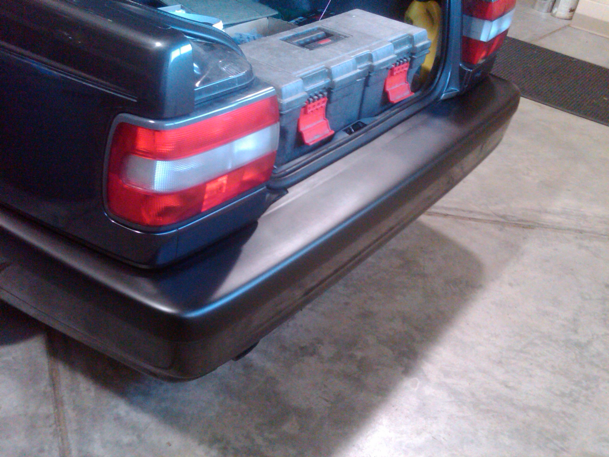

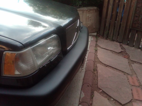

I put mine off long enough. I finished doing the bumpers today using Adhesion Promoter and Bumper Coating and it looks great. More of a mat look than glossy. Made by Dupli-Color and available in all the auto supply stores. It was easy to do the bumpers right on the car. I am wondering if I can do a good job with the roof strips on the car as well. Messing with clips and anything plastic on an old car is trouble. It all breaks. Leave it alone if possible seems to be the rule.

I did both my bumpers and the roof strips with the same products. Roof strips came off real easy. One strip, all the plastic coating had peeled away. The other strip was a pain. Nothing had peeled and I had to use a razor knife to whittle it all off. Thought about using a heat gun but was afraid of results to the rubber edging. Sanded the metal down with 400 paper.
