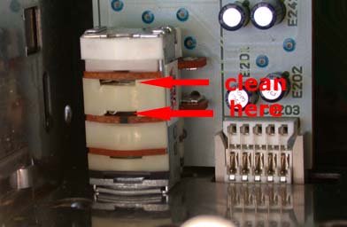

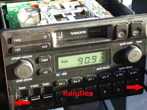

I had the same problem: Changing the volume created a nasty crackling sound and even drop outs in the right channel. So I pulled out the radio (push in the 2 vertical "bars" on the lower left and right of the faceplate, handles will pop out, then just pull) and removed the top cover (couple of screws).
Look inside and you see the potentiometer.
It has little openings through which you can see the slider move when you turn the knob. The crackle is caused by dirt under the slider. That's where you should try to clean.

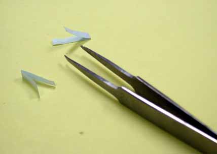

I successfully used tweezers with a little piece of strong paper soaked with IPA (alcohol). (Just squirting IPA in there and moving the slider did not do much.)
I slid in the paper under the slider and was able to remove some dirt. I repeated this until the paper looked clean. But be carefull not to damage the slider. If it breaks you need a new potentiometer at which point you might look for a replacemnet radio as well.

I did the strip of paper thing by saturating the control with alcohol and inserting the strips in each slot and rotating the control, as it got dirty I just tore the end off and kept doing it until the paper was clean, I then gave it another good spray with the alcohol again and then gave it a really good going over with compressed air, good result. :D :D :D

This procedure worked like a charm on my 850's radio. I used CRC QD Electronic Cleaner spritzed on the paper ends. Thanks for the post!

Did this fix today, sprayed contact cleaner in the sliders and a sliver of paper and rotated full range about 10 times, no more crackling!
