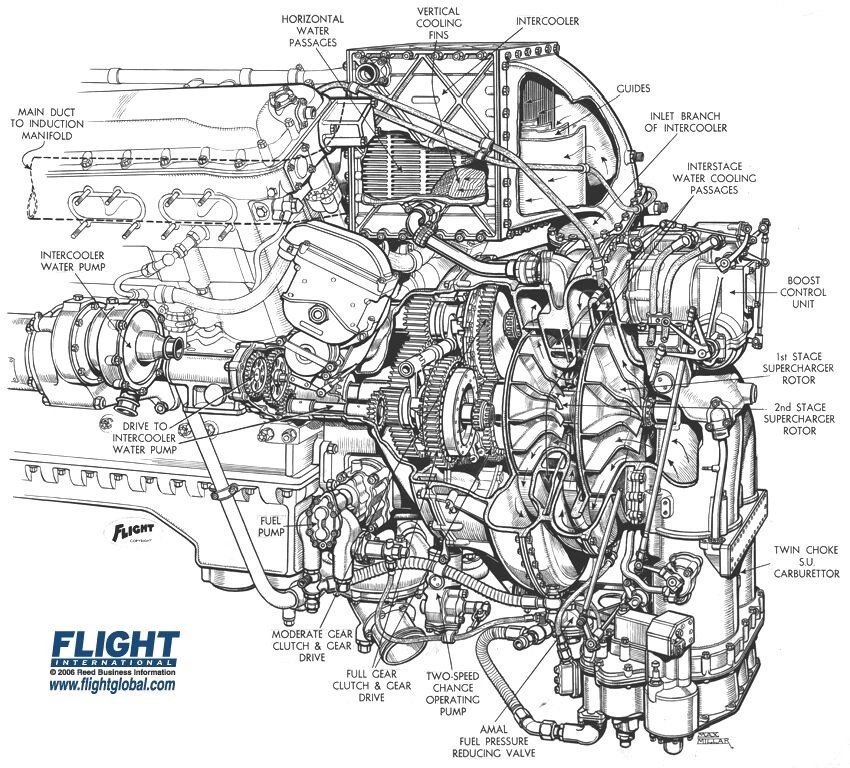

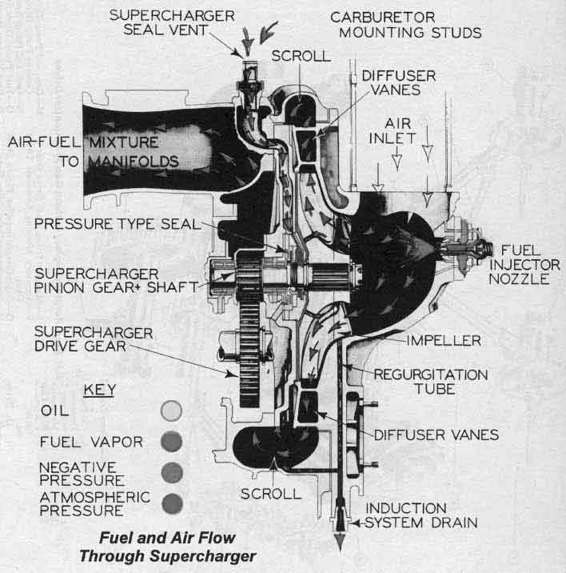

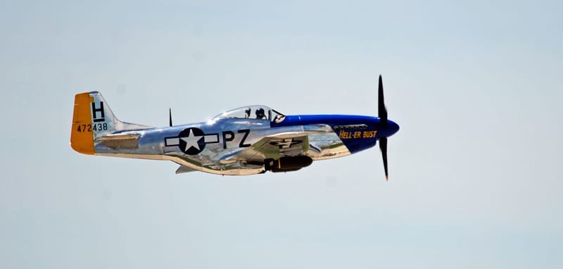

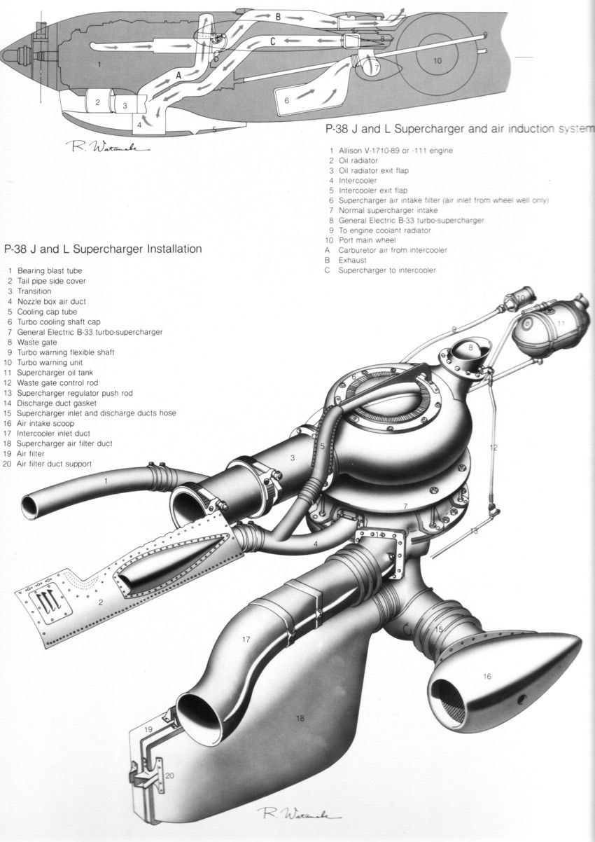

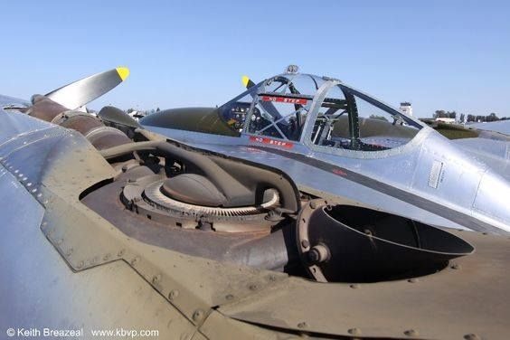

Also - I'm sure they were around before that, but in WWII, various planes added superchargers to make enormous power at high altitude where there's not enough air. Spitfire, P-51, P-38...I'm sure many others.
Rolls Royce Merlin V-12
P-38 with Allison V-12 - A sort of turbocharger supercharger hybrid, behind the engine.
