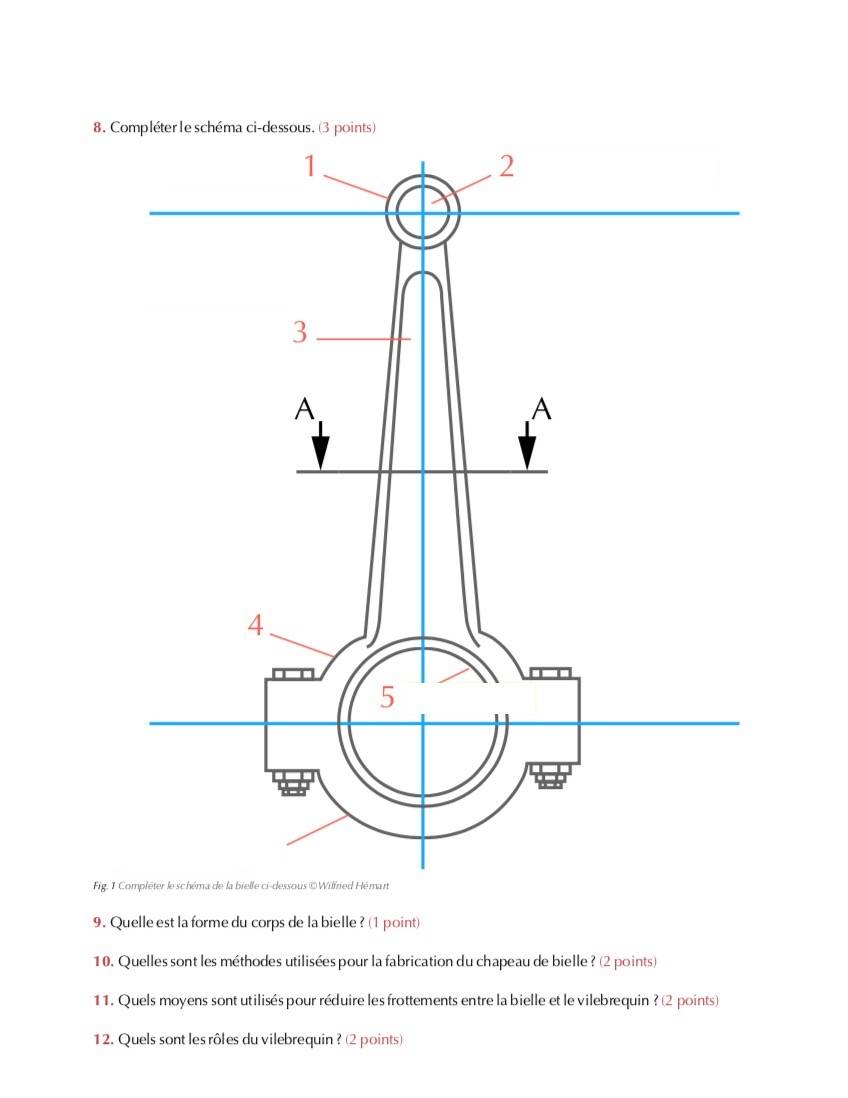

8. Complete the following diagram (2 points)
9. What is the shape of the connecting rod body? (1 point)
10. What methods are used to manufacture the connecting rod cap? (2 points)
11. What means are used to reduce friction between the connecting rod and the crankshaft? (2 points) 12. What are the roles of the crankshaft? (2 points)

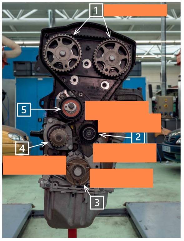

14. What are the methods used for valve timing? (2 points) 15. What is the important point with the timing system? (1 point)
16. Complete the diagram below. (3 points)

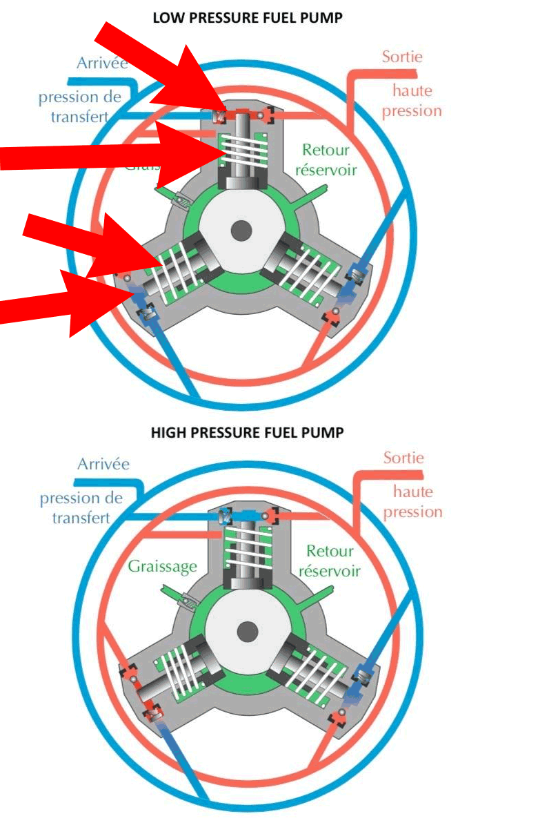

Hy Buddies,
a little question : low and high pressure fuel pump. In my lesson, i've got this picture to show the difference between these 2 fuel pumps; But, to me, there are the same. Does someone could tell me if i'm wrong or right ? And could have more information ?
On the picture, i don't really see the difference...
Thanks.
Manov
Thanks.
Manov

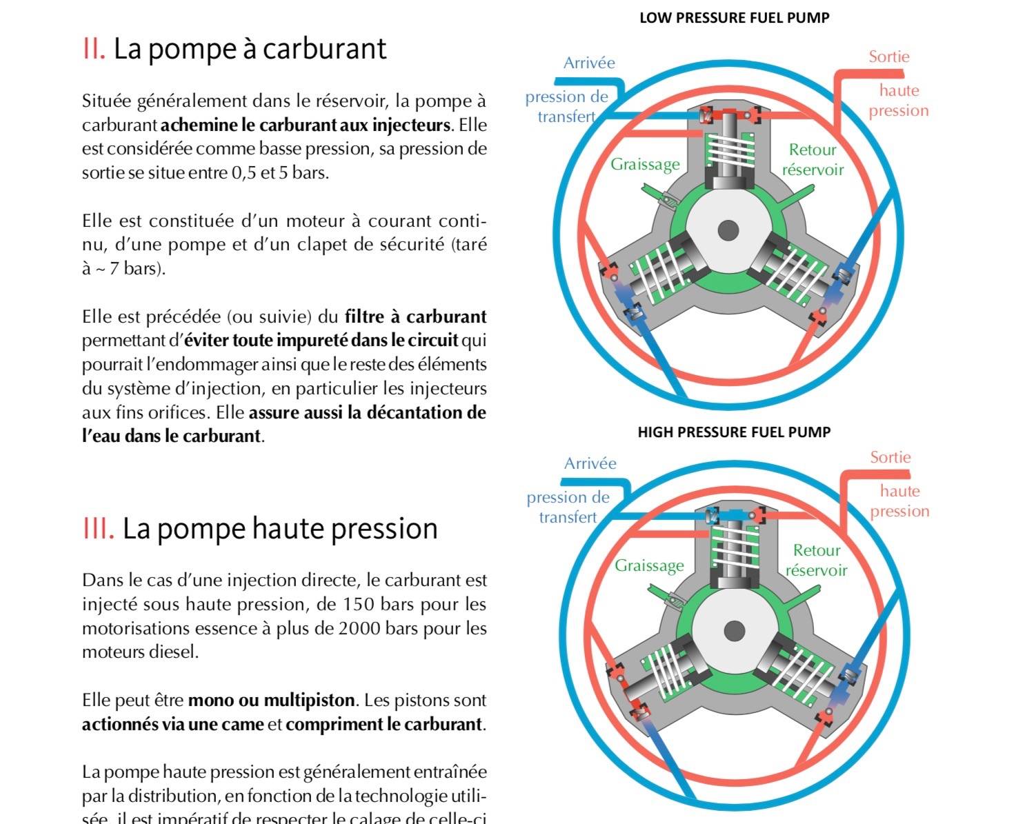

Hello manovlov!
Can you put that text of Part II and Part III through a French -> English translation? https://translate.google.com/
- manovlov
- Posts: 1180
- Joined: 6 July 2011
- Year and Model: 1995 850 GLT 2.5 170
- Location: Grenoble, France
- Has thanked: 620 times
- Been thanked: 143 times
Salut Matt !
Here you are.
II. The fuel pump
Usually located in the tank, the fuel pump delivers fuel to the
fuel to the injectors. It is considered as low pressure, its output pressure is between 0.5 and 5 bars.
It consists of a DC motor, a pump and a safety valve (set at~7bars).
It is preceded (or followed) by the fuel filter which prevents any impurity in the circuit that could damage it and the rest of the elements of the injection system, in particular the injectors with their fine orifices. It also ensures the decantation of water in the fuel.
III. The high pressure pump
In the case of direct injection, the fuel is injected under high pressure, from 150 bars for gasoline engines to over 2000 bars for diesel engines.
It can be single or multi-piston. The pistons are actuated via a cam and compress the fuel.
The high-pressure pump is generally driven by the distribution system. Depending on the technology used, it is imperative to respect the timing of the latter by following the manufacturer's method.
It is equipped with a pressure regulator at the outlet to avoid any overpressure.
The pressurized fuel is either sent directly to the injectors (distributor pump + calibrated mechanical injectors) or to a common rail in which the pressure is accumulated for all the injectors (electrically controlled injectors).
Here you are.
II. The fuel pump

Here are the differences I see:
- Posts: 6234
- Joined: 19 January 2014
- Has thanked: 927 times
- Been thanked: 1000 times
It appears to me the low pressure and high pressure fuel pump drawings are intended to be representative diagrams only. The actual differences will be in the details:
Low pressure pump will have good suction characteristics to pull fuel from the tank. It will also be designed for medium outlet pressure.
The high pressure fuel pump will not need good suction characteristics because the low pressure pump will force fuel into the high pressure pump. It will be designed for high outlet pressure.
All pump designs are a compromise between suction characteristics and outlet pressure capability.
