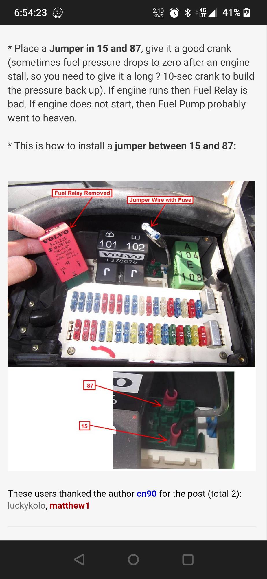

Okay fellas!
I took the fuel pump relay out of the circuit and jumpered these contact points as shown in this photo. #15 and # 87
attachment=0]Screenshot_20220730-185424.jpg[/attachment]
I am running it for a little bit it doesn't seem like there's a lot of improvement and. I would think that something like this would have an immediate effect so it's probably not the fuel pump relay.
